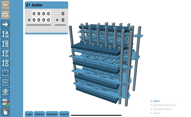

Post by Drass »
Found this link about Konrad Zuse’s Z1 Computer: Architecture and Simulation of the Z1 Computer. It includes an interactive 3D simulation of the adder (pic below), and a informative pdf about the Z1 computer.
