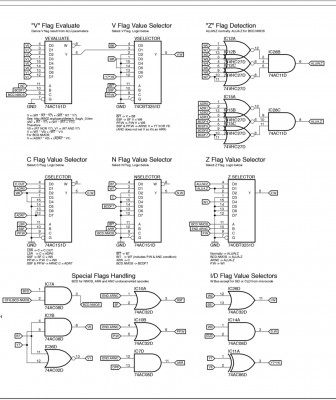

joanlluch wrote:
Thus it also looks to me that just half a cycle for write-back might not be enough time for what's required, and that as Dieter suggests, we might need to allow some incursion onto the second half of the cycle to make this affordable.
Flag evaluation from the C74-6502:
It should fit in a half cycle using CBTLV and NC7SV logic.

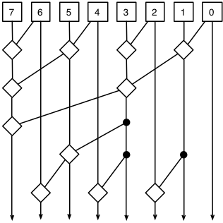

Just came across an interesting one, the Brent-Kung adder circuit, while looking at this TTL simulator in the browser

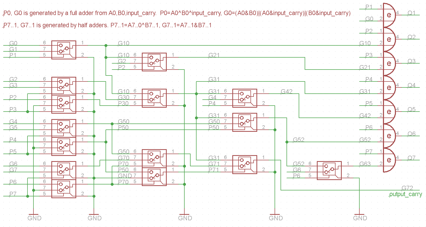

Looks like implementing the Brent-Kung adder >carry chain topology< with FET SPDT pass_through switches won't be too efficient.
Ripple carry adder: carry chain has 8 SPDT switches. Brent-Kung adder: carry chain has 15 SPDT switches.
Also, with the Brent-Kung adder carry chain we would have a select_to_output delay of two switches for the MSB,
with 2.5V powered 74AUC2G53 switches this would be 2.8ns typ.
Haven't checked my wiring above for errors, because I'm not sure if implementing a Brent-Kung adder for our project would be a good idea.
Edit: Q0=P0, that text didn't make it into the schematic when cutting the screenshot to size.

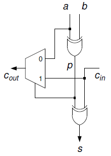

Tricks like in the picture below probably won't bring us far,
because ALU A inputs directly would be feeding the carry chain (piling up capacitances):
