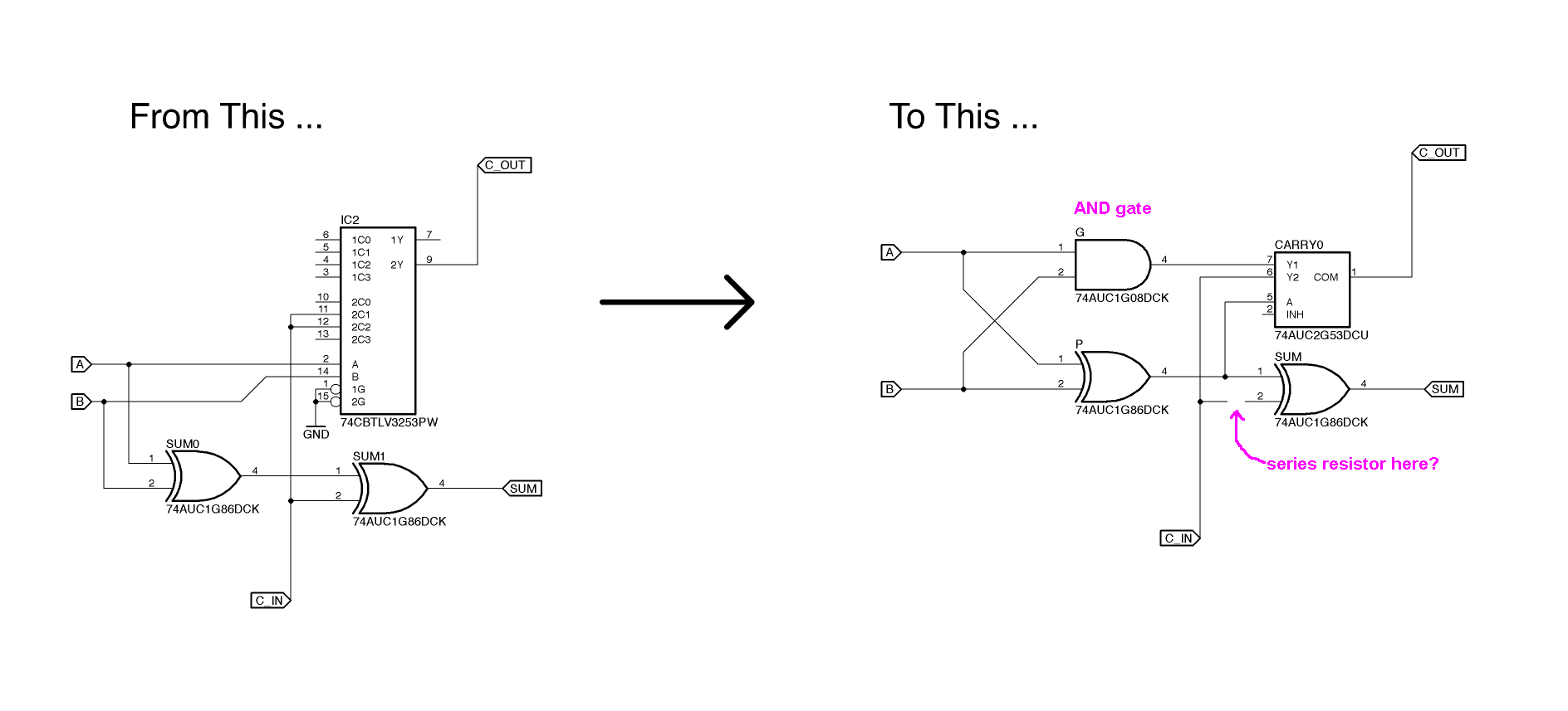

Alright, right up front, we should tackle the ALU, and more specifically the adder. I finally had a chance to test ttlworks' FET Switch Adder. This is an important element of the design and right at the center of the critical path. Within the ALU, the inputs to the adder will be registered, and its outputs will go to the address lines of synch RAM (among other destinations). So the critical path will include the CLK-to-Q delay of the input registers, the Address-to-CLK setup time for the RAM, and a couple of buffers in between. At 100MHz, we get just about 6.5ns available for the adder itself!
The FET Switch Adder uses the fast data-to-Y tpd through the swtiches for the all-important ripple-carry chain. The data inputs are subject to the much slower Sel-to-Y tpd of the switches, but that delay is incurred only once for the whole chain. For the test, I used a variation as suggested by Dr Jefyll, with 74CBTLV3253 muxes, as follows:
The central challenge in the circuit is the build-up of capacitance along the carry chain. To explore the issue, the test sets up the carry chain to oscillate and trigger a 74LVC163 counter. We can configure the chain as 8-bits or 12-bits, and measure the frequency of oscillation as divided by the counter. The carry chain can also be split with an optional buffer (AND gate) after the 4th element to reduce the capacitance. The whole thing sits on about 1.5 square inches of board space:
At these distances, we don't have to worry about transmission line effects, so all connections are unterminated. Here's a trace of the counter output:
We're probing pin 11 on the '163 counter (divide by 16 output), and the carry-chain is configured as two 4-bit segments linked with the AND gate. We can calculate the tpd of the carry-chain based on the 4.29MHz measured frequency as follows:
--> 8-bit carry-chain w/ AND gate: 4.29 MHz x 16 = 68.64 MHz = 14.5ns period / 2 = 7.25ns tpd
Removing the AND gate from the circuit is pretty much a wash -- the delay from the added capatiance is just about equivalent to gate delay we take out:
--> 8-bit carry-chain, no AND gate: 7.2ns
So, we have about 0.9ns per bit. The 12-bit carry chain showed a pretty linear growth in the delay, with 0.9ns per bit as well:
--> 12-bit carry-chain: 10.8ns
So, it turns out that the Elmore Delay calculation I used to estimate the performance of the carry-chain was wildly optimistic. So much for the theory. In practice, the tpd of the adder includes the carry chain plus the switch-time of the 74CBTLV3253, which is 2.9ns (typical). That will remove one bit from the carry chain, so a net addition of about 2ns. The final inverter in the chain should be counted since the carry chain will need to be buffered from the rest of the CPU. So that gives us about 9.2ns for the “A to C” tpd of an 8-bit 74CBTLV3253 FET Switch Adder (roughly 1.2ns per bit).
Not bad at all, and certainly MUCH faster than an equivalent circuit using conventional gates (a conventional ripple-carry adder would be roughly 3ns per bit with NC7SV logic). So a great result, all told, but unfortunately not quite fast enough for 100MHz operation. We’ll have to keep working to squeeze out just a little more performance out of this circuit. :)

Here is a different take on the FET Switch Adder. This one relies on a 2:1 74AUC2G53 FET Switch. (Thanks to Dr Jefyll for suggesting this part). This configuration requires an additional gate, but capacitance on the carry-chain is lower — AUC parts have lower intrinsic capacitance to begin with, and the carry chain now connects to one pin on the switch rather than two, as follows:
Here is the test circuit:
I took the opportunity to extend the carry chain to better simulate a 16-bit incrementer. This circuit also includes four AND gates in series to simulate carry lookahead feeding the final four bits of the adder. Here is they layout of the test board:
74AUC08 ICs are only available in a VQFN package, so I thought I would experiment with that in passing. Honestly, the footprint (bottom center on the board) looks about the same size as the other VSSOP packages, and the big center pad makes routing harder. Not sure I get the advantages. Anyway, I have added thermal vias to the centre pad as per the datasheet. Not sure these are fully necessary, but I understand they make hand-soldering easier. My instinct for soldering these is to use a hot air gun and reflow pre-tinned pads, rather than fuzzing with solder paste. If anyone has had any experience with QFN please chime in. All suggestions welcome.
Incidentally, the good folks at PCBWay have very kindly offered to support this project with PCB manufacturing. Many thanks to them for that! I used them for all my prior boards, so I’m happy to continue to do so. For now, these little test boards are quite straight forward. I’m sure I will welcome having a contact to talk to when we get to the more demanding impedance controlled boards.

Nice going so far.
It's a pity, that 74AUP1G386 (3 input XOR) and 74AUP1G99 (multifunction gate with output enable) are too slow to be useful,
and it looks like no 74AUC version of these chips is in production... yet.
74AUP1G58 is too slow, and there seems to be no 74AUC1G58 in production.
74AUP1G58 can be configurated to work as 2 input AND, 2 input OR, 2 input XOR.
Using only one type of chip for implementing all of the AND\OR\XOR gates would have simplified logistics for ordering parts.
//Since we are at it: in theory, 74AUC1G08 could be substituted by 74AUC2G53, but this won't do good to the capacitances in the carry chain.
There seems to be no "74F298\74F398 equivalent" in 74AUC (2:1 multiplexer plus latch in one chip).
This could have have made it possible to go for a more compact ALU output section.
I'm afraid that inverting B in front of the ALU input latches for having A-B might have a habit of increasing complexity of the control circuitry.
Also, when inverting the data from main memory with XOR gates on their way into the ALU input latches,
I think at 100MHz+ we need to be a little bit more paranoid about the capacitances piling up at the CPU external bus system.
Hello, all. Re the FET Switch Adder, here are a few suggestion/observations, the first admittedly perhaps more fuss than it's worth. As Drass noted, it's important to minimize loading (capacitance) on the carry chain. To that end, it might make sense to insert a series resistor as shown above in a few of the less-significant bit slices (where the resultant delay increase in that bit's SUM output can be afforded). To some extent the resistor would isolate the chain from the XOR gate's input capacitance, and that would sharpen the rise time at that node and thus speed up the chain overall. The improvement would be diluted somewhat because the resistor itself has a certain capacitance to ground; I don't know how much. But even a small net speed increase would make this idea worthwhile.
A more clear cut issue relates to the drive capability of the device(s) driving the carry chain... and of course stronger drive capability means less delay overall. In the unmodified example (left side of the image), each slice drives its C_Out by connecting it to either Vcc or to C_Out from the preceding slice. This means the chain's worst-case drive capability is dependent on a single device -- ie, the flipflop (or whatever) that drives C_In of the least-significant slice. The drive capability of that device is something we would consider carefully.
By contrast, in the modified example on the right the drive for each slice is taken either from the preceding slice or from that individual slice's AND gate, meaning that the worst-case drive capability is now dependent on the individual AND gates near the beginning of the chain. AUC series devices may possibly not be the best choice; something stronger (even though a little slower) might turn out to make more sense. (Or maybe the extra drive should come from two AUC AND gates wired in parallel!)
Finally, the effective speed of the chain is limited by what's deemed to be an acceptable signal level at the final C_Out. We can't afford to wait until this node's voltage approaches one rail or the other; instead, we need to resolve a 49- or 51%-ish voltage into 1 or 0 as soon as can reliably be done. The test board appropriately includes a Schmitt trigger, but if its hysteresis could be reduced then that might aid our cause.
