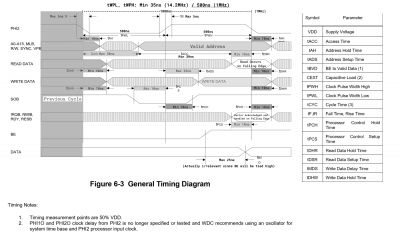

I know the max frequency is voltage dependant, but are the timings given in nanoseconds dependant on the voltage or frequency? Or is it more complex and depends on which specific timing I'm referring to?
The chart on page 25 of WDC's 6502 datasheet only gives timings between 5V (14 MHz max) to 1.8V (2 MHz max). I intend to use 5V at 1 MHz.

I think most of the times are absolute, varying with voltage. The only exceptions I'd expect would be minimum cycle times, which of course define the frequency. But I haven't looked carefully at the table.

On paper, the higher the voltage, the lower the propagation time through a CMOS device. This characteristic implies that timing is dependent on voltage—higher voltage yields faster operation. Of course, there is a voltage ceiling, beyond which the device will be damaged.
Some of WDC’s timing values don’t make a whole lot of sense when viewed in the context of the “F Max vs Vdd” curve published on page 24 in the 65C02 data sheet. You can take some solace in the fact that their 65C02 can be run a lot faster than the timing chart suggests. Plasmo has gotten his CRC65 unit running at 29 MHz, if I correctly recall.

Thanks again BDDinosaur! Based on both responses, I believe I should refer to the 5V (14MHz max) column since that is the voltage I intend to use. This goes a long way towards furthering my understanding of the timing diagram and the animated timing diagram that was linked in Garth's primer.

Be economical with your use of gates in your glue logic and you likely will have no timing worries. As you increase address decoding granularity, you are forced to cascade more gates and prop time can quickly get out of hand.

This went a long way towards fully understanding what I was looking at! It also put in plain view why chip select is tied to the high end of the clock cycle.

Re: Question about 6502 datasheet Timing chart (page25)
One thing I quite like to try to make clear, although it verges on the pedantic, is that for almost all purposes the rising edge of the clock is not a timing reference. It's a very convenient point in the cycle and it's very often used, in effect, to qualify some control signals to arrange that the design is safe and correct. However, it is just a point in the cycle, and if a design had another timing reference which falls neither too early nor too late then it would do just as well.
In your diagram - which is a great idea - we see just two signals referred to the rising edge. One is the rarely-used input SOB. The other is the validity of the databus during a write cycle. As that's not a control signal, there's no safety aspect there for normal designs - the constraint of interest is the receiving device's need to see stable data, which will normally be measured as a setup time, in advance of the falling edge.
As I say, a slightly pedantic point. But I think it helps to have a correct view of what causes what, as well as when things happen.
