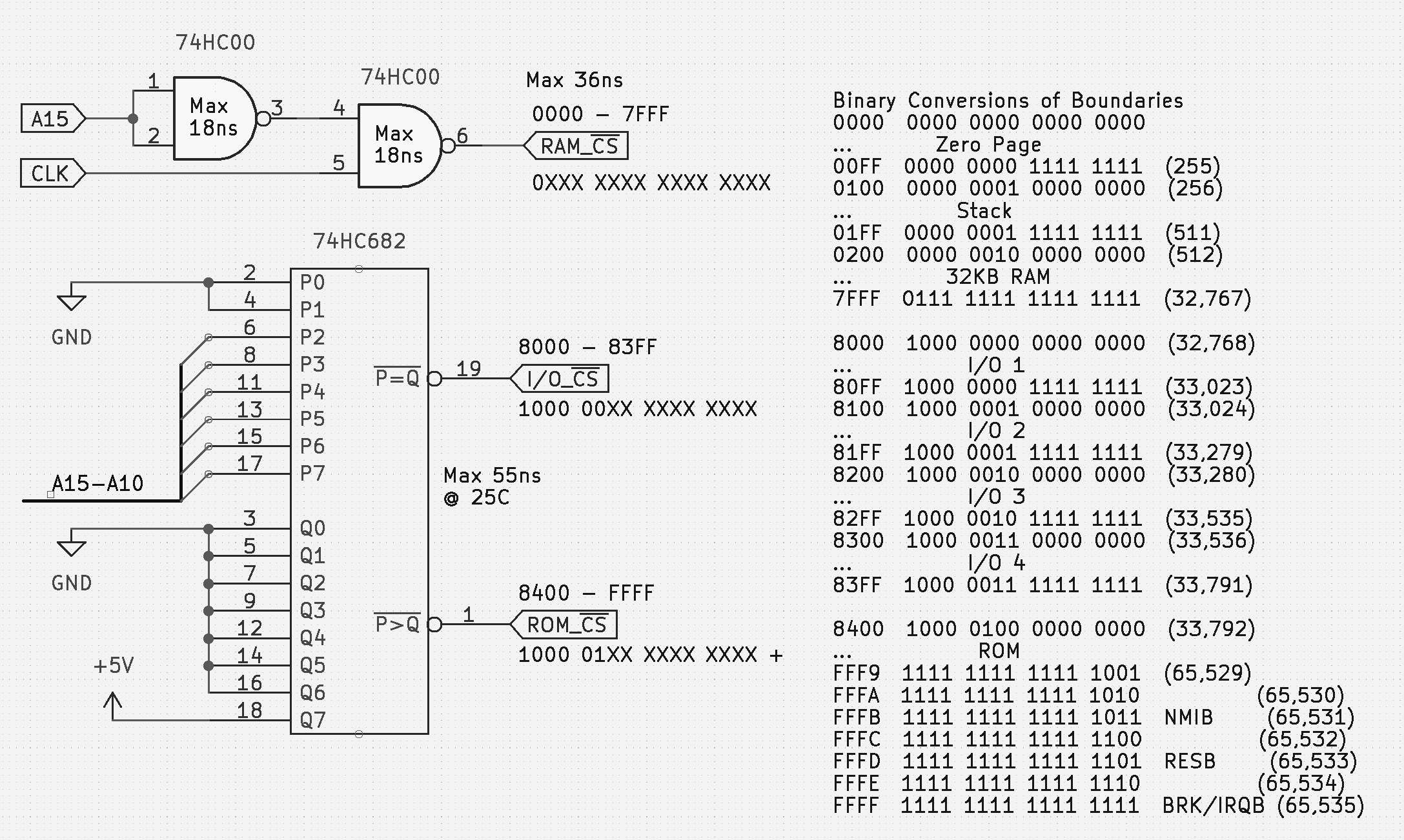

The idea I have at the moment is to "borrow" a memory map from elsewhere on this forum (I forget who posted it):
0000-7FFF 32K RAM (eventually, I want to load programs from an SD card)
8000-83FF 1K I/O (far more than I think I will need, famous last words...)
8400-FFFF 31K ROM (would basically function like a BIOS in a modern PC, handles keyboard, 128x64 LCD, SD card)
I think I figured out how to achieve this:
74HC00 Quad NAND gate
( NOT(A15) NAND CLK ) = RAM_CS\
74HC682 { Inputs 2 bytes, outputs P=Q or P>Q }
A15-A10 connected to P, lowest 2 bits of P tied to ground
10000000 hard wired to Q
P=Q = I/O_CS\
P>Q = ROM_CS\
Primary goal: Get it working and understand it well enough to successfully explain it to someone else.

For the benefit of your readers, your glue logic would be easier to visualize in schematic form. You can attach a schematic in a PDF or as a graphic, e.g., GIF or JPEG. It’s the old “One picture is worth a 1000 words.” thingie...

Here is my proposed address decoder:

PostPosted: Sun Oct 30, 2022 5:56 am
Posts: 8390
MiraLagatta wrote:
Here is my proposed address decoder...
Well, it won’t be very speedy. :D

It depends on the SRAM you’re using. Some are fussy about the order in which the control inputs are asserted and others are not.
In my POC unit, I use an ISSI 128KB SRAM, whose data sheet doesn’t give any exact description of what will happen if /CE is asserted after /OE or /WE has been asserted. However, the timing diagrams indicate that response to /OE or /WE is faster if preceded by chip select. Ergo the technique of gating chip select with Ø2 will slow the device’s response, especially if /CE is continuously asserted, as I’ve seen in some circuits.
Bottom line, best performance will be seen by not using Ø2 to qualify chip selects. This will be especially important as you work toward higher clock speeds, since you are already on the path to a lot of prop delay in your glue logic. Instead, qualify /WE with Ø2 in a 65C02 system, and also qualify /OE with Ø2 in a 65C816 system. Qualifying /OE with Ø2 in a 65C02 system is optional, but won't hurt performance if done right.

It's not a race; it just means that while both WE\ and CS\ are low, the outputs won't be enabled, regardless of the state of OE\. If you do have OE\ low, and then take CS\ low before WE\, there will be that short time that it tries to put something on the bus, and there will be that short time of bus contention if the processor is also driving it, whether either one has arrived at a valid value to drive or not. Note that there's no txx specification for a relationship between CS\ and WE\, or between CS\ and OE\, or between OE\ and WE\.
That was my first thought when he said he wanted to use a 74HC682; but I had to remind myself he said "I intend to use 5V at 1 MHz."

Indeed, as the target speed is 1MHz, it's not fair to criticise that the design won't go at great speeds. It's not meant to, and the comment is just a temptation to scope creep.
Keep it simple, stick to your goals, and get it working. Plenty of possibilities for going further, after you have something working.
