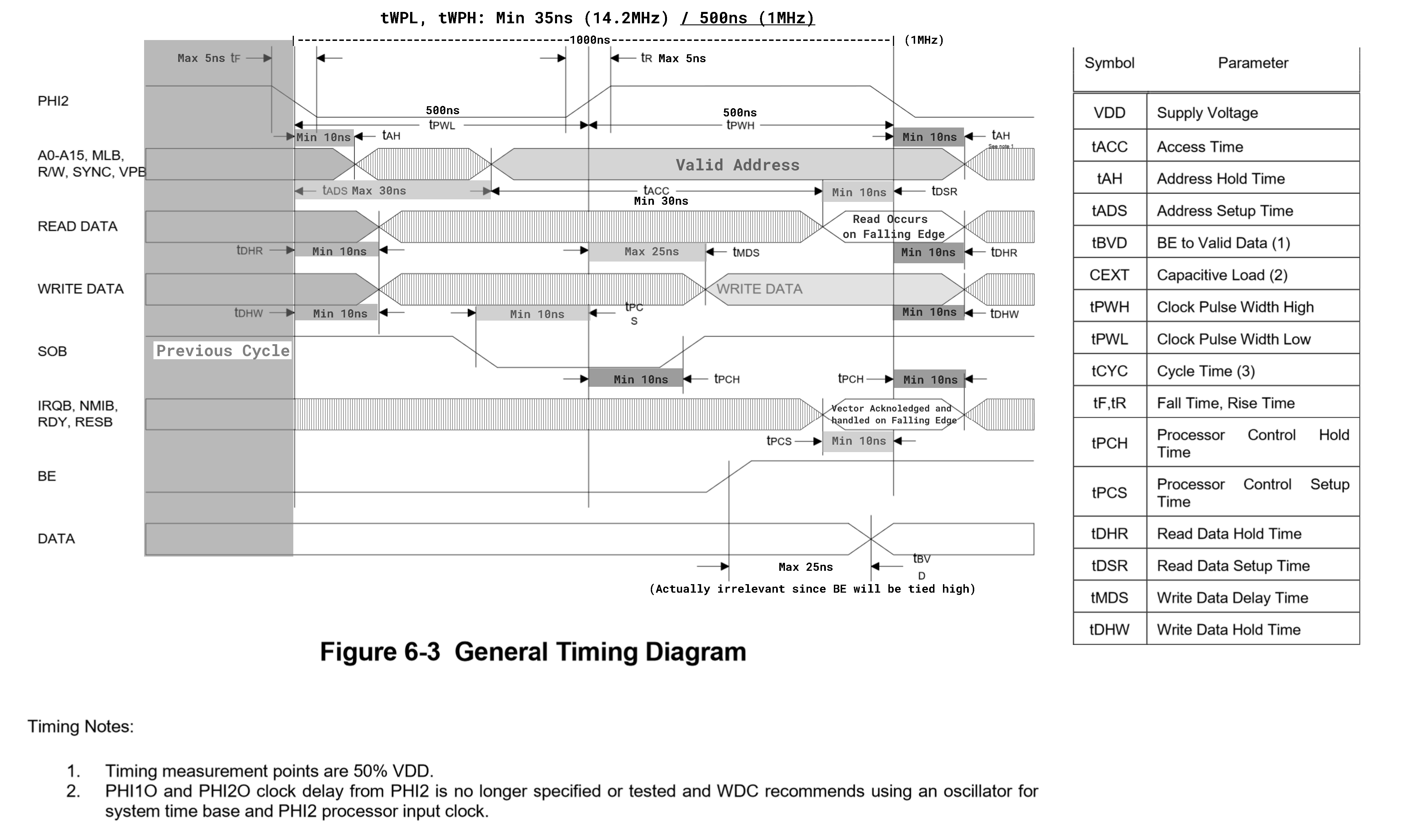

I know the max frequency is voltage dependant, but are the timings given in nanoseconds dependant on the voltage or frequency? Or is it more complex and depends on which specific timing I'm referring to?
The chart on page 25 of WDC's 6502 datasheet only gives timings between 5V (14 MHz max) to 1.8V (2 MHz max). I intend to use 5V at 1 MHz.

I think most of the times are absolute, varying with voltage. The only exceptions I'd expect would be minimum cycle times, which of course define the frequency. But I haven't looked carefully at the table.
On paper, the higher the voltage, the lower the propagation time through a CMOS device. This characteristic implies that timing is dependent on voltage—higher voltage yields faster operation. Of course, there is a voltage ceiling, beyond which the device will be damaged.
Some of WDC’s timing values don’t make a whole lot of sense when viewed in the context of the “F Max vs Vdd” curve published on page 24 in the 65C02 data sheet. You can take some solace in the fact that their 65C02 can be run a lot faster than the timing chart suggests. Plasmo has gotten his CRC65 unit running at 29 MHz, if I correctly recall.

Thanks again BDDinosaur! Based on both responses, I believe I should refer to the 5V (14MHz max) column since that is the voltage I intend to use. This goes a long way towards furthering my understanding of the timing diagram and the animated timing diagram that was linked in Garth's primer.
Be economical with your use of gates in your glue logic and you likely will have no timing worries. As you increase address decoding granularity, you are forced to cascade more gates and prop time can quickly get out of hand.

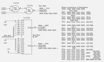

For the benefit of your readers, your glue logic would be easier to visualize in schematic form. You can attach a schematic in a PDF or as a graphic, e.g., GIF or JPEG. It’s the old “One picture is worth a 1000 words.” thingie...
[s]Will do, once I get it drawn up.[/s]
BTW: if a picture is worth 1,000 words, is a video worth 60,000 words per second? :P
Here is my proposed address decoder:
My Address Decoder
My Address Decoder

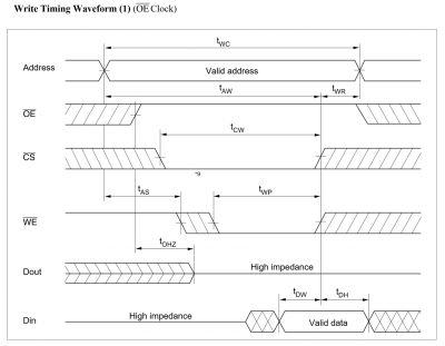

Also, the datasheet for my RAM has this note about the write operation:
9. If CS goes low simultaneously with WE going low or after WE going low, the outputs remain in the high impedance state.
I initially thought this means that if R/W somehow wins the race and goes low before or at the same time as CE, that the write operation won't work, but Ben Eater built his computer with R/W going straight to WE seemingly without any issues. So, what does this actually mean?
Timing diagram it refers to:
RAM Write Timing Diagram

Here is my proposed address decoder...
Well, it won’t be very speedy. :D
  • 9. If CS goes low simultaneously with WE going low or after WE going low, the outputs remain in the high impedance state.
It depends on the SRAM you’re using. Some are fussy about the order in which the control inputs are asserted and others are not.
In my POC unit, I use an ISSI 128KB SRAM, whose data sheet doesn’t give any exact description of what will happen if /CE is asserted after /OE or /WE has been asserted. However, the timing diagrams indicate that response to /OE or /WE is faster if preceded by chip select. Ergo the technique of gating chip select with Ø2 will slow the device’s response, especially if /CE is continuously asserted, as I’ve seen in some circuits.
Bottom line, best performance will be seen by not using Ø2 to qualify chip selects. This will be especially important as you work toward higher clock speeds, since you are already on the path to a lot of prop delay in your glue logic. Instead, qualify /WE with Ø2 in a 65C02 system, and also qualify /OE with Ø2 in a 65C816 system. Qualifying /OE with Ø2 in a 65C02 system is optional, but won't hurt performance if done right.
By the way, all control inputs to 65xx devices (6520, 6522, etc.) must be stable prior to the rise of Ø2. These devices will not operate if you gate any of their control signals (RWB, CS1, etc.) with Ø2.
It's not a race; it just means that while both WE\ and CS\ are low, the outputs won't be enabled, regardless of the state of OE\. If you do have OE\ low, and then take CS\ low before WE\, there will be that short time that it tries to put something on the bus, and there will be that short time of bus contention if the processor is also driving it, whether either one has arrived at a valid value to drive or not. Note that there's no txx specification for a relationship between CS\ and WE\, or between CS\ and OE\, or between OE\ and WE\.
That was my first thought when he said he wanted to use a 74HC682; but I had to remind myself he said "I intend to use 5V at 1 MHz."
MiraLagatta, keep in mind that the timing specifications are guarantees that it won't be any worse than that. The number of nanoseconds guaranteed to be the maximum remain, as Ed said, whether you run it at 14MHz, 1MHz, or .000000001 Hz. (Yes, on WDC's processors, you can stop the clock, in either phase, without their forgetting where they are and what they're supposed to do next.) WDC's data sheets have had an awful lot of errors over the years; but fortunately the parts can usually perform far, far better than guaranteed. BDD mentioned that forum member "plasmo" has gotten one running at 29MHz. Later, plasmo got one running at 40MHz @5.3V, 36MHz @ 5V. (See the edit at the end of viewtopic.php?p=85784#p85784 .)

Indeed, as the target speed is 1MHz, it's not fair to criticise that the design won't go at great speeds. It's not meant to, and the comment is just a temptation to scope creep.
Keep it simple, stick to your goals, and get it working. Plenty of possibilities for going further, after you have something working.

I rewatched Ben Eater's bus timing video https://www.youtube.com/watch?v=i_wrxBd ... l=BenEater again and this time I stopped it multiple times to make notes on my own timing diagram, similar to how he did it. Even he admits that the 6502's timing diagram is a bit convoluted. I grabbed a screenshot of the PDF, threw it into Paint.Net (Photoshop for poor people), added the nanosecond timings directly to the diagram, and added the definitions of the abbreviations along the side and footnotes on the bottom. Everything is on one page and I don't have to flip back and forth between two or three pages any more.
This went a long way towards fully understanding what I was looking at! It also put in plain view why chip select is tied to the high end of the clock cycle.

One thing I quite like to try to make clear, although it verges on the pedantic, is that for almost all purposes the rising edge of the clock is not a timing reference. It's a very convenient point in the cycle and it's very often used, in effect, to qualify some control signals to arrange that the design is safe and correct. However, it is just a point in the cycle, and if a design had another timing reference which falls neither too early nor too late then it would do just as well.
In your diagram - which is a great idea - we see just two signals referred to the rising edge. One is the rarely-used input SOB. The other is the validity of the databus during a write cycle. As that's not a control signal, there's no safety aspect there for normal designs - the constraint of interest is the receiving device's need to see stable data, which will normally be measured as a setup time, in advance of the falling edge.
As I say, a slightly pedantic point. But I think it helps to have a correct view of what causes what, as well as when things happen.
