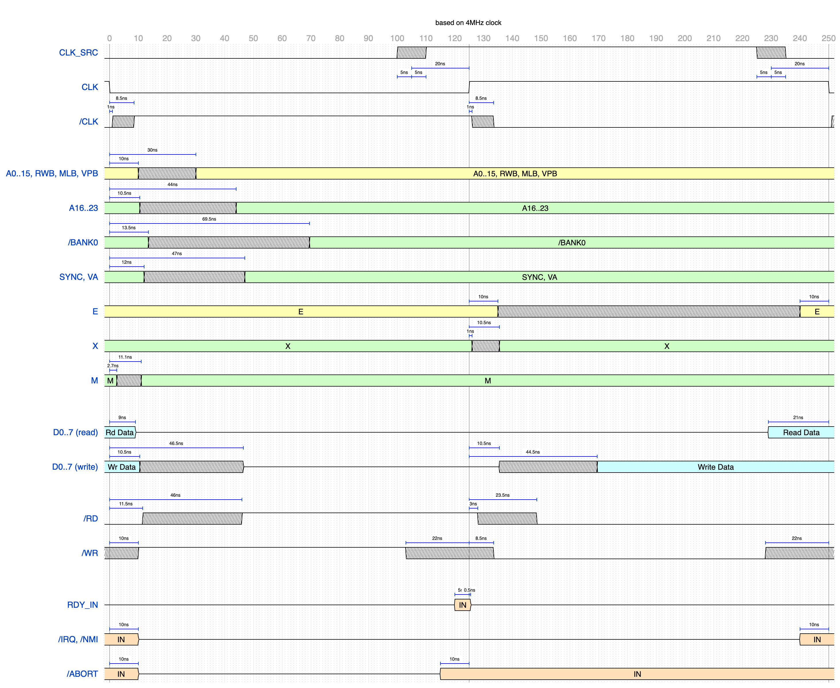

I've been refining my 65C816 circuitry for over a year in my YouTube series, and I'm at a point where I consider the design stable enough to make a PCB. This project aims to provide in a single board everything needed to kick off a new 65C816 project. It includes a clock and reset circuit, and then everything that should have been part of the main processor, in my opinion. Here is a list of features and design constraints:
- Built to plug in a breadboard with a 58-wide pin header at the bottom of the board
- Assuming a 150ns EEPROM and a fast address decode circuit, it is specified to run at 4MHz worst case, over temperature. I suspect significant overclocking can be achieved.
- Uses only discrete, through-hole, and in-production components (with an exception for the obsolete DIP format DS1035M-10, which can be replaced by an in-production SMD format DS1135Z-10, depending on your preference)
- Includes a 4MHz clock source that can be disabled and replaced by an external source
- Includes a power-up reset circuit with a manual reset button
- Uses out-of-phase internal clocks to generate read and write pulses and control the data bus demultiplexing, all in accordance with proper timing (read hold time >= 10ns, write pulse time <= 10ns, bank address latch time <= 10ns but hold time >= 10ns)
- 74AHC logic used for gentle edges on the breadboard while keeping fast propagation. Faster edges (74AC, DS1035) have optional source termination.
- on top of the CPU signals are provided both positive and negative reset and clock signals, /RD and /WR pulses, VA and SYNC signals, Bank0 signal for simple memory maps
- Data bus is free when the clock is low for video access interleaving
- the RDY pin is split into an input-only RDY_IN, and output-only /WAI. RDY_IN is registered on the rising edge of the clock to ensure internal consistency
- the MX pin is split into M and X

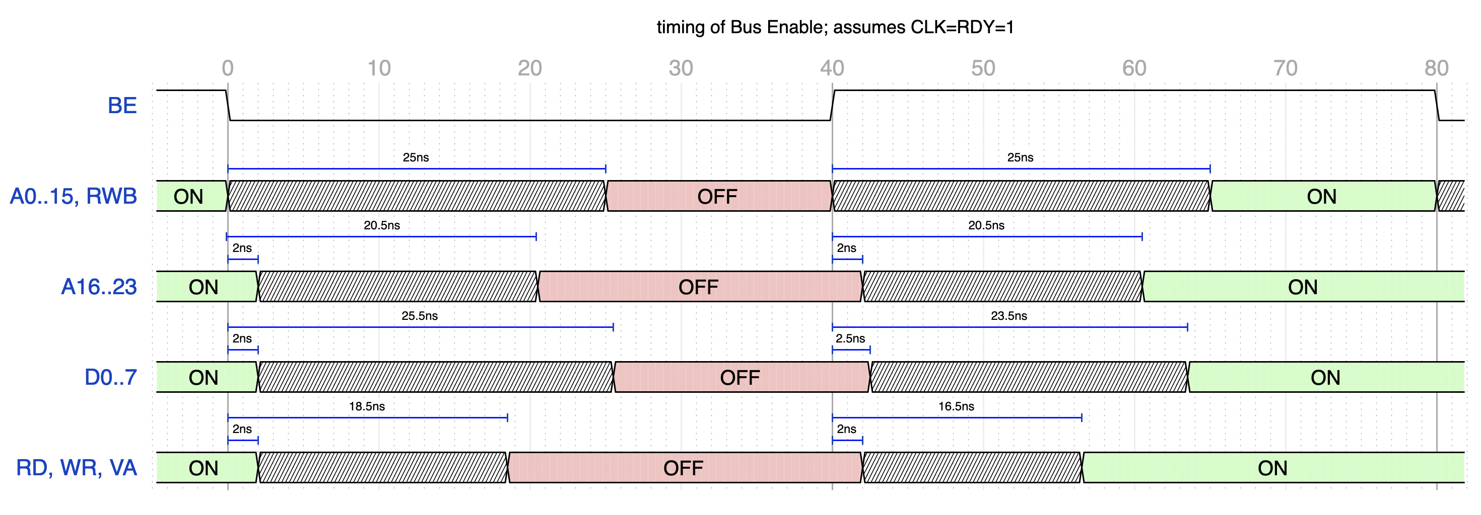

- using Bus Enable for DMA is fully supported, with the data and address buses, R/W, /RD, /WR, and VA signals being tri-stated by BE. They all have weak pull-ups/downs for default values while experimenting with BE on the breadboard.
- using RDY_IN to pause execution as if the clock were held high is fully supported for both reads and writes, with /RD and /WR being kept low and the bank address latch staying closed.
Being in spec with timings and supporting everything means the design is a bit more complicated than what you might need in your project. Presumably, you only need to build this board once to be able to re-use it in most cases. Except for anything faster than 4MHz I guess. Speed, Feature Completeness, Discrete 5V DIP ICs, choose two :mrgreen:
I suspect a future revision with a CPLD will be able to achieve more speed while keeping the features.

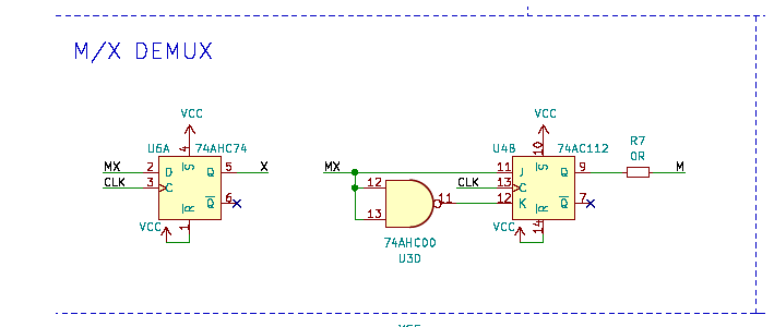

Next: in this section below, y' might wanna add a note to the schematic, explaining that the 74xx112, unlike most flipflops, triggers on the falling edge of its Ck input.

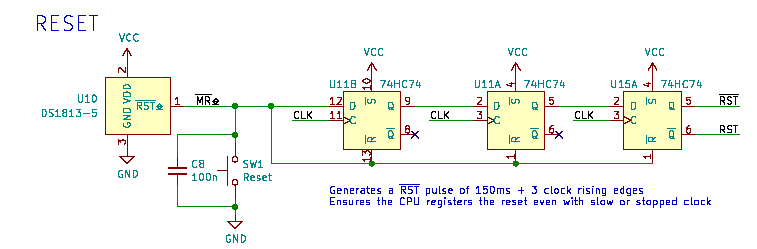

Re the reset circuit (below), I'm puzzled to see the cap between the ground and the DS1813 output. That seems iffty, because the rise time will be very slow. I know the signal gets clocked through U18, but even so... ! Certainly that cap is not what they show in the suggested application in the DS1813 data sheet, so I'm not sure what you're trying to accomplish.

Finally, and despite what the '816 data sheet may say, I'm not convinced that the '816 /RES input needs to held low for "3 clock rising edges," or even for one edge! That's based on what I recall from hands-on, stopped-clock '816 experience during this project.
My recollection may be incorrect, so if you get a minute maybe you'd like to investigate. (Do it in the name of Science!) Haha, okay, well, no pressure. But if you're curious and get a moment, on your breadboard '816 try stopping the clock while it's high. Pull /RES low then let it go high again. Then, when the clock resumes again I suspect you'll see the processor do its reset sequence. You'd also wanna try the same experiment, but stopping the clock while it's low.

I must admit I have no idea where I first saw someone put a cap across the reset switch, and it is one of the few things in this board I haven't studied extensively. The reason given was "to prevent spurious resets due to noise". No idea if it actually does any good or if, as you say, it may be counter-productive. The other thing I haven't studied extensively is termination, and my use of source termination resistors on fast gates to "slow down the edges" is a bit handwavy.
Finally, on the reset circuit, you're right! I just did the experiment, with CLK stopped both high and low, the CPU correctly registers the reset when the clock is restarted. Looking at my bus LEDs, it looks like the CPU changes state internally immediately. I seem to remember the 6502 needing these flip flops, and I didn't verify this on the 65816. The more you know! I think I'll keep this for "datasheet compliance" as it is not hurting anything besides board space...
See here for some work I did on that.
I'm curious about this now that I did the experiment mentioned above. Can you tell us more about your test conditions?

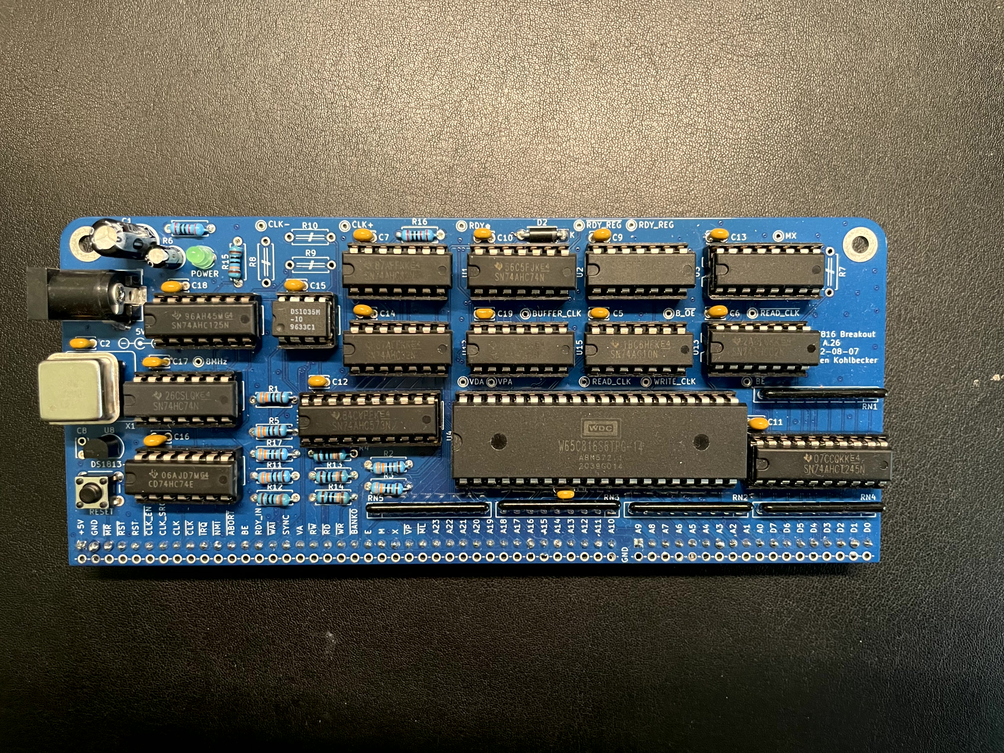

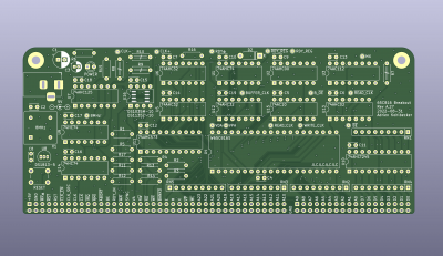

Forgot to update this thread with the final PCB!
I'm pretty happy with the amount of cleanup I was able to do:
Board has been quite stable and worked the first time. I already have a few improvements I would like to make for a future version. For example, my IC sockets are too close vertically, so I can't probe the test points with my oscilloscope probes.
