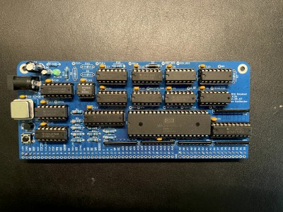

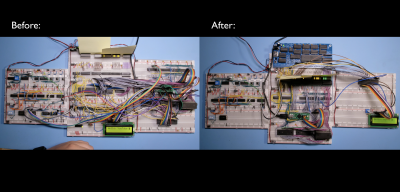

Forgot to update this thread with the final PCB!
I'm pretty happy with the amount of cleanup I was able to do:
Board has been quite stable and worked the first time. I already have a few improvements I would like to make for a future version. For example, my IC sockets are too close vertically, so I can't probe the test points with my oscilloscope probes.
