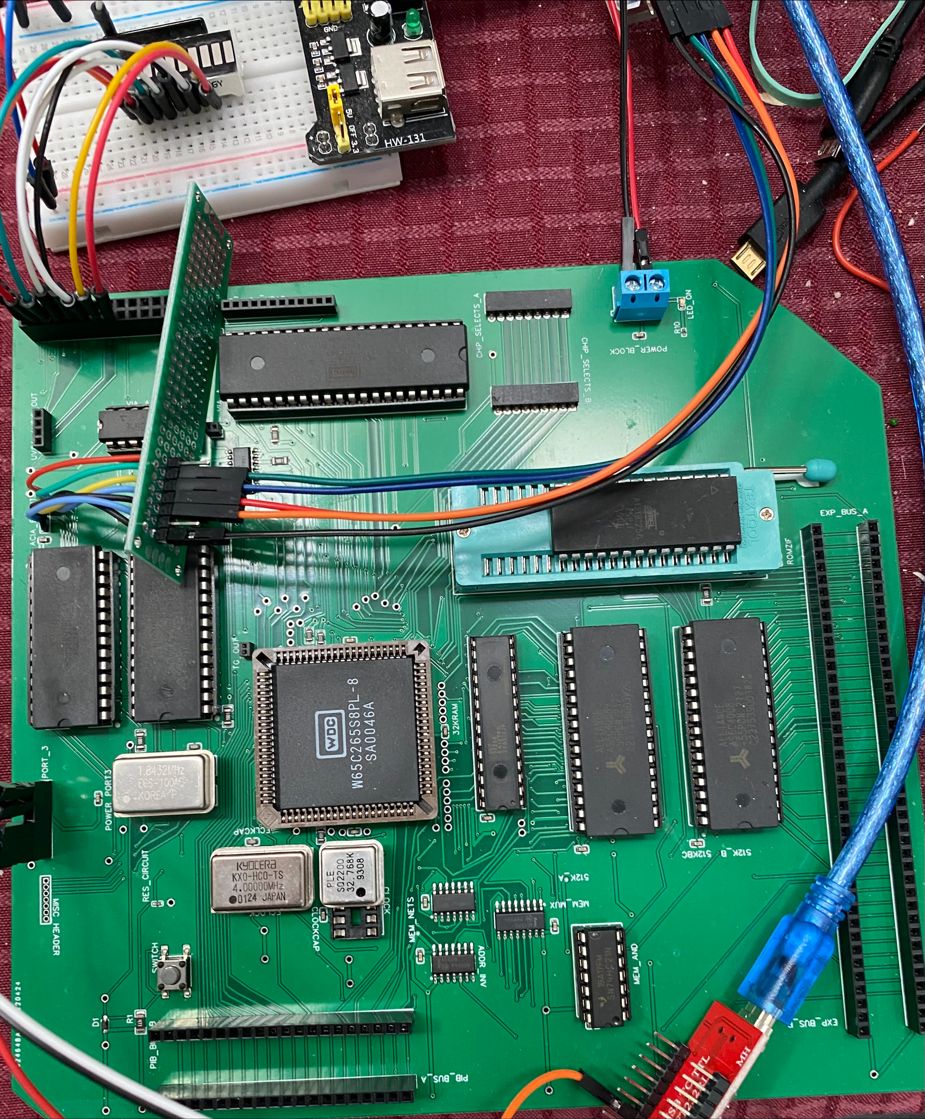

PostPosted: Thu May 12, 2022 2:55 pm
Joined: Sun May 30, 2021 2:16 am
Posts: 375
Okay, here she is!
I found two errors, but they were simple to fix with two wires and some solder.
Testing her like crazy!
