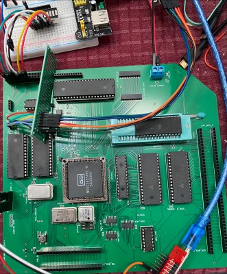

PostPosted: Thu May 12, 2022 2:55 pm
Joined: Sun May 30, 2021 2:16 am
Posts: 375
Okay, here she is!
I found two errors, but they were simple to fix with two wires and some solder.
Testing her like crazy!
PostPosted: Thu May 12, 2022 6:06 pm
Posts: 1043
I would have hoped for a 65256 chip version that has lots of internal RAM and boots from SPI flash, so all IO pins would be available instead of having to sacrifice them for the system bus
PostPosted: Fri May 13, 2022 8:01 pm
Posts: 375
I guess that would have made too much sense (?)
PostPosted: Mon May 16, 2022 10:00 pm
Posts: 344
Who knows... maybe some day WDC surprises all of us with a fpga based '265s, so what you say can be achieved.
