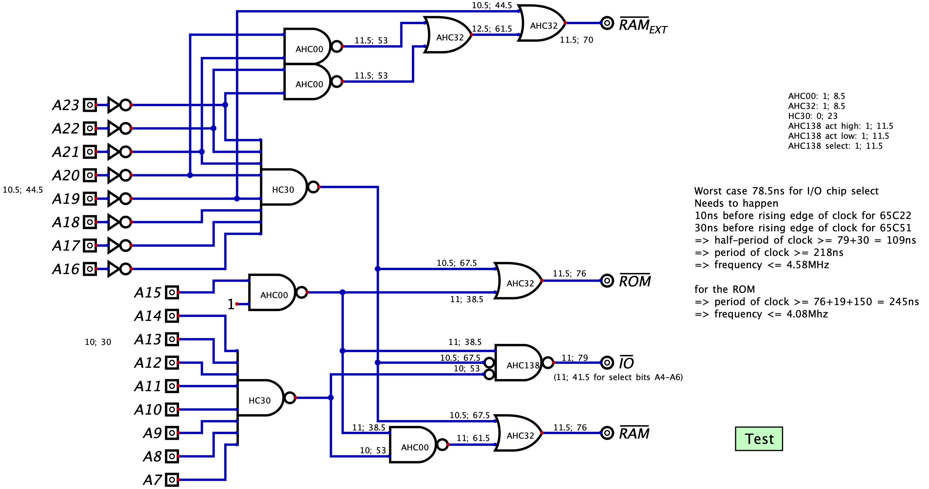

Episode 16 is out!
In this episode, I re-work the address decoding circuit. I'm pretty happy with the result: Gone is the obsolete 74HC4078, which I was able to replace thanks to the 74AC563 inverting latch. I can now detect bank zero using a (N)AND gate rather than a (N)OR.
Here is the new circuit I came up with, and as you can see I still meet the propagation constraints for my 4MHz frequency goal.

It’s neat to see test driven development of logic circuits, that’s a pretty good tool.

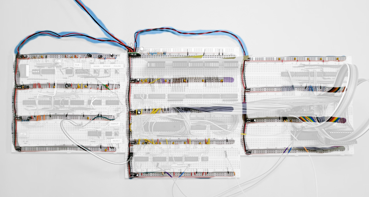

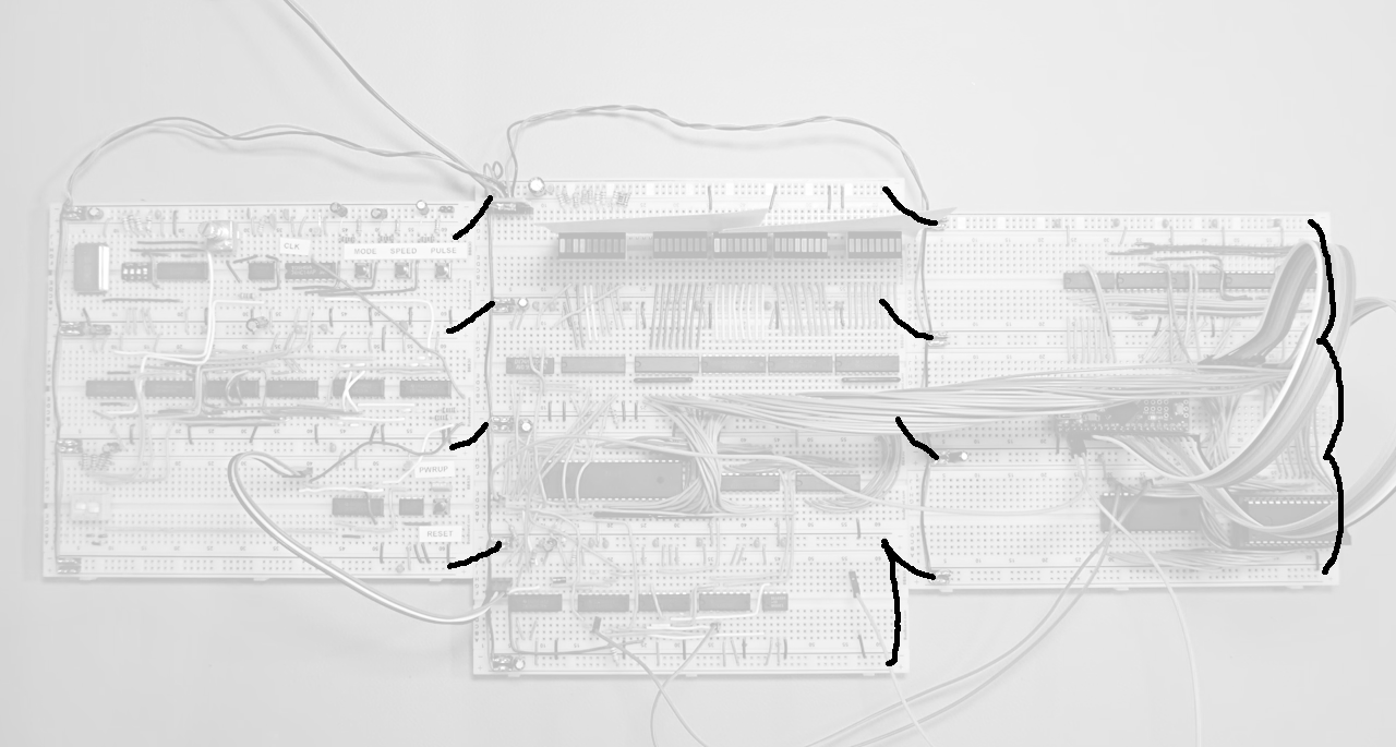

In this episode, I battle some signal integrity problems, as my memtest program is reporting bit flips on the data bus. I re-do my power delivery network and that seems to help a bit, but ultimately I think the length of my data bus and address bus wires is causing reflections, so the problem persists for now, albeit less frequent. Along the way, I add a Teensy bus monitor to help me see what's happening on the busses.
Hope you enjoy!
I'm considering moving to a backplane system, but I worry about how that is going to look on top-down video and how to integrate breadboard work on it. Looking at DIN 41612 connectors, or even PCIe x16 for better signal integrity (the former being specced up to 3MHz only apparently). I could go for PCIe cards, and use a PCIe ribbon extension to bring the signals to a breadboard?
Any feedback on this idea is welcome, as well as suggestions on how to fix my signal integrity problems on the current build

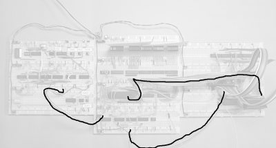

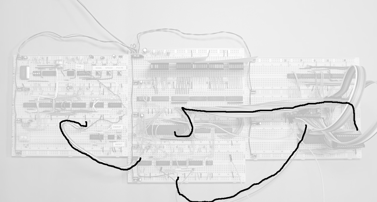

It's best to avoid thinking of the Power & Ground Distribution network as something for connecting the chips to the power supply. Where high frequencies are concerned, its real job is to connect the chips to one another.
Imagine Chip A in Location A. We know it outputs a signal whose current gets carried by a conductor to Chip B, some distance away. It's easy to forget that, in order to complete the circuit, a return current must flow through the Power & Ground Distribution network from Chip B back to Chip A.
The return current will follow the path of least inductance (the resistance is low enough not to matter). Inductance is the enemy, and we can minimize inductance by providing a return path that's in close proximity to the signal path. This is crucial. The signal current and return current flow in opposite directions, and when two opposing currents are in close proximity their magnetic fields tend to mutually cancel. And that's what we want, because it reduces inductance.
(BTW there's another way of discussing this effect. Sometimes in reference documents the signal and return path are described as forming a loop, with the goal being to reduce the loop area -- and thus the number of lines of magnetic flux contained by the loop. Closer proximity means less loop area. In turn we get fewer lines of magnetic flux passing through the loop, which results in less inductance.)
The Power & Ground Distribution Network can support this by making many paths available. For every signal wire connecting Chip A to Chip B there would ideally also be, in close proximity to the signal wire, power and ground wires connecting Chip A and Chip B. This isn't practical on a wireless breadboard (or a 2-layer PCB), but you can achieve some of the same benefit by forming the Power & Ground Distribution network into a coarse grid (a fine grid is even better). Remember: the goal is that, for any signal from one chip to another, you want the return current to be able to follow much the same path, in close proximity, back to the first chip.
In the first diagram below I've highlighted your Power & Ground Distribution network, and we can see that, as a grid, it has many serious gaps. If this were the roadmap of a city we'd say it has far too many cul de sacs, making driving a nightmare. The second diagram shows some possible connections you could add to provide relief to the frustrated drivers!
And, here's another diagram suggesting a further improvement. Since you have several bundles of conductors in midair, vertically separated from the grid, you would do well to add at least a ground wire in close proximity to each of those bundles. Because the goal is to conduct current, both end points (not just one) need to attach to the local ground. (And if there are three or more end points, all should ideally be grounded.)
Hope this helps. I think we could also improve the way your bypass capacitors are arranged, but that's a topic for another post.
The WDC '816 is always challenge, due to the very fast transitions on its outputs. And with a breadboard project of this size you may only find it possible to reduce the number of glitches, rather than eliminating them entirely. :|
BTW you may also want to see my recent post here, also on the subject of Power & Ground Distribution grids.
Let me enthusiastically echo Dr. J's comment above. I sacrificed one Christmas Holiday in 1990's trouble-shooting the "tuning fork" power distribution shown in the "as is" picture. I had a board with similar power/ground distribution configuration with octal tranceivers pair located at the ends of the "tuning fork", one at each arm. They communicated to each other flawlessly for many years until we replaced the 54LS245 with the fast IDT54FCT245 buffers. Then it failed intermittently inside temperature chamber (low temperature, high voltage when 54FCT245 is fastest). Ultimately it was because when multiple signals are switching simultaneously, the ground of one arm was rising (due to inductance) above the switching threshold of the other arm causing faulty data to be written or read. It doesn't matter how well each arm was bypassed. The fix was to tie the end of the tuning fork distribution into grid just like Dr. J's "improved grid" picture. My one sentence summary of that experience was "It doesn't matter how powerful Superman is (54FCT245 was like Superman compare to 54LS245), he can't lift a building if the ground he stands on is soft mud!"

Thank you both for the great information! And even with pictures!
I've been avoiding making those ground connections for fear of creating ground loops. I guess I need to reconsider that :-)

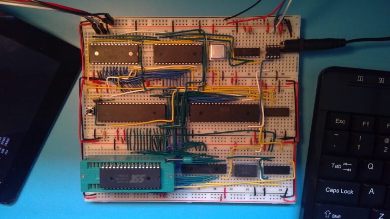

akohlbecker wrote:
... I think the length of my data bus and address bus wires is causing reflections ...
I had similar problems when trying to run a testbed 6502 build with long address and data buses at higher clock speeds.
That prompted me to make a speed test build as compact as possible.
I could only operate the build with longer buses at 2 MHz but the more compact one at 10 MHz.
btw: great video series. I've learned a lot and hope to incorporate some of your ideas into my 65816 build.
