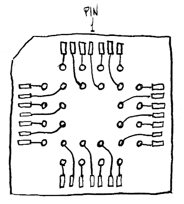

Do you by any chance have the pinout spec for these sockets? I am more interested in PLCC-28, actually, for 22V10s

Ok, I checked one with the DMM continuity-check function, and drew this. It's a top view. The contacts to the IC are shown farther out than they should be, just so there would be room to draw the connections.
I feel embarrassed... I could've done that myself :oops: but was too lazy after spending what felt like an hour on octopart... I thought you probably have a specsheet somewhere. Thank you.

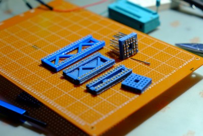

It is feasible to 3d-print your own wire-wrap sockets.
As previously discussed, wire-wrap sockets have gotten expensive and hard to get, especially when it comes to PLCCs. But for those of us with inexpensive (mine was under $200) 3D-printers, there is another option: print your own socket. Here is a picture of my early experiments:
Shown: a few DIP sockets, a pinned ̶P̶L̶C̶C̶-̶2̶8̶ PGA-28 socket (all but last pin, shown next to it), and an unpinned P̶L̶C̶C̶-̶2̶8̶PGA-28 socket.

I'd say that what you have there is a PGA (pin grid array) socket, and you'll plug a thru-hole PLCC socket into it.

I've looked at the data sheets for several different brands of these, and they're not the clearest on whether they all agree. Some data sheets don't give the pinout at all, and others don't tell you if it's a top view or bottom view. It's probably a top view; but they don't say. Do you know these things? If you make a board for one brand of TH PLCC sockets and then later have to get a different brand, is there any danger you'll suddenly have the wrong pinout?
There are JEDEC standards for through-hole PLCC sockets that include pin numbering, pin position and external dimensions. In my POC units, I’ve used several different brands of sockets and have never had any kind of interchangeability issue.
