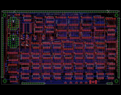

Is the "drag" technique the preferred method even for SOIC packages? It looks like magic on the videos I've seen. I'm instinctively more comfortable with a pin-by-pin approach, but that's probably because I've only soldered DIP packages before (and only very few of them at that). BDD, did you use a chisel-tip iron or one of those hollow tips? I was assuming that because Garth mentioned not using extra flux and a chisel-tip it was pin-by-pin in that instance.
Thanks for all the suggestions - I really would like these boards to have that pristine look :)
Incidentally, Card B is coming along, but I have a ways to go yet. I'm encouraged that it just might work in 4 layers after all - using 6 mil traces, 5 mil spacing and 18 mil vias. Being VERY careful about how horizontal traces are used seems to be the key to this board - at least the bottom section (horizontal traces are in dark blue, air-wires in bright yellow). I'm working my way up from the bottom so I'd say I'm about 1/5th of the way :shock:

Drass wrote:
drag technique to solder the rest of the pins.
I got the hang of it by studying this video. The narrator describes the use of the drag technique on several packages, which worked fine for me.
...using 6 mil traces, 5 mil spacing...
Be sure to run a design rule check on the layout. You may find that 5 mil spacing won't pass the DRC.

Regarding DRC, I've been checking the board as I go and all seems well so far. It's definitely a tight squeeze, but it feels like I'm getting through it. I'm not having to use the VCC layer nearly as much as expected and Arlet's suggestion of putting via's right on the pads has let me get out of a bind a few times :). Nearly half way there now ...
Cheers!

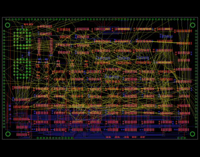

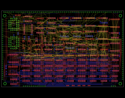

Another milestone along the journey ... the ALU & CU Card is now routed :!:
It took some effort to squeeze things in (and the suggestions above proved essential!). In the end, I'm very happy with the result - over 100 ICs, as many bypass caps, ROM sockets, connectors and assorted passives, along with VCC and GND planes, and even one Canadian flag :). Here is a pic of the top and bottom traces along with the top silkscreen:

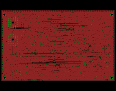

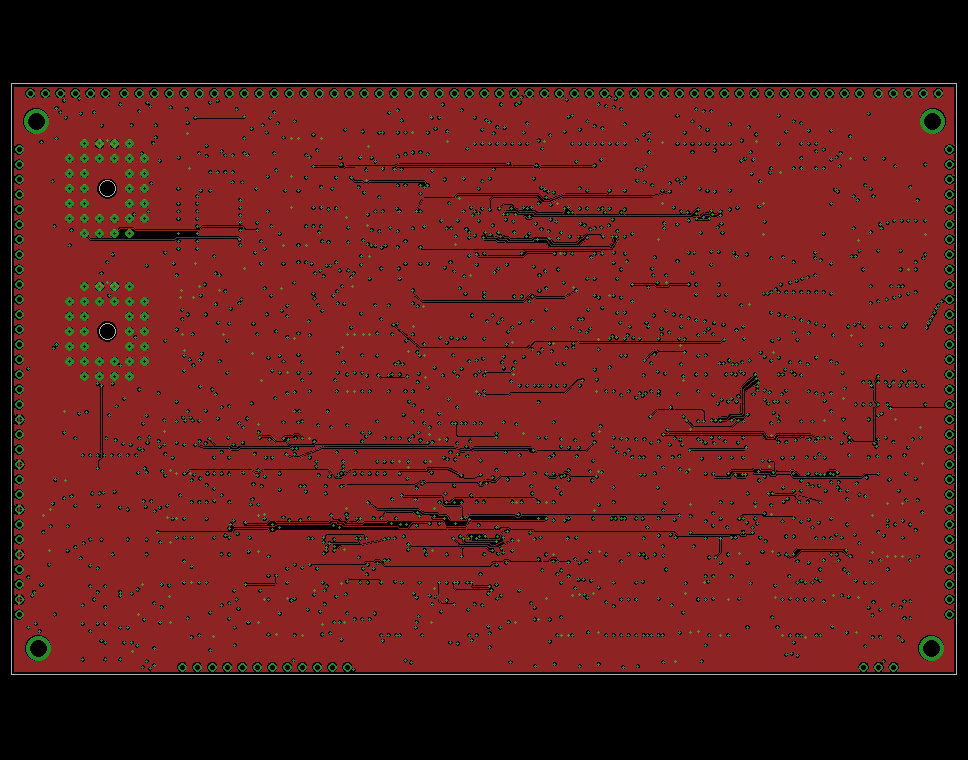

As expected, I had to put traces on the VCC layer, but not nearly as many as I feared:
Surprising really how much room there is, and I'm glad I didn't have to resort to a larger board. I quite like the dimensions currently (not to mention that my copy of Eagle CAD won't let me go any bigger - I did notice, btw, that Altium has a new free version of it's software with no such limit, very interesting).
