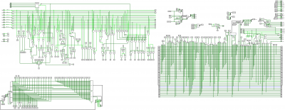

Hello folks,
First post here and a big day for me.
I believe I now have a working model of a 6502 Logisim circuit that (I think) will translate well to a viable hardware implementation on 7400 series chips. It’s an important milestone on my way to building a TTL 6502 and (eventually) a C64 to host it. I was a complete newb to hardware design when this crazy project started (still am really), so this is a big deal to me. My first attempt was a totally impractical design (particularly the instruction decoder and sequencer which required well over a hundred nested gates and implemented only a heavily simplified version of the 6502 instruction set – see attached pic. It actually worked but what a monster!). I suppose it would have been advisable to start this foray into hardware design with a less ambitious project. Nevertheless, this is where I’ve landed and as you may be able to tell, I like jumping into things with both feet in any case.
There is no way for me to really know what will happen when I try to get this second (and much simpler) microcode-based design onto real chips, but I can at least be optimistic. I have tried to use only elements with ready 7400 series equivalents (no crazy 12 input gates, etc.), and tried also to meet their data sheet requirements as I went. Fingers crossed on how that will go. In the meantime, so far as I can tell, the Logisim simulation I have here is fairly accurate but with some differences worth noting. Here is a summary:
• Full 6502 instruction set, including all addressing modes, registers, decimal mode and RS, NMI, and IRQ interrupts,
• Microcode implementation (I wanted a minimum number of ROMs so kept some good ol’ gate-level decoding to stay within a 32 bit control word),
• Single 50% duty-cycle clock rather than the 6502 two-phase one (have to confess to not really understanding the requirement for two non-overlapping phases vs. using a single rising-edge to clock all flip-flops. The later seems much more straight forward. Any explanation on the trade-offs here would be very much appreciated),
• Official opcodes only (all illegal opcodes are NOPs, with the exception of $FA, $FC and $FF which are used for NMI, RS and IRQ microcode sequences respectively),
• Interrupts are recognized at the beginning of the instruction cycle but ignored once a given microcode sequence has begun (the simulation will not recognize an NMI, for example, once the microcode sequence for a lower priority IRQ is in progress),
• No SYNC line implemented (although I think I might be able to use the “Write to IR” control signal almost as is for this?)
• Address and Data busses are held in high-impedance state during phase 1 of the clock to facilitate a memory mapped screen RAM design,
• /BEN (Bus ENable) input pin tri-states the busses asynchronously when high (I think this is roughly equivalent to the 6510’s AEC pin. I might just drop this given the buses are already available during phase 1),
• The RESET sequence uses the 6502 “inhibited write” spare cycles to initialize the stack pointer and clear the decimal flag,
• ADC and SBC instructions take an extra cycle to complete in decimal mode, flags are updated but I still need to validate this is done properly, (Btw, I am amazed the 6502 can fit the binary operation and the BCD adjustment in one cycle! I found I had to split this into two cycles to get anywhere near reasonable propagation delay through all the required logic),
• JMP absolute instruction takes 4 cycles rather than 3 (this would have required some otherwise redundant logic to preserve the PC after fetching the low-byte of the target address. In the end, I decided the extra cycle was worth the savings in extra data path),
• A few other instructions take fewer cycles to complete than in a standard 6502 (e.g. LSR absolute-indexed instruction takes 6 cycles rather than 7 when a page boundary is not crossed - the microcode can easily be adjusted to add dummy cycles and retain more cycle compatibility in these instances. I will likely do that before finalizing the design just to minimize differences).
The design borrows heavily from Dieter Mueller’s multiplexer ALU as well as from multiple articles and posts found on this site about decimal mode, interrupt handling and many other aspects of the 6502’s behavior. I remember thinking that there might be scraps of information on the web about this obscure processor I had programmed as a kid. Instead, I was amazed to find a vibrant community of interest eager to share and learn. The fact that I've been able to get this far is largely due to this community. Many thanks to all of you for that.
On that note, I have run Klaus’ test harness (thank you Klaus) on this simulator and it appears to pass, although truthfully I’m not sure. I’ve read this test will run for about 1 minute at 2 MHz. It will take far longer than I am prepared to wait at the dismal 100Hz Logisim achieves. Nevertheless, I have run through all tests to completion, except the binary and decimal arithmetic tests. For those, I have run through a handful of iterations only (I gave up after three days) and have been forced to rely on unit tests for the time being. A more complete test will have to wait until I have a faster implementation.
I am happy to eventually post the Logisim files if this turns out to be of interest to anyone (and provided I get permission from those I have liberally borrowed from). Of course all comments and questions are welcome. I am particularly interested in ways to validate and simplify the design before going to hardware. I’ll post up some specific questions when I get a chance. As I mentioned, I’m new to hardware so can use all the help I can get.

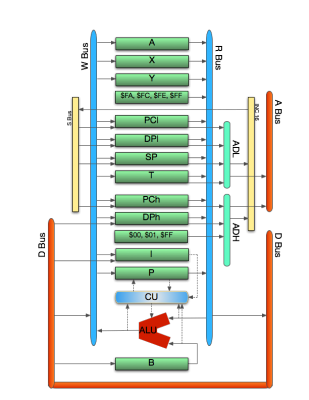

Ok, first up, a block diagram: Busses are on the sides, 8-bit wide registers in the middle. The W Bus on the left is used to write to registers and the R bus on the right to read from them. Outputs from registers to the “R” bus are tri-state (74HC574s with Output Enable signals). For a memory write, data flows from a register to the R Bus and from there to the external Data Bus on its way to memory. Similarly, reads go from memory through the Data Bus and W Bus to a destination register. Transfers between registers travel through the ALU to get from R Bus to W Bus. The ALU takes its second operand from memory through the B register (the B register is required only to spread the long journey from memory through ALU over two cycles).
For addressing, PCL/PCH together make up the program counter. Similarly, DPL/DPH make up the “Data Pointer” which is used to resolve target addresses. Both PC and DP can be output to the internal Address High (ADH) and Address Low (ADL) busses, and from there to the external Address Bus. The stack pointer SP can be output to ADL and is paired with an “$01” in ADH for Page 1 Stack Addressing. The ADH can also generate “$00” for Zero-page addressing and “$FF” to fetch interrupt vectors high in memory. Similarly, the box labelled “$FA, $FC, $FE, $FF” refers to contants that can be placed on the R Bus and loaded into DPL as the low-byte of interrupt vector addresses. The “$FF” constant is also used to initialize the SP register on Reset. Finally, the T register can be used directly as the low-byte of a target address, which saves a cycle during Indirect Addressing operations.
The INC16 circuit is capable of 16-bit increment/decrement operations in parallel with the ALU. It takes its input from ADL/ADH and is used to increment PC, as wel as to manipulate SP for stack push and pull operations. Another parallel data path allows the DPH and I registers to be loaded directly from memory (in addition to the normal path throught the W Bus). Both these “parallel” capabilities were necessary only to try to match 6502 cycle counts on specific instructions.

• 6502 block diagrams depict bi-directional connections from registers to various internal busses. Although I get the advantages of a bi-directional bus, having two independant buses allows me to read from and write to a given register in the same cycle (i.e., when incrementing a register, for example). Does the 6502 have bi-directional buses internally or is it just a short-hand? If bi-directional, how are register increments accomplished in one cycle?
• I often see a Memory Address Register (MAR) connnected directly to the address bus in various CPU designs. I have to confess I don’t really understand why they are needed. So far as I can tell, the extra cycle(s) required to move an address to the MAR can be avoided by using tri-state buffers on the outputs of various registers and using them directly. I have to believe I am missing something here. Why move the contents of the PC to a MAR when one can output-enable the PC register directly onto the address bus?

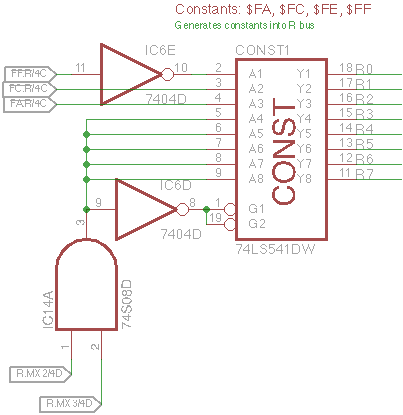

• I could think of no way to generate constants on the R Bus other than by wiring specific values behind a dedicated tri-state buffer (74HC541). Seems like a heavy handed approach. How do folks normally accomplish this?
• I understand that it can be fatal to have IC outputs connected together while not in a high impedance state. Control logic can regulate this on a bus but how does one avoid the inevitable collisions at the point of transition – when one register is “coming up” while another is “going down”?
• Does anything here look like it's going to land me in hot water come implementation?
To illustrate how I'm using this machinery, below is the microcode for an LDA absolute instruction:
(“*” denotes dereferincing an address, “+=” denotes an INC16 operation, “:=” denotes a data transfer)

If you look hard enough, and perhaps cross-reference with Hanson's big block diagram, you'll see for example that X is at different times read from and written to over the Special Bus (XSB and SBX control this) - and indeed, the SB is the only way to access X (and Y too). Anything other than the PC which is incremented or modified will be fed to the ALU in one cycle and then written back in the following cycle or later - there's no same-cycle operation.
Having said which, in fact S can be read and written in one cycle, but with unrelated values. See the use of S to store the first operand byte of JSR while the previous content is sent to the ALU to be decremented, about cycle 19 of the demo.
Of course, as your microarchitecture is different, you'll have different capabilities and different constraints. Thanks for the block diagram - I find that the easiest way to get a grip on things like this.
If you use wire-OR or wire-AND for your busses - or even an explicit OR or AND construction - you can get some constants for free. I think the 6502 gets FF for free by using a precharged bus. Constants like FC then only cost a couple of pull-downs.
I suspect momentary driver conflicts are not much of an issue - if there were an issue, you might need some complicated clocking using multiple non-overlapping phases. I think the case to worry about is corruption of a value being written (or corruption of a write-enable.) Certainly you don't want to have driver conflicts for a full phase or full cycle.
