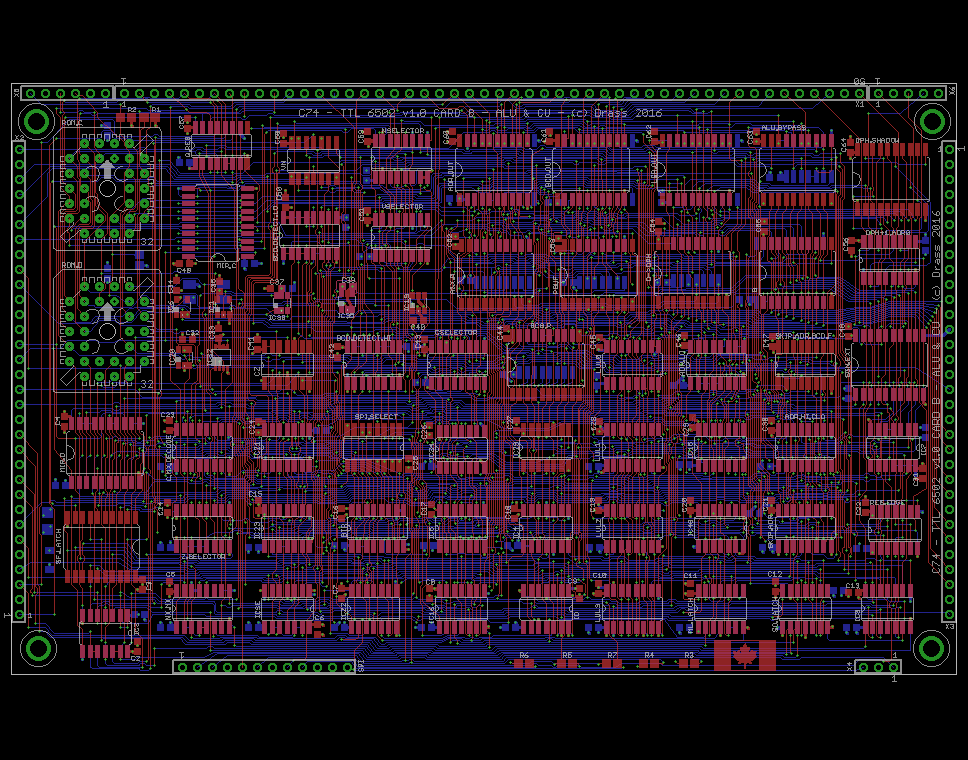

Incidentally, Card B is coming along, but I have a ways to go yet. I'm encouraged that it just might work in 4 layers after all - using 6 mil traces, 5 mil spacing and 18 mil vias. Being VERY careful about how horizontal traces are used seems to be the key to this board - at least the bottom section (horizontal traces are in dark blue, air-wires in bright yellow). I'm working my way up from the bottom so I'd say I'm about 1/5th of the way

Regarding DRC, I've been checking the board as I go and all seems well so far. It's definitely a tight squeeze, but it feels like I'm getting through it. I'm not having to use the VCC layer nearly as much as expected and Arlet's suggestion of putting via's right on the pads has let me get out of a bind a few times

Another milestone along the journey ... the ALU & CU Card is now routed
It took some effort to squeeze things in (and the suggestions above proved essential!). In the end, I'm very happy with the result - over 100 ICs, as many bypass caps, ROM sockets, connectors and assorted passives, along with VCC and GND planes, and even one Canadian flag
. Here is a pic of the top and bottom traces along with the top silkscreen:
As expected, I had to put traces on the VCC layer, but not nearly as many as I feared:
Surprising really how much room there is, and I'm glad I didn't have to resort to a larger board. I quite like the dimensions currently (not to mention that my copy of Eagle CAD won't let me go any bigger - I did notice, btw, that Altium has a new free version of it's software with no such limit, very interesting).
