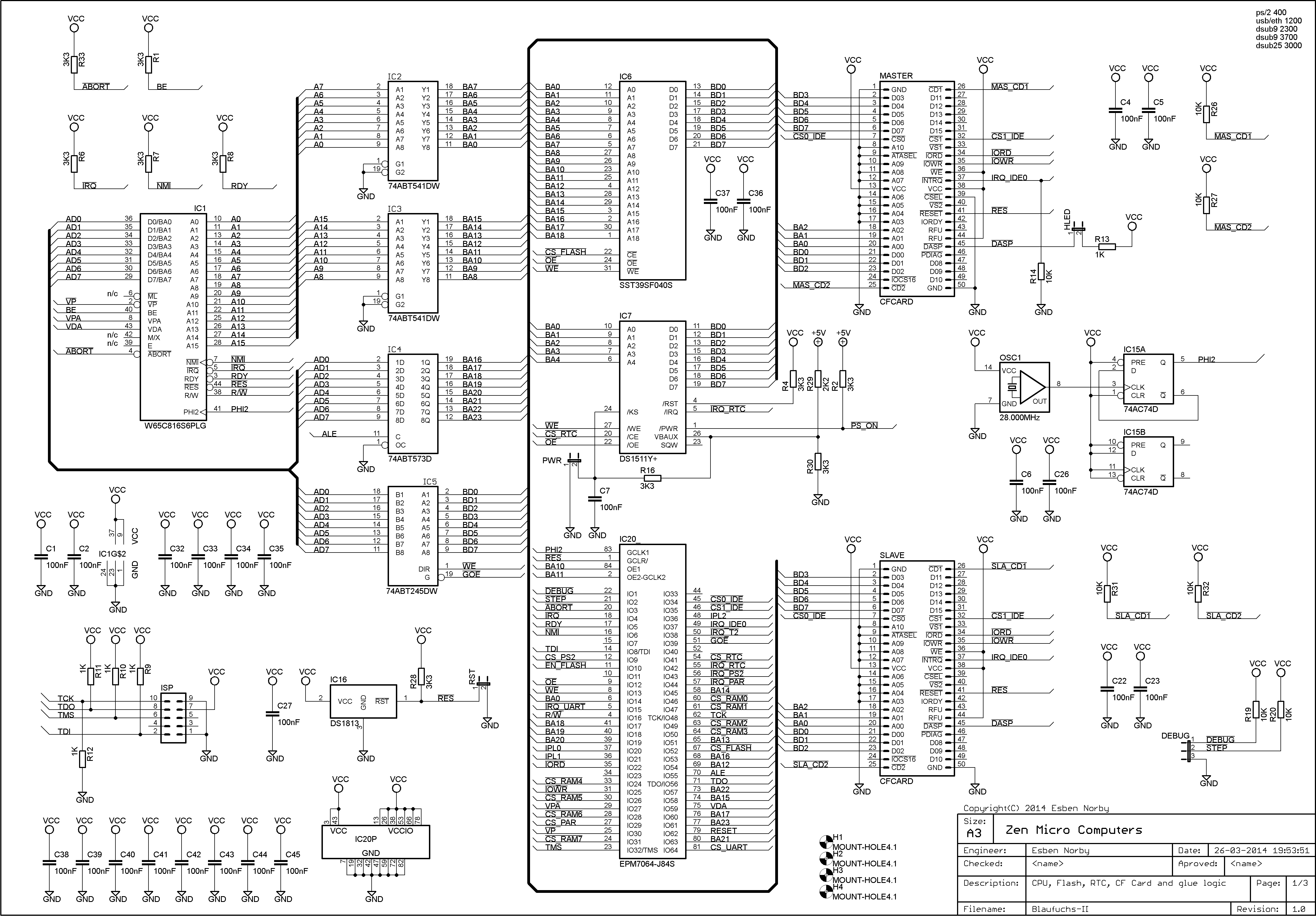

The +/- 12 volt outputs are mandatory in the ATX2.0 and ATX-EPS standards, so they will be around for a long time. Also, power supplies have to be backward compatible with older hardware to assure interchangeability.
You are right I was confusing it with the -5V that is no longer mandatory.

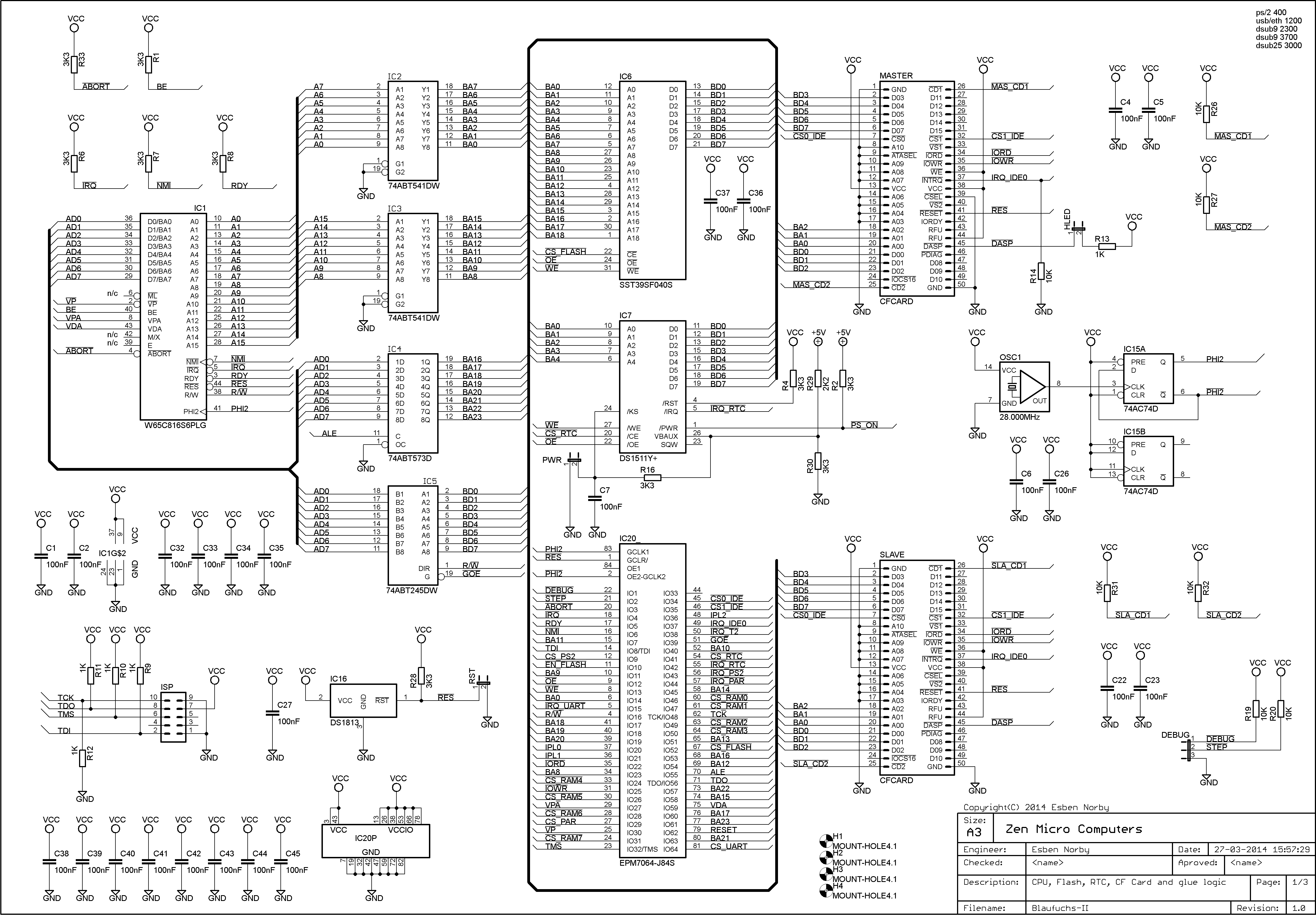

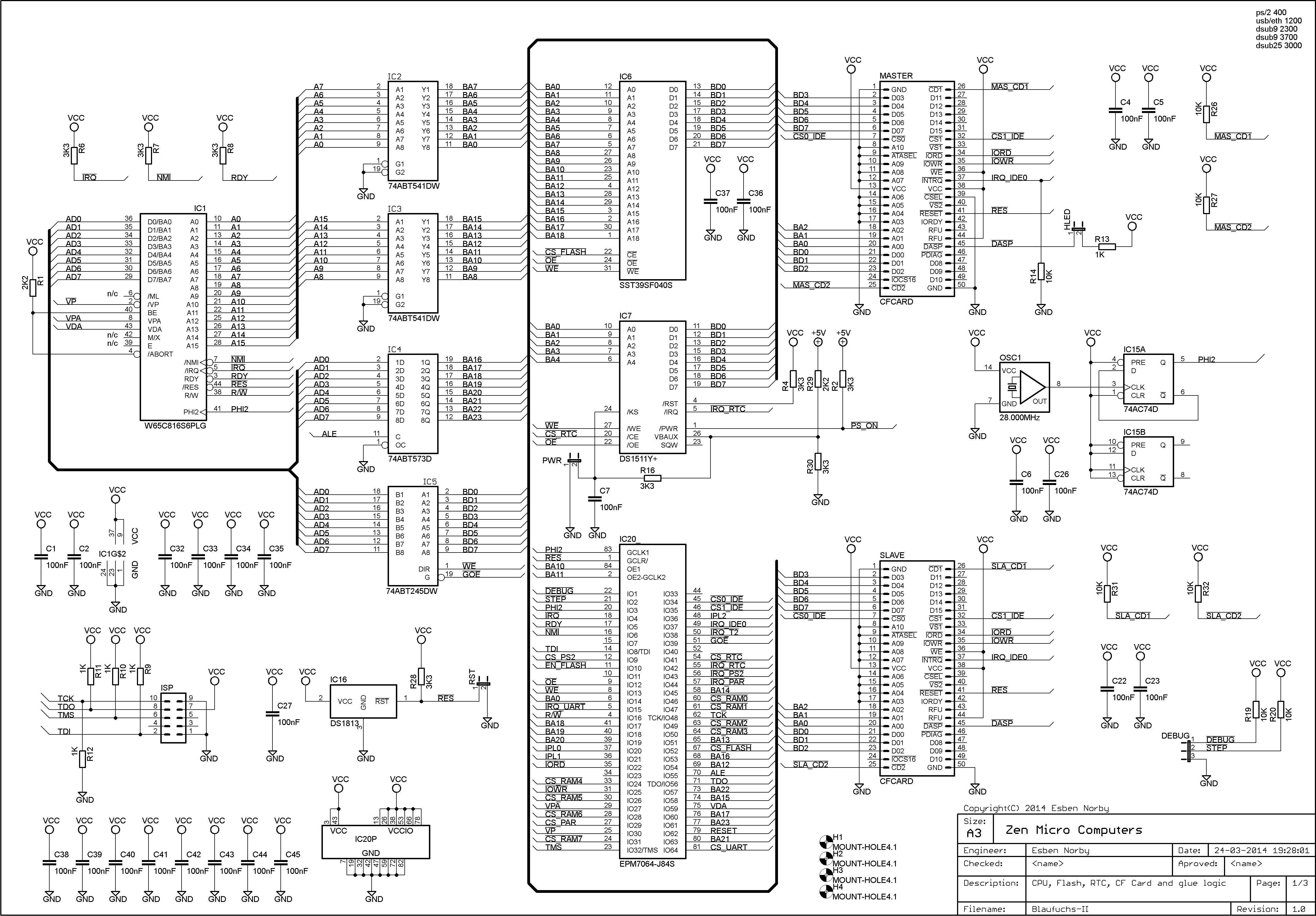

Anyhow, to use /KS (push button input) and /DPWR to control the power supply, proceed as follows:
  1. Create a voltage divider consisting of a 2.2K resistor in series with a 3.3K resistor.
  2. Connect the free end of the 2.2K resistor to +5VSB on your power supply's main motherboard connector—that would be pin 9.
  3. Connect the free end of the 3.3K resistor to ground.
  4. Attach the junction of these resistors to Vbaux on the DS1511.
  5. Connect /KS through a 3.3K resistor to Vbaux.
  6. Connect /DPWR to PS_ON# on your power supply's main connector—either pin 14 (20 pin connector) or pin 16 (24 pin connector).
  7. Connect one side of a push button to /KS. Connect the other side of the push button to ground.
After reading the DS1511 datasheet I get the impression that VBAUX can actually handle +5V.
Page 2 "Recommended DC operating conditions"
Auxiliary Battery Voltage (note 3) VBaux
Says 5.3 V max.
Later in the text they talk about 2.5V - 3.7V for VBAUX but I guess that applies to the 3.3V (W) version.
I just breadboarded the circuit you described, with and without a voltage divider and both seems to work perfectly.
The only gotcha is that pushing /KS again will not automatically power off the system. It seems that it can be handled in
software though.
As for the DS1511's /RST output, it doesn't respond to a push button the way the DS1813 does, so I question its value to you in this design. If you decide to use /RST, under what circumstances would you assert it? If you arrange for the watchdog to assert it, what about using the watchdog for jiffy IRQ generation? You can't do both.
After reading the datasheet I got the impression that the watchdog and irq where unrelated, I guess I was wrong, I changed my schematic - /RST tied to VCC via a resistor.
In lieu of tri-stating the RDY output on the CPLD, you can isolate the circuit with a low-power Schottky diode, with the anode connected to the RDY pin on the '816. A pullup resistor is required no matter how you do it. Better to directly connect RDY to the CPLD and tri-state when inactive. That way you can use the CPLD to detect when a WAI is being executed.
Noted, I have removed the RDY_OUT.
Says 5.3 V max.
As I said, Dallas' data sheets can be confusing. Whomever was responsible for their technical writing needed to be reassigned to janitorial service. :lol:
Several years ago, I talked to Maxim's tech support on this subject and was told that Vbaux was intended to be powered by a CR2032 battery or similar. I tried to pin the guy down on whether Vbaux could be directly powered off the +5VSB output of an ATX power supply, but all he would say was it was intended to be powered by a 3.3 volt battery. So I decided that he was trying to tell me that the 5.3 volt max was probably a "do not exceed" value and that Vbaux really should be powered by 3.3 volts. Hence the voltage divider.
I just breadboarded the circuit you described, with and without a voltage divider and both seems to work perfectly. The only gotcha is that pushing /KS again will not automatically power off the system. It seems that it can be handled in software though.
There's a defined sequence to follow in order to power down under software control. You will need to peruse the data sheet for the details, starting on page 17. Look at the PAB bit in register $0E.
It's also possible to detect closure of the power push button while the system is powered, and in fact, you can arrange for that closure to generate an IRQ. In such a case, the IRQ could cause the operating system kernel to initiate an orderly system shutdown when the power push button is pressed, like what happens with Linux or Window$.
The DS1511 can be programmed so that an underflow of the watchdog will either generate an IRQ or toggle /RST. In my application, I have the watchdog timing out at 10ms intervals, but automatically reloading and continuing. Hence it isn't necessary to restart the timer each time it underflows and interrupts.
See following code for a set of definitions for the DS1511 and the 26C92.

After much consideration and trying this weekend I have decided to skip SPI and the ENC28J60 in this version of the SBC. But it is definetly on the top of my list for next version.
I looked at you 65SPI and it looks like a nice device. Do you have any plans to convert the code to something else like VHDL? Not that I don't want to support you efforts by buying from you - but I would like to keep the chip count down - possibly buy incorporating it into a bigger chip.
/norby
 Post subject: Re: SBC Blaufuchs-II
PostPosted: Mon Mar 24, 2014 6:45 pm
Joined: Wed Mar 19, 2014 9:36 am
Posts: 21
Says 5.3 V max.

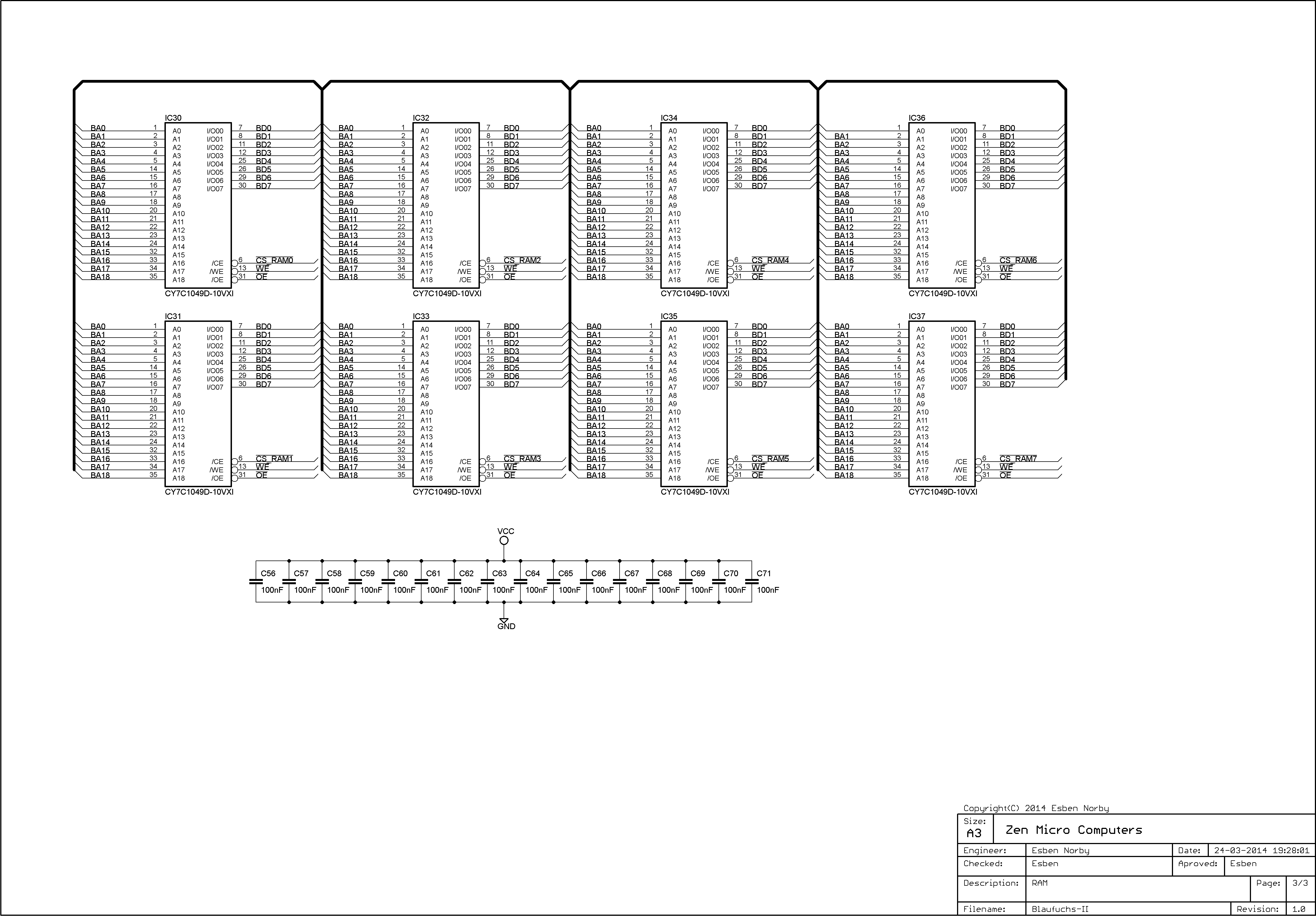

Again thank you for all the clearifications, you seem to have spend quite some energy on this chip :)
I have incorporated all you suggestions into my schematic. I think I have reached a point where I don't what to change anything... at least for this version of the SBC.
Comments are welcome.
/norby
Not really. :D I put far more time into the 26C92 and 53C94, even though their data sheets are more lucid than those of Maxim.
  • I see two Ø2 connections attached to the CPLD. The one at the GCLK1 input (pin 83) makes sense, as your flops and state machines would be clocked from that input. What's the purpose of the Ø2 connection at the IO3 input (pin 20)?
  • You have ABORT and BE on the 65C816 sharing a common pullup resistor. I'm not aware of any adverse effects that such an arrangement might cause, but it does prevent those inputs from being used for their intended purposes. If you can spare the room, I suggest separating the two (take a look at resistor networks in SIPP form to conserve PCB space) and connecting ABORT to an unused CPLD input so you can experiment with it.
  • What is the function of IC20P?
  • I really don't recommend the use of the MAX3232 in your application. That device was developed to implement serial transceiver functions where economy of power consumption is paramount. Maxim sacrificed drive strength and noise immunity to minimize power consumption. You will be powering your unit from a PC type power supply, so the value of the MAX3232 in your application is zilch.
    The MAX238 is a better choice, as its charge pump circuit produces a more robust output, which makes it do a better job of driving the serial link. Plus you get support for both serial channels in a single package, will consume less board real estate (fewer capacitors) and as a bonus, a single MAX238 costs less that two MAX3232s. Order Maxim part number MAX238CWG+ for the SOIC24 version or MAX238CNG+ for the PDIP24 package. Pinout is the same for both devices.
  • In some cases, TIA-232 devices may required that their DSR inputs be asserted as a condition of establishing communication. You can take care of this by providing a DTR output from your serial hardware. Make the connection at the MAXxxx V+ pin. See attached.
    File comment: MAX238 Typical Interface (from POC V1.1)
  • Resistors that drive LEDs from Vcc should probably be 470 ohms. The value you selected drives most LEDs harder than necessary.

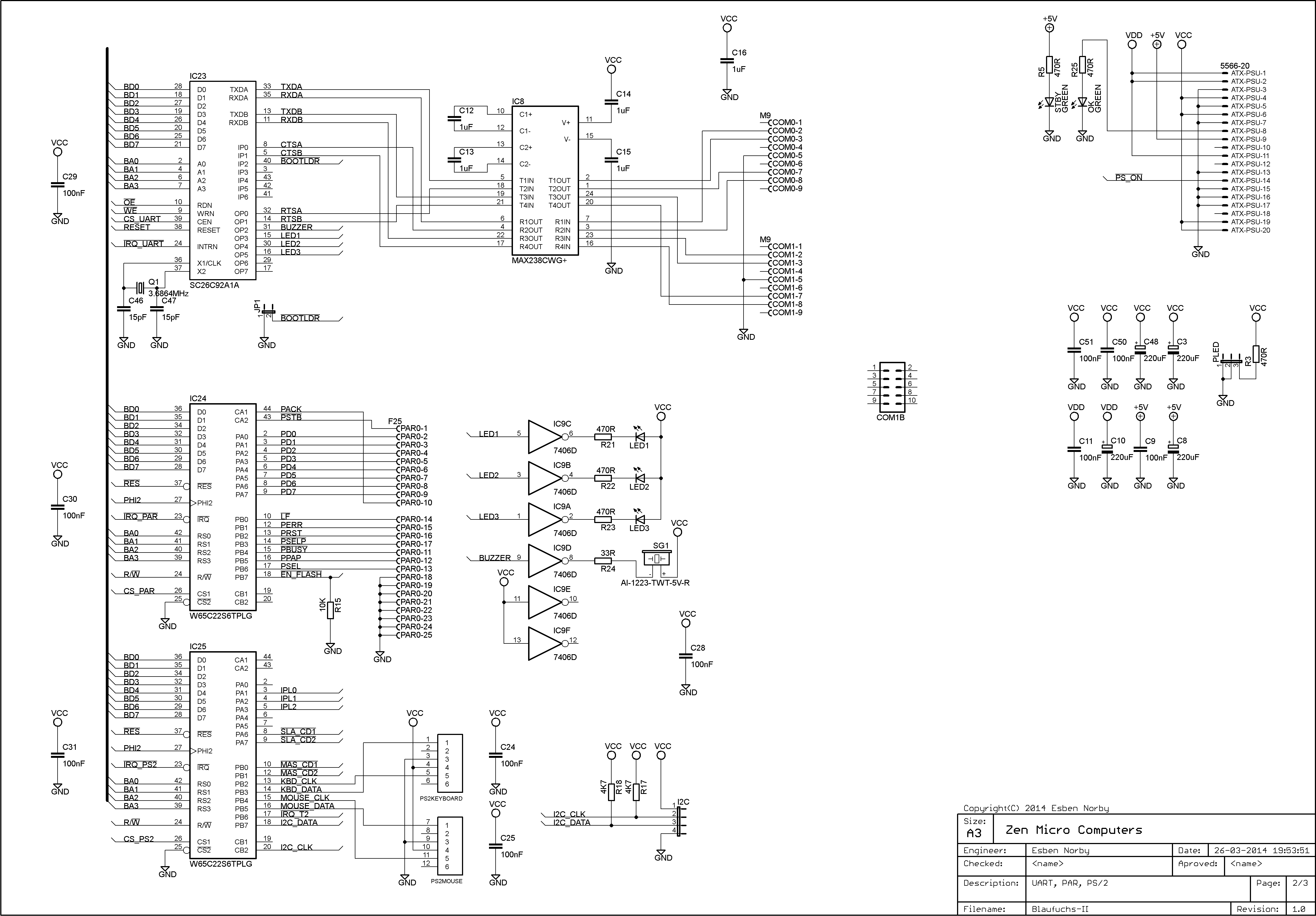

I'm/was uncertain if the signal going into GCLK1 can also be referenced like a normal input pin inside to CPLD code. But I guess it can be.
I'm using 1206 SMD resisters so board space is not really an issue here. I have changed the schematic to what you have proposed.
This is just the power connection block for IC20, the CPLD, It can do some fancy level shifting depending on what you feed it on the VCCIO pins - at least that is what I think I see in the data sheet :-)
I really don't recommend the use of the MAX3232 in your application. <snip a lot of good points.... :-) snip>
I have changed the design to use a SOIC MAX238 as you suggest.
Changed, thanks!
During my own review I encountered one thing that I hope you can shed some light on. Currently I have the direction pin on the 74ABT245 (IC5) connected to the /WE output from the CPLD. Would it be better/mandatory to connect it directly to the R/W pin from the CPU?
As always input is welcome!
Attached it the latest version of the schematic.
/norby
GCLK1 is like any other input. All internal timing references that depend on the state of Ø2 should refer to this input. If you have any logic that becomes active/valid on Ø2 low, it might not be a bad idea to derive a Ø1 clock from the /Q output of your clock generator flop and connect that signal to the GCLK2 input on your CPLD. Generating Ø1 inside the CPLD uses product terms (you have to synthesize a flop) and causes Ø2 and Ø1 to slightly overlap.
DIR on the '245 should be driven by RWB from the MPU. As you have it now, two timing issues will arise. The key one is that the '245 will lag the change in data direction by the prop time of the CPLD, which will become problematic as you crank up the clock rate. The other issue is that if you have your /WE output from the CPLD being qualified by Ø2 high (as you should), the '245's direction will not be set up until Ø2 high plus the CPLD prop time plus the '245's state change time.
Incidentally, I see some connections on the '245 and your '573 bank latch that don't seem to go anywhere.
PostPosted: Thu Mar 27, 2014 3:21 pm
Posts: 21
Which ones? The /GOE and ALE signals? They are connected to the CPLD...
I connected the /Q of the clock flip flop to GCLK2 of the CPLD, for lack of a better name I called it /PHI2.
I also changed the DIR pin of the '245 to use the MPU's R/W signal directly.
I have attached sheet 1 which is the only one that has been updated this time.
/norby
