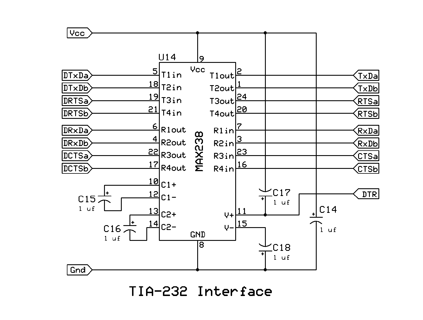

  • I really don't recommend the use of the MAX3232 in your application. That device was developed to implement serial transceiver functions where economy of power consumption is paramount. Maxim sacrificed drive strength and noise immunity to minimize power consumption. You will be powering your unit from a PC type power supply, so the value of the MAX3232 in your application is zilch.
    The MAX238 is a better choice, as its charge pump circuit produces a more robust output, which makes it do a better job of driving the serial link. Plus you get support for both serial channels in a single package, will consume less board real estate (fewer capacitors) and as a bonus, a single MAX238 costs less that two MAX3232s. Order Maxim part number MAX238CWG+ for the SOIC24 version or MAX238CNG+ for the PDIP24 package. Pinout is the same for both devices.
  • In some cases, TIA-232 devices may required that their DSR inputs be asserted as a condition of establishing communication. You can take care of this by providing a DTR output from your serial hardware. Make the connection at the MAXxxx V+ pin. See attached.
    File comment: MAX238 Typical Interface (from POC V1.1)

I really don't recommend the use of the MAX3232 in your application. <snip a lot of good points.... :-) snip>
I have changed the design to use a SOIC MAX238 as you suggest.
