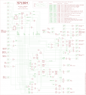

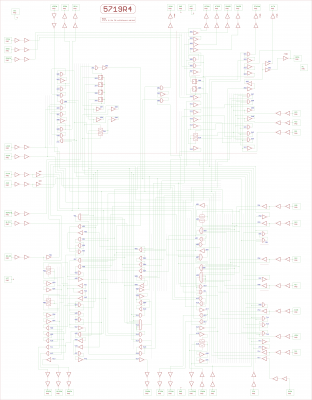

Low resolution 5719R4 picture.
//for a three times higher resolution picture, you need to negotiate with Frank.
Schematic of the chip "as it is",
omitting the PMOS FET switches in the 2:1 multiplexers for better readability:

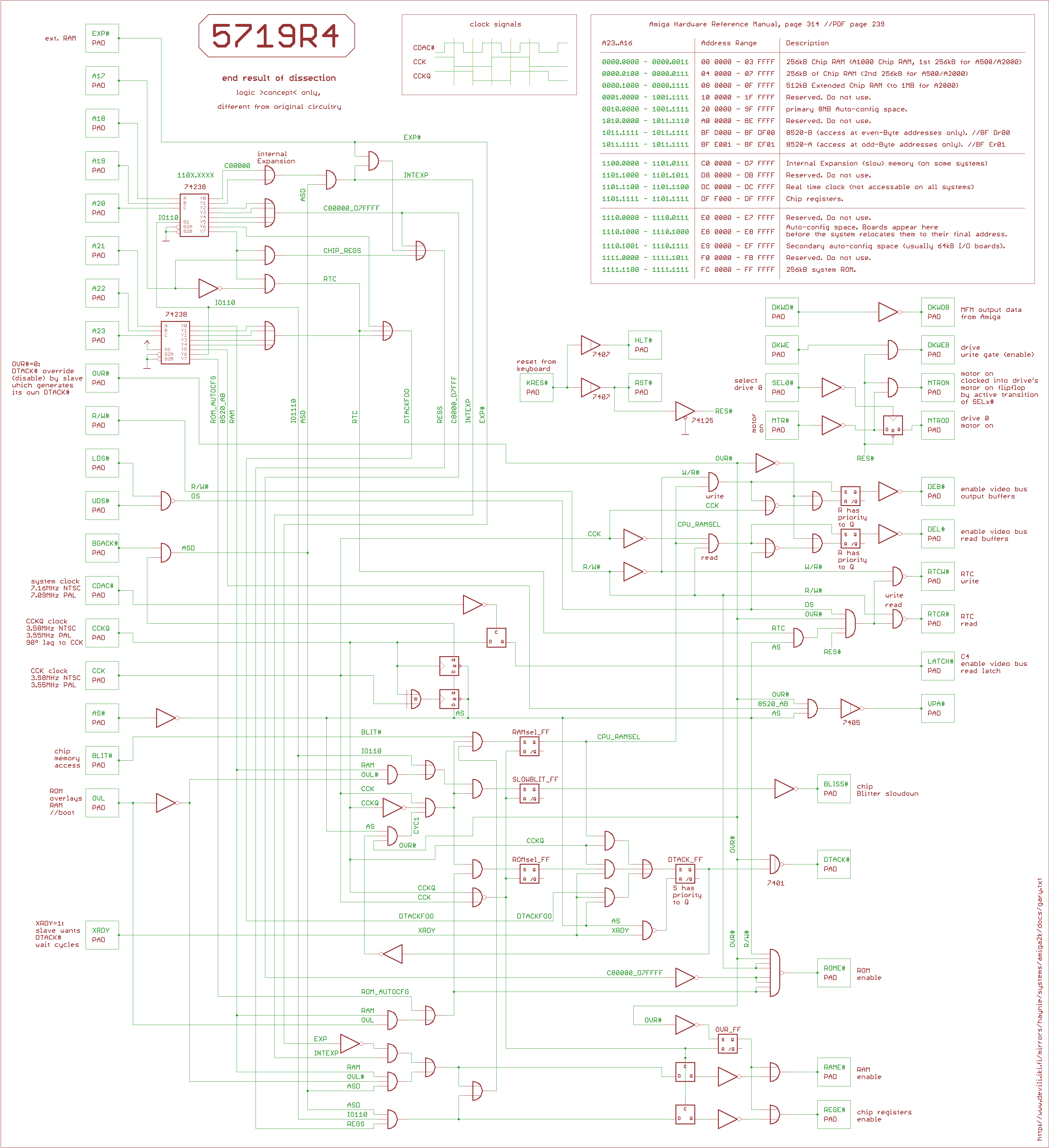

End result of the dissection:
The complete set of schematics with all steps of the dissection as a ZIP:
5719r4_dissect_schematics.zip
(1.23 MiB) Downloaded 92 times

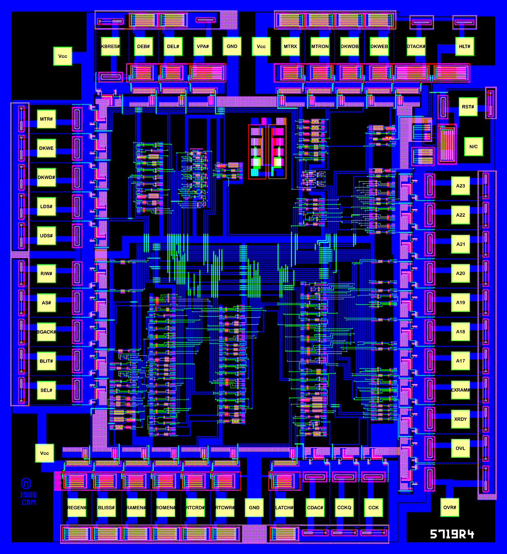

The 5719 chip layout says (in the South West corner) that the mask was generated in 1986.
Rumors say, that MOS\CSG always had some little problems with the CMOS process.

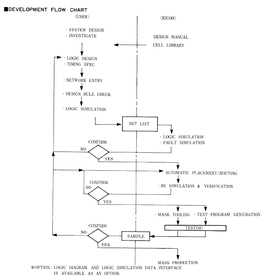

We know, that Commodore had used a Ricoh RP5GH05 CMOS gate array in 1541C\1541-II floppy drives,
the chip was labeled 251828-03,
McMaster has a microscopic picture of the silicon.
A datasheet of the RP5GH05 can be found at Bitsavers:
Rico Electronic Devices Data Book 1988, PDF page 102.
The data book says, that the design process goes like this:
The customer just "tinkers with the logic equations" and "the Ricoh RP5GH standart cells library",
and after that Ricoh does the chip layout.
Other CMOS gate array vendors probably had a similar design flow.
But the 5719 chip layout shows a "MOS style" test pattern, and the output drivers in the 5719 don't look like Ricoh.
In fact, the 5719 output driver layout looks very similar to the output drivers we have seen
in the 65CE02 chip layout.
So we could assume that the 5719 and the 65CE02 were designed and manufactured by MOS\CSG "in house".
Nevertheless, it's an interesting question whether MOS\CSG had bought design libraries
from other CMOS gate array vendors or not for designing 5719 and 65CE02,
but getting hands on microscopic pictures of the gate arrays manufactured by a dozend of different vendors in the 80s
(more than 40 years ago) for taking a closer look at the output drivers seems to be close to impossible.
//Output drivers make a nice identifying feature:
//because they tend to be big, and because they tend to be located close to the outer edge of a chip.

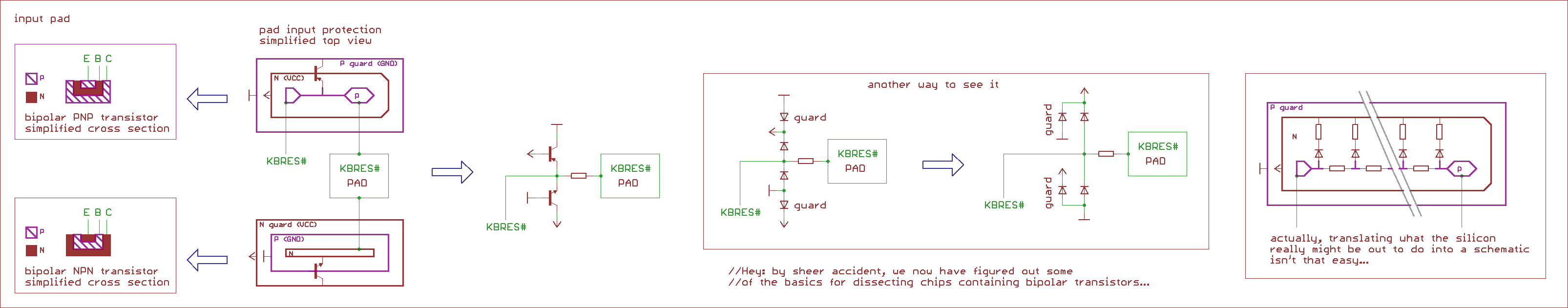

Now for the 5719 input pads.
In NMOS, input protection breaks down to having a resistor on diffusion layer
between the pad and a NMOS FET which switches to GND in case of a negative signal voltage,
before said signal enters the first inverter.
In the CMOS 5719, the game is a bit more difficult.
Let's take a look at the KBRES# pad.
North from the pad, we have "a PNP transistor",
with its base_emitter path switching the pad to VCC
in case if the voltage on the pad becomes higher than VCC.
//The base of that PNP transistor also works like a resistor between the pad
//and the input of the first inverter.
South from the pad, we have "a NPN transistor",
with its base_emitter path switching the pad to GND
in case if the voltage on the pad becomes lower than GND.
//That's negative voltage.
Note:
the signal from the pad goes through two inverters before it enters the circuitry inside the chip,
the inverters are just a little bit bigger than usual. So I'm ommiting them here.

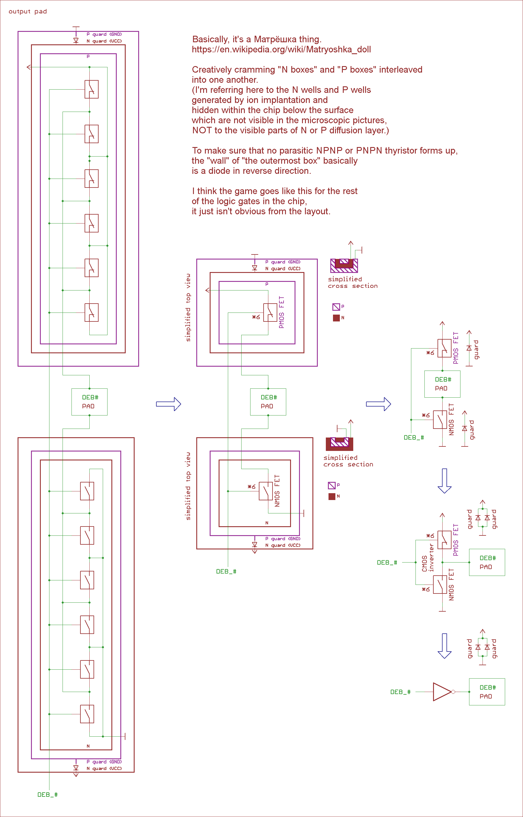

When considering the cross section of a chip, we don't just have
"a little N well here and a little P well there"
like in Bob Ross's "the joy of painting".
When considering the cross section of a chip (and not just the simplified top view),
the arrangement of N and P wells (ion implantation zones) inside the silicon
basically is a Матрёшка thing.
//picture is borrowed from Wikipedia.
Alternatively, you could imagine creatively cramming boxes labeled "N" and labeled "P"
interleaved into one another.
To make sure that no thyristor sneaks in, you need to prevent NPNP and PNPN sequences from forming up,
by creatively making the "wall" of the "outermost box" a diode in reverse direction (biased with GND and VCC).
That's basically the whole trick.
It's nicely visible in the circuitry around the input pads and around the output pads.
For the rest of the logic on the chip I think the game is pretty similar,
it just isn't obvious from the chip layout.

Now for the 5719 output pads,
we now focus on OEB# which has a push/pull output.
Means, that the output driver is switching OEB# eiher to GND or to VCC.
The FETs of the driver are quite big, and there is more than one to GND and VCC,
but basically the pad output driver is just an inverter.
The game of how and why cramming "N boxes" and "P boxes" interleaved into one another
and why making the "wall" of the "outermost box" a a diode in reverse direction
already went explained above in the text.
Note, that there is an inverter which just is bigger than usual
between the circuitry on the chip and the input of an output driver.
I'm just omitting it.

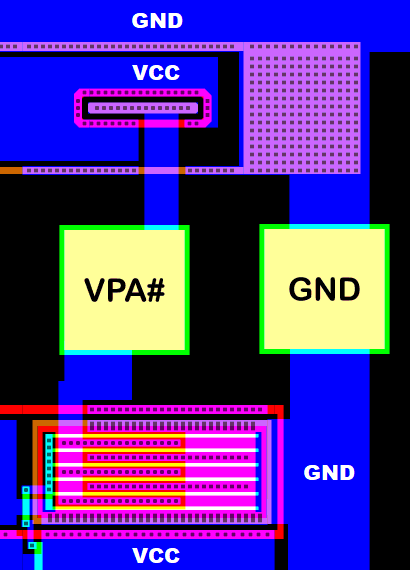

For "open collector" output pads which are only switching to GND,
like the VPA# pad,
we just creatively stick together
"the NMOS FET part of a push/pull output driver switching the pad to GND"
with "the PNP protection transistor of an input pad",
and that's all there is to it.

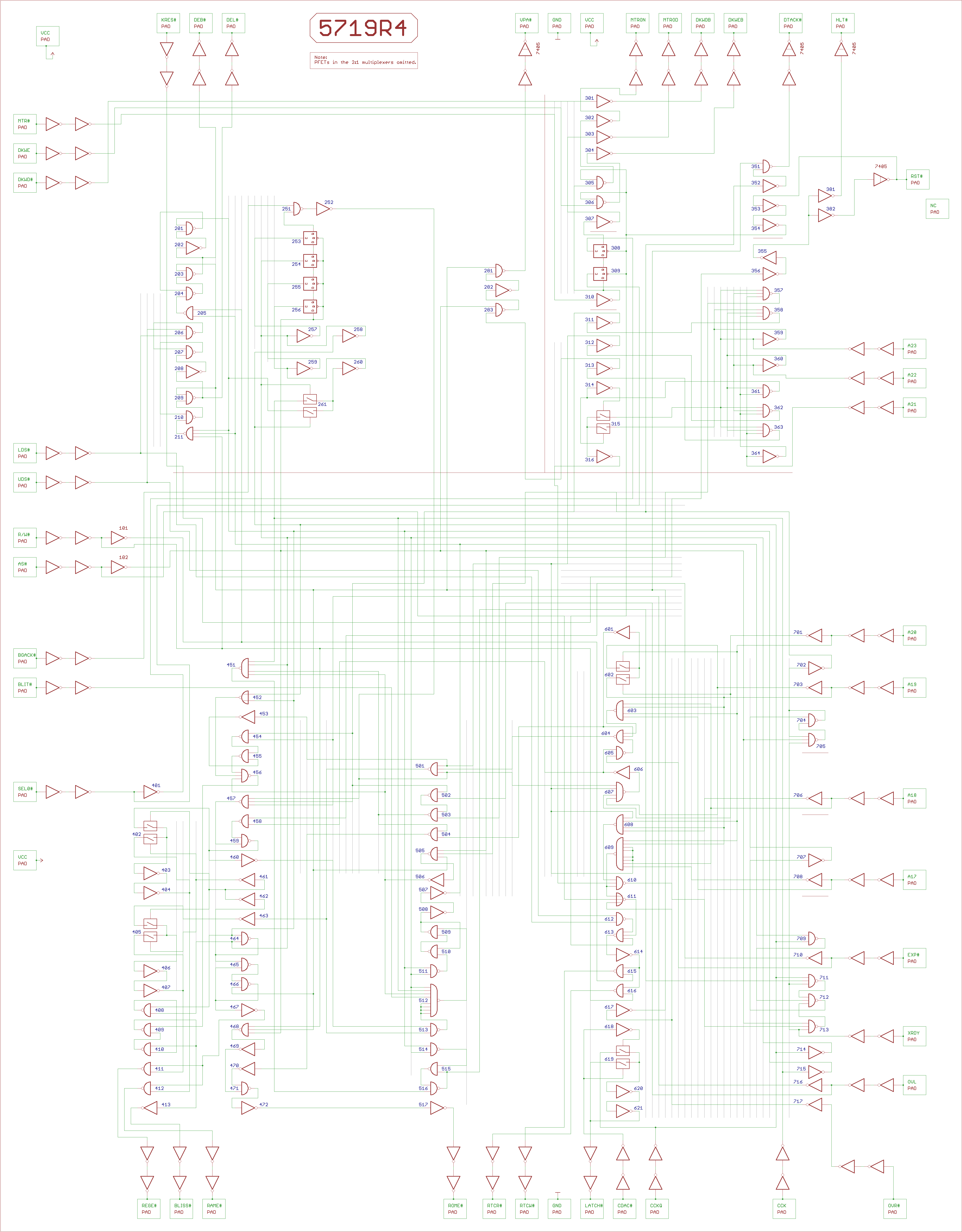

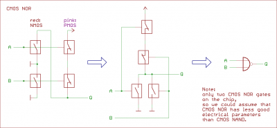

Now for the logic gates we have found in the chip.
The designers seemed to have used the "copy&paste" approach for building the logic gates,
means that identifying the logic gates is quite easy.
The layout of a gate sometimes is mirrored, rotated by 180°, or both.
//...But never by 90°.

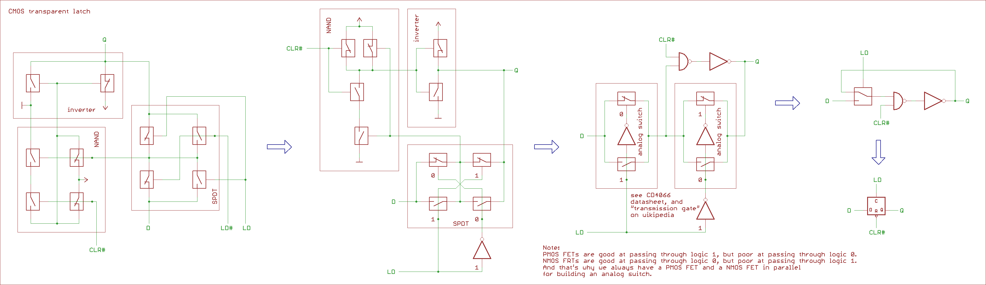

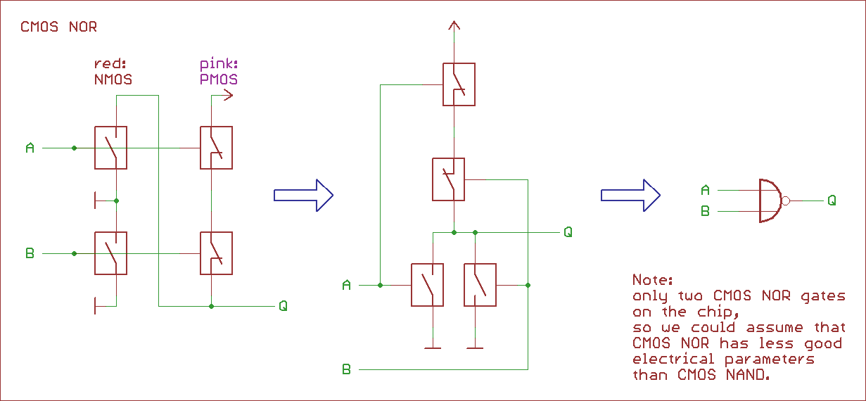

Most of the logic gates on the chip are NANDs,
there are quite some inverters,
there only are two NOR gates,
there are some transparent latches (every latch is built around a 2:1 multiplexer),
and there are three 2:1 multiplexers working as XOR gates.

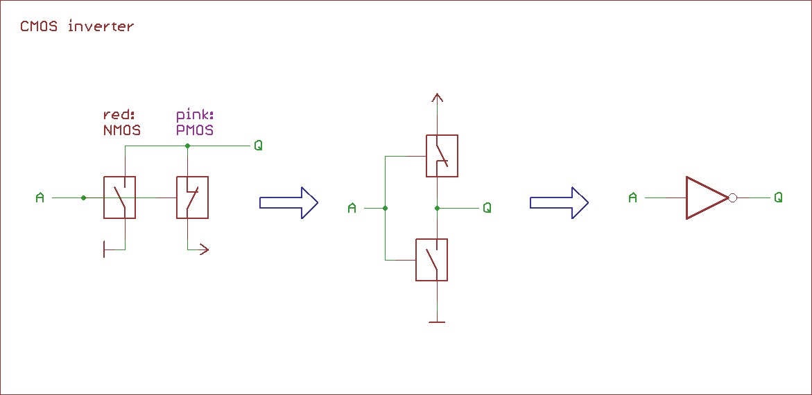

CMOS inverter is supposed to be simple:
One PMOS FET switching the output to VCC,
one NMOS FET switching the output to GND,
and that's it.

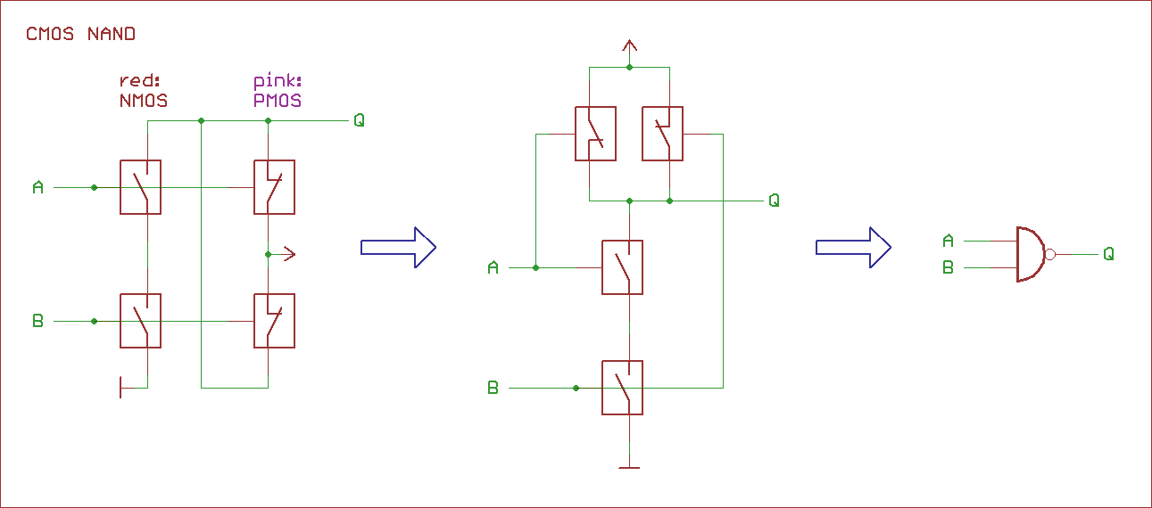

Post by ttlworks »
CMOS NAND,

CMOS NOR
Two PMOS FETs in series switching the output to VCC,
two NMOS FETs in parallel switching the output to GND.
Since most of the logic gates in the chip were NAND gates,
and there only were two NOR gates in the chip in total,
I think we can assume that CMOS NOR gates have worse
electrical characteristics than CMOS NAND gates.
