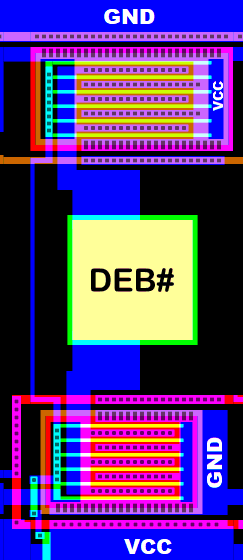

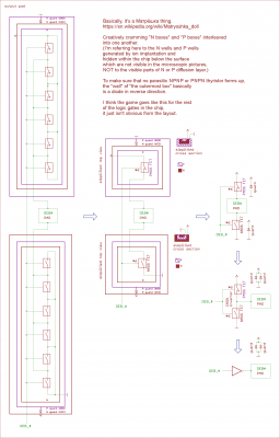

Now for the 5719 output pads,
we now focus on OEB# which has a push/pull output.
Means, that the output driver is switching OEB# eiher to GND or to VCC.
The FETs of the driver are quite big, and there is more than one to GND and VCC,
but basically the pad output driver is just an inverter.
The game of how and why cramming "N boxes" and "P boxes" interleaved into one another
and why making the "wall" of the "outermost box" a a diode in reverse direction
already went explained above in the text.
Note, that there is an inverter which just is bigger than usual
between the circuitry on the chip and the input of an output driver.
I'm just omitting it.

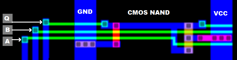

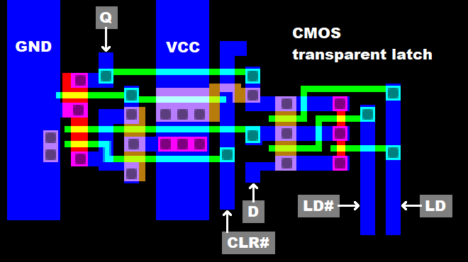

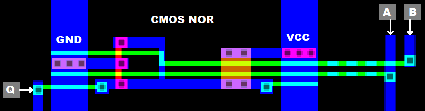

Now for the logic gates we have found in the chip.
The designers seemed to have used the "copy&paste" approach for building the logic gates,
means that identifying the logic gates is quite easy.
The layout of a gate sometimes is mirrored, rotated by 180°, or both.
//...But never by 90°.
Most of the logic gates on the chip are NANDs,
there are quite some inverters,
there only are two NOR gates,
there are some transparent latches (every latch is built around a 2:1 multiplexer),
and there are three 2:1 multiplexers working as XOR gates.

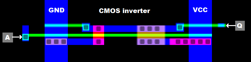

CMOS inverter is supposed to be simple:
One PMOS FET switching the output to VCC,
one NMOS FET switching the output to GND,
and that's it.

CMOS NAND,
we can imagine that it is based on the CMOS inverter.
Two PMOS FETs in parallel switching the output to VCC,
two NMOS FETs in series switching the output to GND.
I think, you can imagine how to build a NAND with more than two inputs.

CMOS NOR
Two PMOS FETs in series switching the output to VCC,
two NMOS FETs in parallel switching the output to GND.
Since most of the logic gates in the chip were NAND gates,
and there only were two NOR gates in the chip in total,
I think we can assume that CMOS NOR gates have worse
electrical characteristics than CMOS NAND gates.

CMOS transparent latch
It consists of a NAND gate, an inverter, and a 2:1 multiplexer.
Electrically, we can see the 2:1 multiplexer as an "analog SPDT switch".
Actually, said "analog SPDT switch" is built from two transmission gates.
//Also, please take a look at the CD4066 datasheet.
One transmission gate is built from a NMOS FET plus a PMOS FET switching in parallel,
and that's because:
PMOS FETS are good in passing through logic 1, but poor in passing through logic 0.
NMOS FETs are good in passing through logic 0, but poor in passing through logic 1.
However:
PMOS FET needs logic 0 at its gate for switching through,
NMOS FET needs logic 1 at its gate for switching through,
and that's why we need a high_active LD and a low_active LD# signal for controlling the latch.
