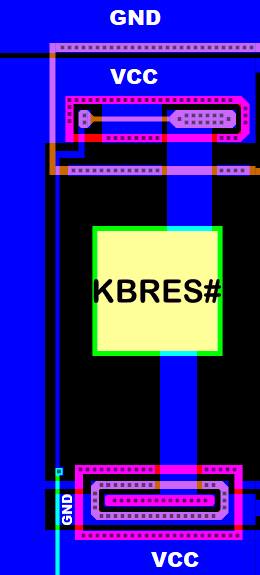

Now for the 5719 input pads.
In NMOS, input protection breaks down to having a resistor on diffusion layer
between the pad and a NMOS FET which switches to GND in case of a negative signal voltage,
before said signal enters the first inverter.
In the CMOS 5719, the game is a bit more difficult.
Let's take a look at the KBRES# pad.
North from the pad, we have "a PNP transistor",
with its base_emitter path switching the pad to VCC
in case if the voltage on the pad becomes higher than VCC.
//The base of that PNP transistor also works like a resistor between the pad
//and the input of the first inverter.
South from the pad, we have "a NPN transistor",
with its base_emitter path switching the pad to GND
in case if the voltage on the pad becomes lower than GND.
//That's negative voltage.
Note:
the signal from the pad goes through two inverters before it enters the circuitry inside the chip,
the inverters are just a little bit bigger than usual. So I'm ommiting them here.
