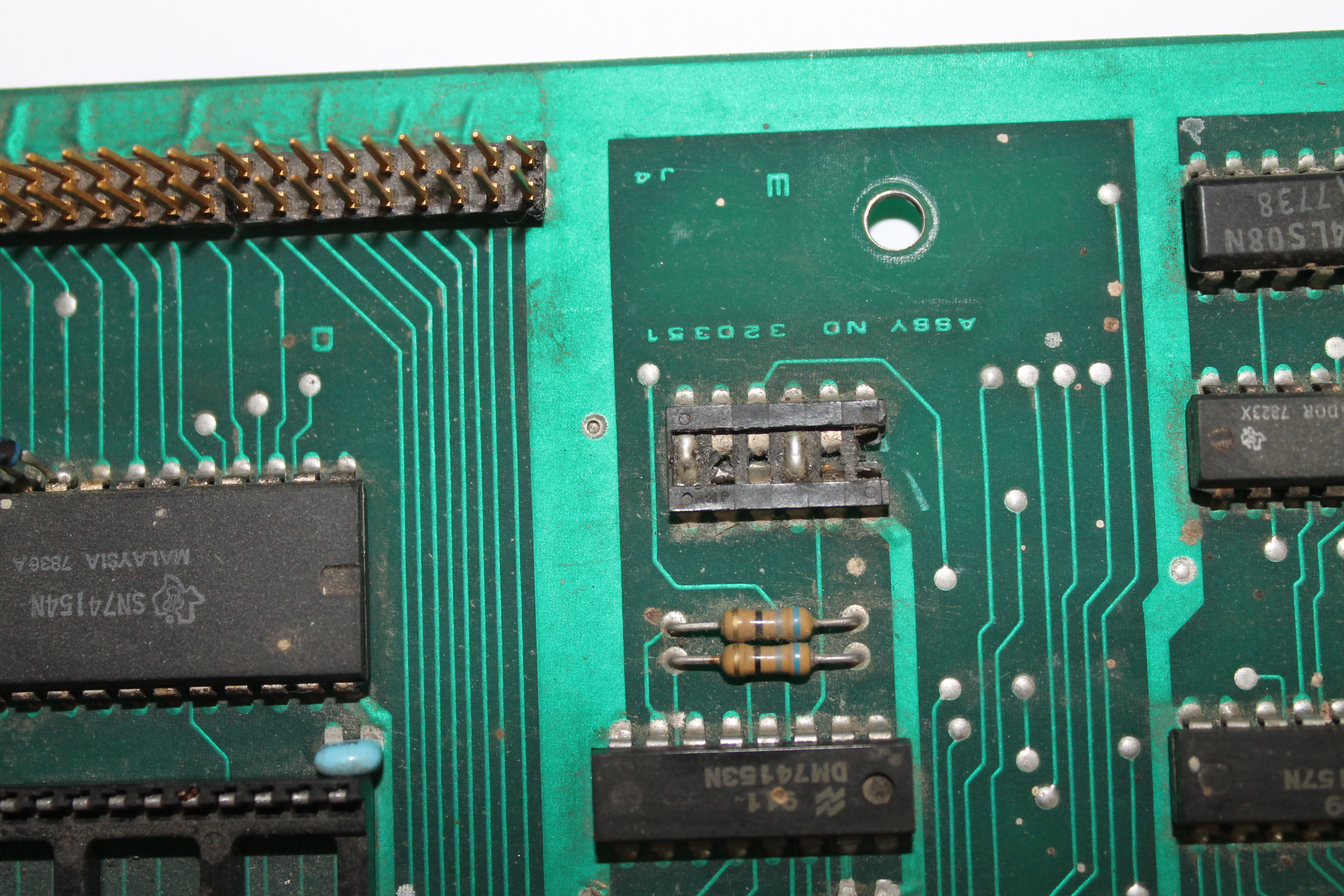

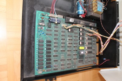

Hello Guys,

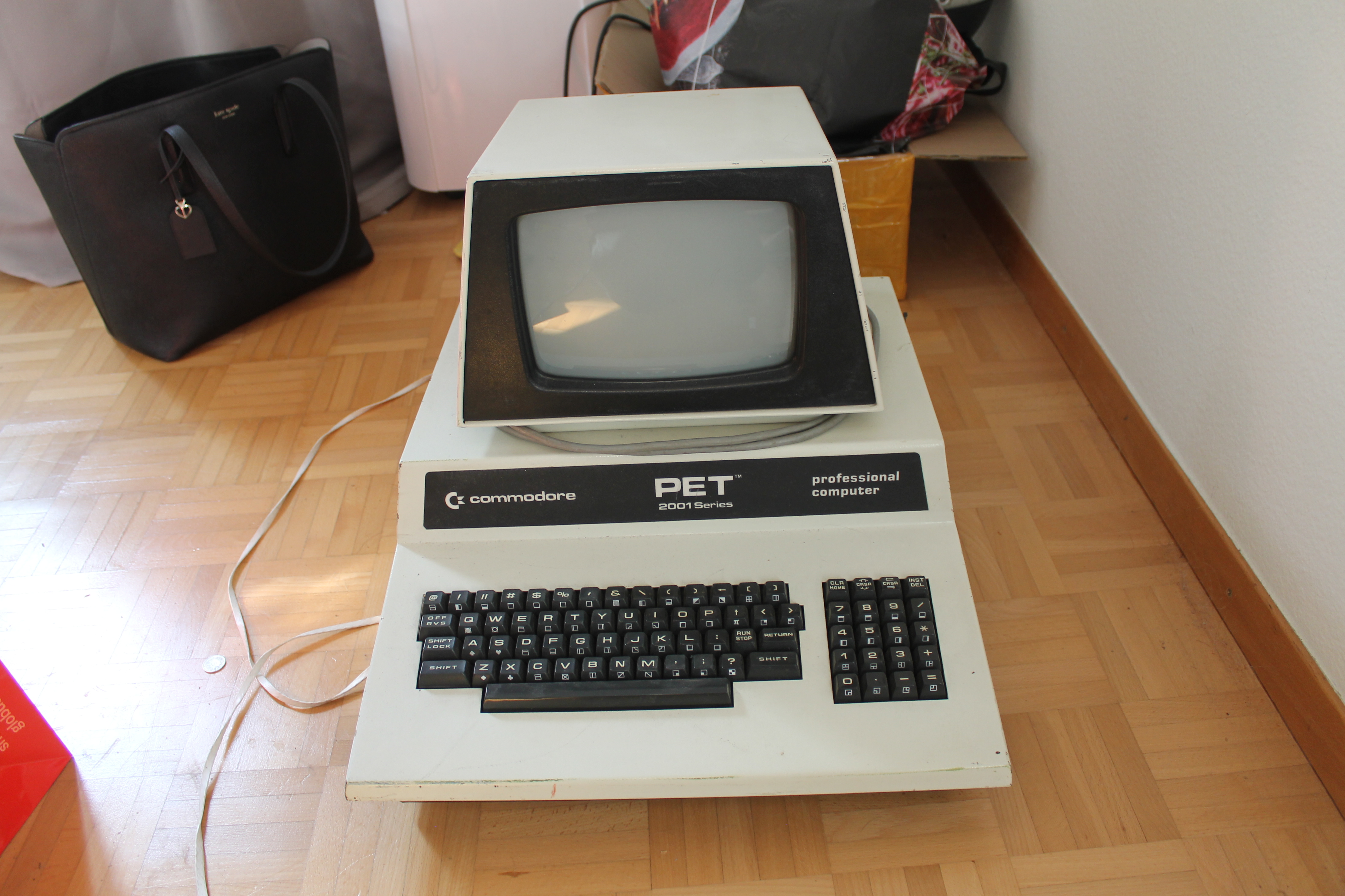

I was pointed towards this forum from Reddit. I have purchased a Commodore PET 2001-16. Sadly it is not fully working.

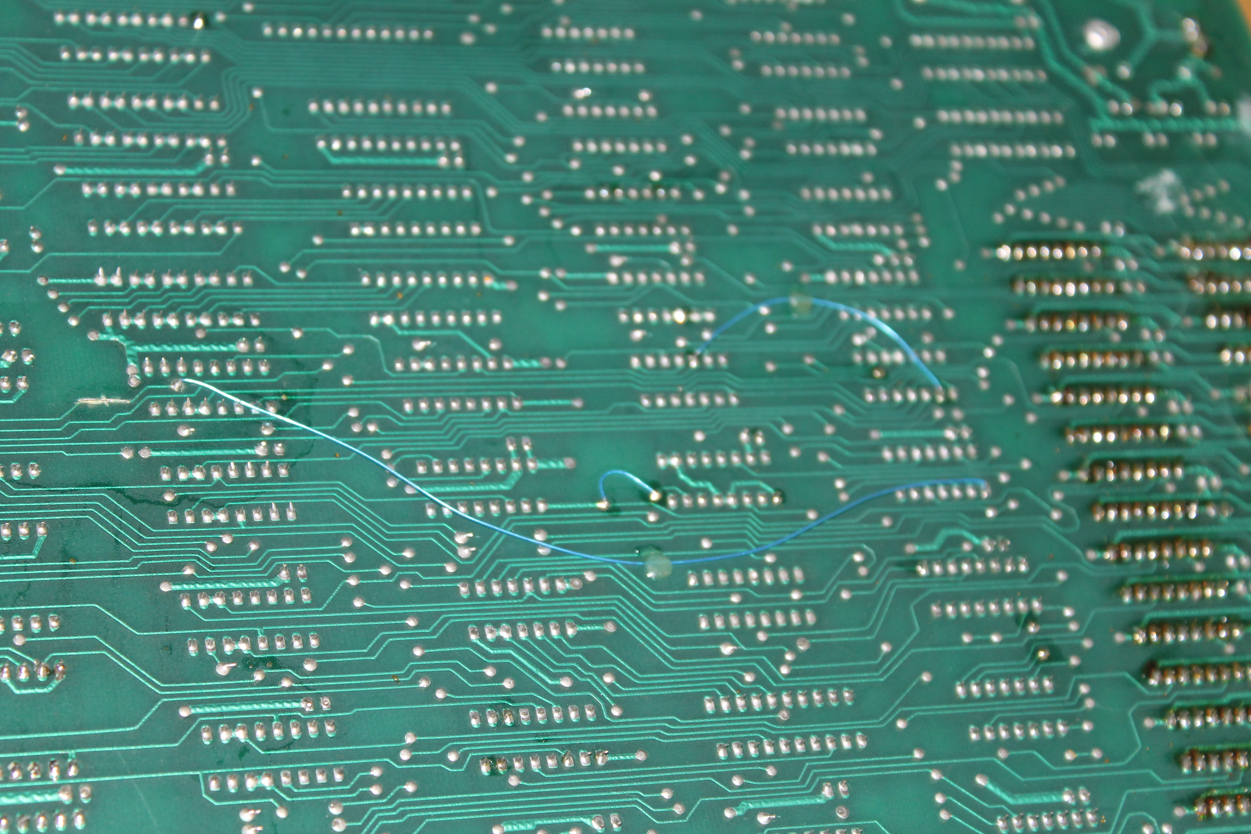

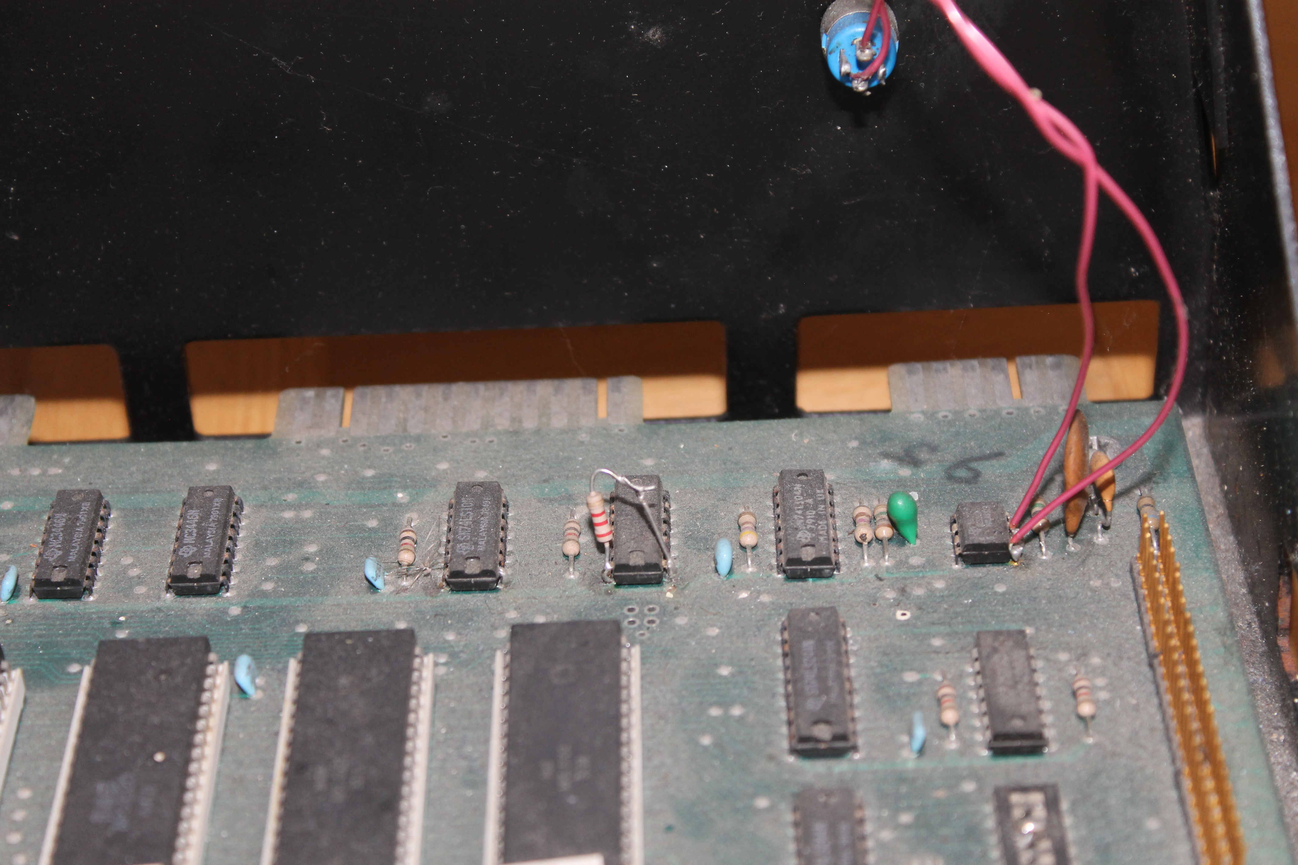

I have taken it apart and i see tons of modifications, like jumper cables running on the back of the board. I dont think i have a way to actually find out what these fixes do, so I think my best course of action is to reverse all the "fixes" and start the trouble shooting from there. Then, actually fix it instead of running these jumper cables. Is this the correct course of action?
I dont really have any experience with these sorts of computers but i saw one close by selling online for 200$ so i bought it. And now i will repair it and make it work again.
i am very open to buying modern parts Like these http://www.dasarodesigns.com/product/mp ... 3-version/ as long as they dont permanently stop me from making it original as possible if i by chance find original parts.
https://imgur.com/a/dqFy3in These are the pictures my machine and a short video of the issue im experiencing.
Thanks a million for any input, im really just worried about starting out with no real plan.
edit: im gonna add pictures of the back of the board later, where the jumper wires are run.

Thirdly, some of those patches look like they may have been done when the machine was manufactured. As Garth noted, that is not-uncommon, especially on machines of your PET's vintage. I would not disturb any of them at this time.

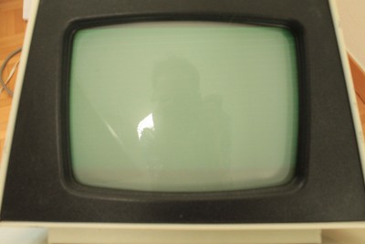

Are you seeing any signs of a raster on the screen?

If i turn up the brightness setting on the back, i think see rastering. I see faint horizontal lines/bars and i think someone referred to this as rastering in a youtube video I watched.

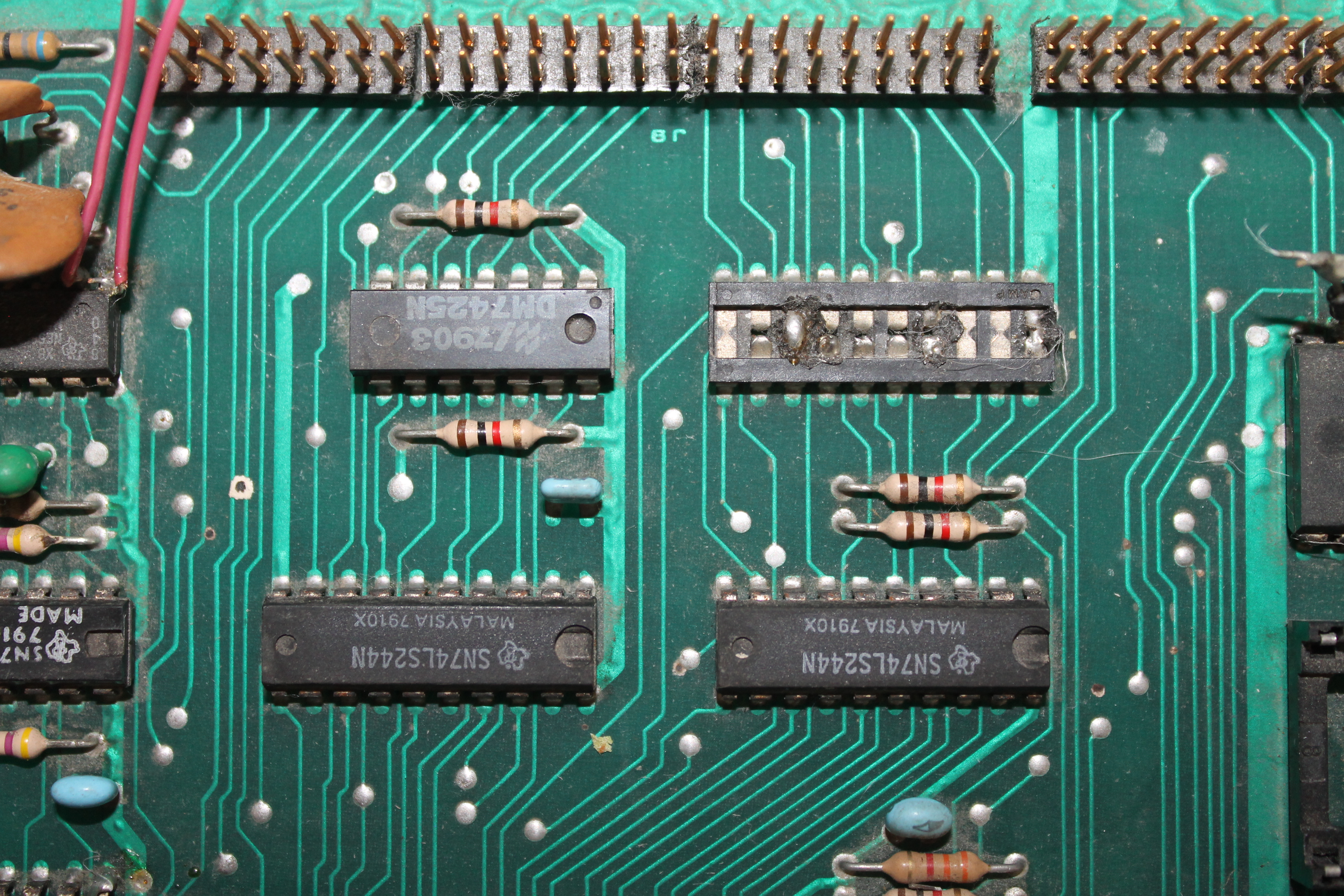

Hi again, im posting a picture of the screen brightness turned all the way up.

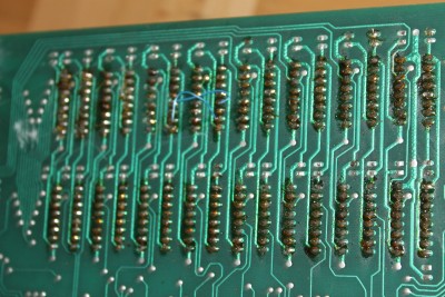

im also posting a picture of the back side wires, plus an other wire jumper on what i presume are the RAM chips.
im happy to provide any sort of pictures that will help trouble shooting.
In the original link I shared to pictures, ive added a bunch more
Thank you for the warm welcome!

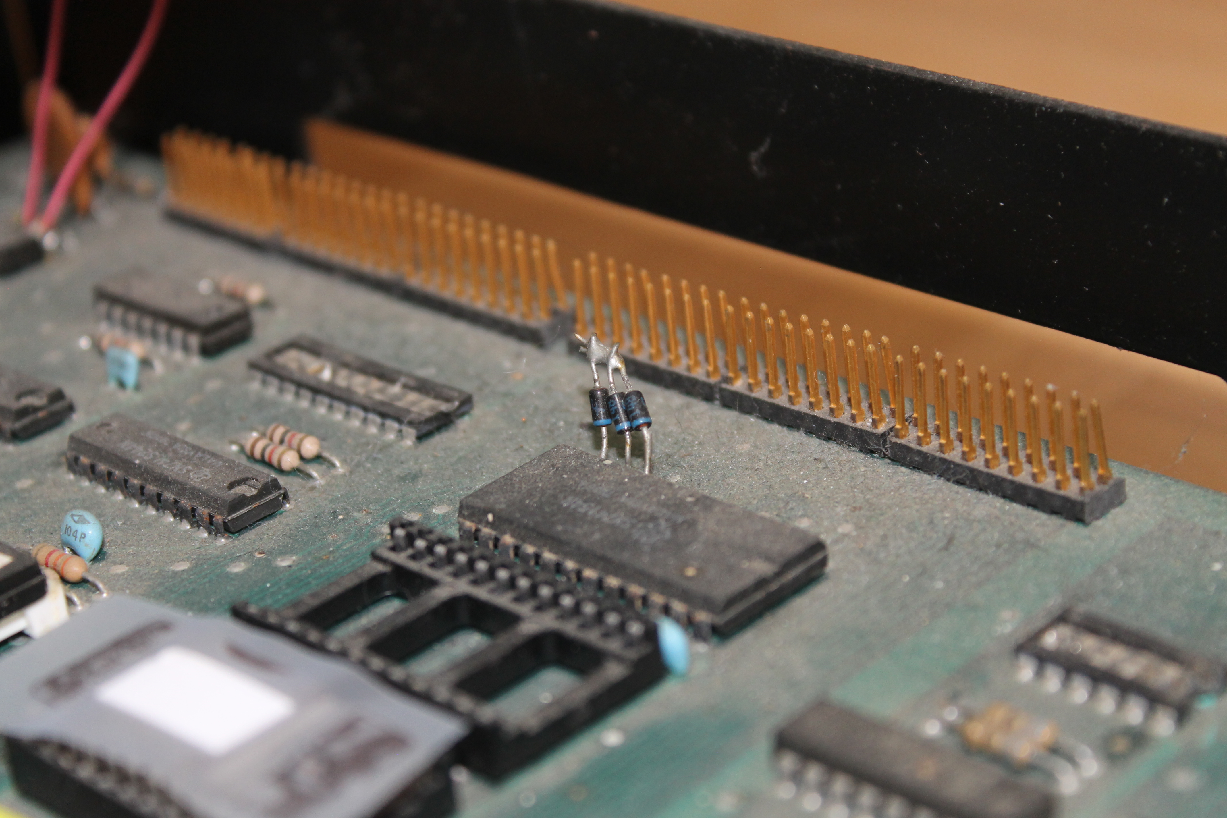

Re: Bought a PET - Not working ^^
To my amateur eyes, that screen looks correct for drawing a blank screen.

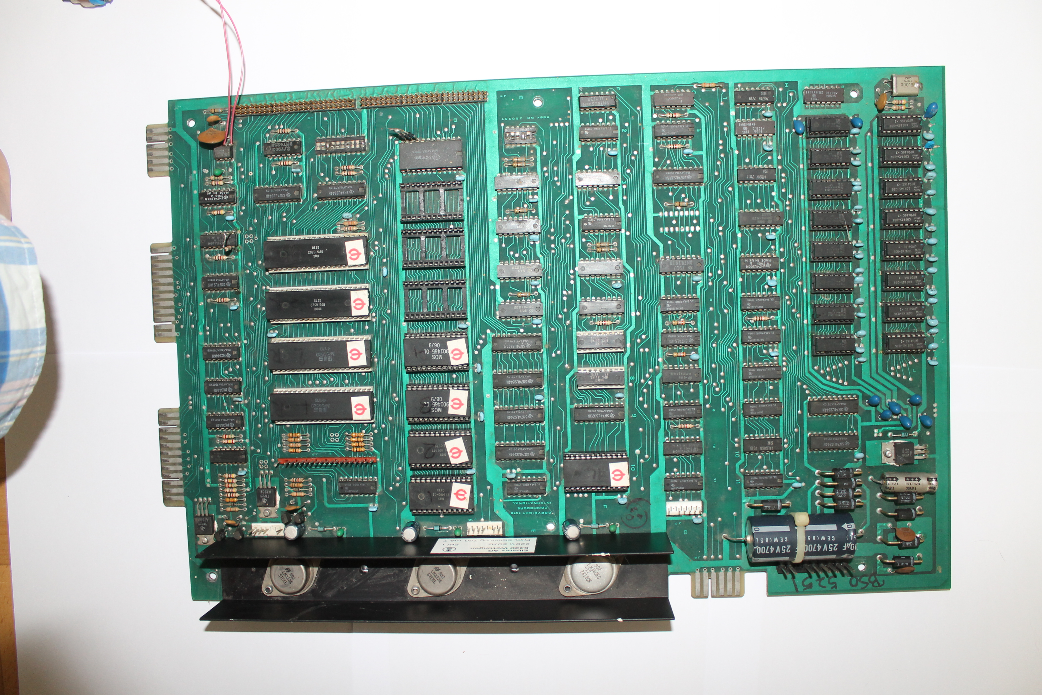

Time to check the computer side of things, is the clock working, is the CPU stuck in reset, do the address/data lines look good, that type of thing.
The main board bodge wires look like factory fixes, or are VERY well done repairs.
The RAM chips look like someone has attempted to reflow all of the chips and not cleaned up their flux. The bodge wires look fine, but someone thought the RMA was the issue and didn't do the neatest job with resoldering all of the chips.
Edit: Looking at the first post, someone socketed all of the RAM chips rather than reflowed, but it's still a messy job.

The raster is pretty dim and the vertical sweep rate appears to be out of sync. Do you know if this is a PAL or NTSC PET?
Meanwhile, you or someone who is skilled in the art needs to start poking around with a logic probe to see if the 6502 is alive. A check needs to be made for an input clock and that the 6502 is generating clock at its two outputs. I would make those checks before anything else. If there is no clock nothing will work.
Could it be that's a RAM upgrade and not a repair ?
2 full banks of 16x1 chips making 32k, but the first post says its a 2001-16 system.

The main voltages should be present on the 4 corners of the ram chips.
The 4116 family have
Pin 1 @ -5v
Pin 8 @ 12v
Pin 9 @ 5v
Pin 16 ground
