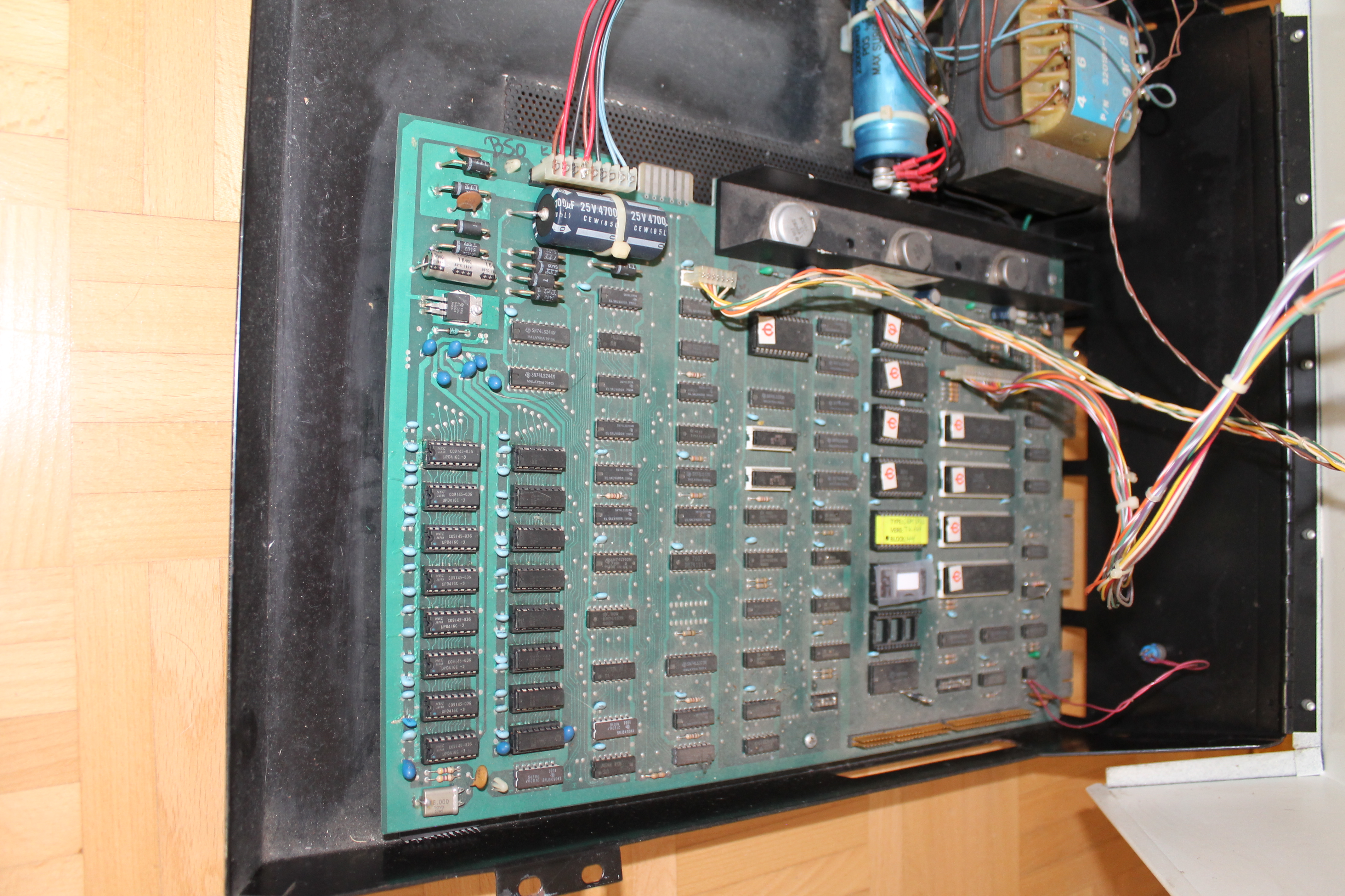

Hello Guys,
I was pointed towards this forum from Reddit. I have purchased a Commodore PET 2001-16. Sadly it is not fully working.
I have taken it apart and i see tons of modifications, like jumper cables running on the back of the board. I dont think i have a way to actually find out what these fixes do, so I think my best course of action is to reverse all the "fixes" and start the trouble shooting from there. Then, actually fix it instead of running these jumper cables. Is this the correct course of action?
I dont really have any experience with these sorts of computers but i saw one close by selling online for 200$ so i bought it. And now i will repair it and make it work again.
i am very open to buying modern parts Like these http://www.dasarodesigns.com/product/mps-6540-commodore-pet-2001-rom-adapter-obsolete-rev-3-version/ as long as they dont permanently stop me from making it original as possible if i by chance find original parts.
https://imgur.com/a/dqFy3in These are the pictures my machine and a short video of the issue im experiencing.
Thanks a million for any input, im really just worried about starting out with no real plan.
edit: im gonna add pictures of the back of the board later, where the jumper wires are run.

File comment: A picture of the Board inside the machine. The yellow sticker noted TYPE: CBM 3032

Commodore_PET wrote:
Hello Guys,
Mike Naberezny probably knows more about PETs than the rest of us, so hopefully he will jump it. I would definitely not go removing jumpers right away though. In many cases, products were sold that way brand new, rather than the manufacturer taking the long delays and high costs of re-doing a board after a problem showed up or a part became unavailable and they had to adapt to a different one.
Firstly, welcome.
Secondly, you can attach images to your posts here.
Thirdly, some of those patches look like they may have been done when the machine was manufactured. As Garth noted, that is not-uncommon, especially on machines of your PET's vintage. I would not disturb any of them at this time.
All-in-one units such as the PET can fail to operate due to a fault in the computer part of the circuit, a fault in the video circuitry or a failed CRT. A logic probe can assist in determining if you've got microprocessor activity going on and if appropriate control and bus signals are being generated.
Are you seeing any signs of a raster on the screen?
If i turn up the brightness setting on the back, i think see rastering. I see faint horizontal lines/bars and i think someone referred to this as rastering in a youtube video I watched.
Normally, raster with no input signal to the vertical deflection circuits would paint the screen a uniform green (in the case of a PET) and would be fairly bright if the brightness is all the way up. Your description sounds like a possible failure in the horizontal deflection circuits. My money would be on the flyback transformer.

To my amateur eyes, that screen looks correct for drawing a blank screen.
Time to check the computer side of things, is the clock working, is the CPU stuck in reset, do the address/data lines look good, that type of thing.
The main board bodge wires look like factory fixes, or are VERY well done repairs.
The RAM chips look like someone has attempted to reflow all of the chips and not cleaned up their flux. The bodge wires look fine, but someone thought the RMA was the issue and didn't do the neatest job with resoldering all of the chips.
Edit: Looking at the first post, someone socketed all of the RAM chips rather than reflowed, but it's still a messy job.
Hi again, im posting a picture of the screen brightness turned all the way up.
im also posting a picture of the back side wires, plus an other wire jumper on what i presume are the RAM chips.
The bodge wiring in that first pic is definitely a Commodore modification—repairs usually don't go to the extent of bonding the wires to the PCB with adhesive. Can't really tell for certain in the second pic.
The raster is pretty dim and the vertical sweep rate appears to be out of sync. Do you know if this is a PAL or NTSC PET?
Meanwhile, you or someone who is skilled in the art needs to start poking around with a logic probe to see if the 6502 is alive. A check needs to be made for an input clock and that the 6502 is generating clock at its two outputs. I would make those checks before anything else. If there is no clock nothing will work.
Do I have to deal with the bad soldering of the RAM sockets or is that something that can wait?
I wouldn't deal with it at all -- I don't think the soldering is bad. It only looks different because the flux hasn't been cleaned off.
However, it *is* a bit worrisome that somebody has apparently attempted a repair. Was that a successful attempt, far in the past? Or a recent attempt that failed? (But either way, we can only go forward and try to learn what we can.)
Im looking into buying:
ROM/RAM replacement board for Commodore PET (including a working and tested 6502 processor)
This is greatly premature, IMO. Troubleshooting begins by checking several simple, basic things. For example, BDD mentioned the clock signal. Even more basic is the power supply. There should be 5 volts present on the main board (also 12 volts?), and you can check this with any voltmeter.

Could it be that's a RAM upgrade and not a repair ?
2 full banks of 16x1 chips making 32k, but the first post says its a 2001-16 system.
