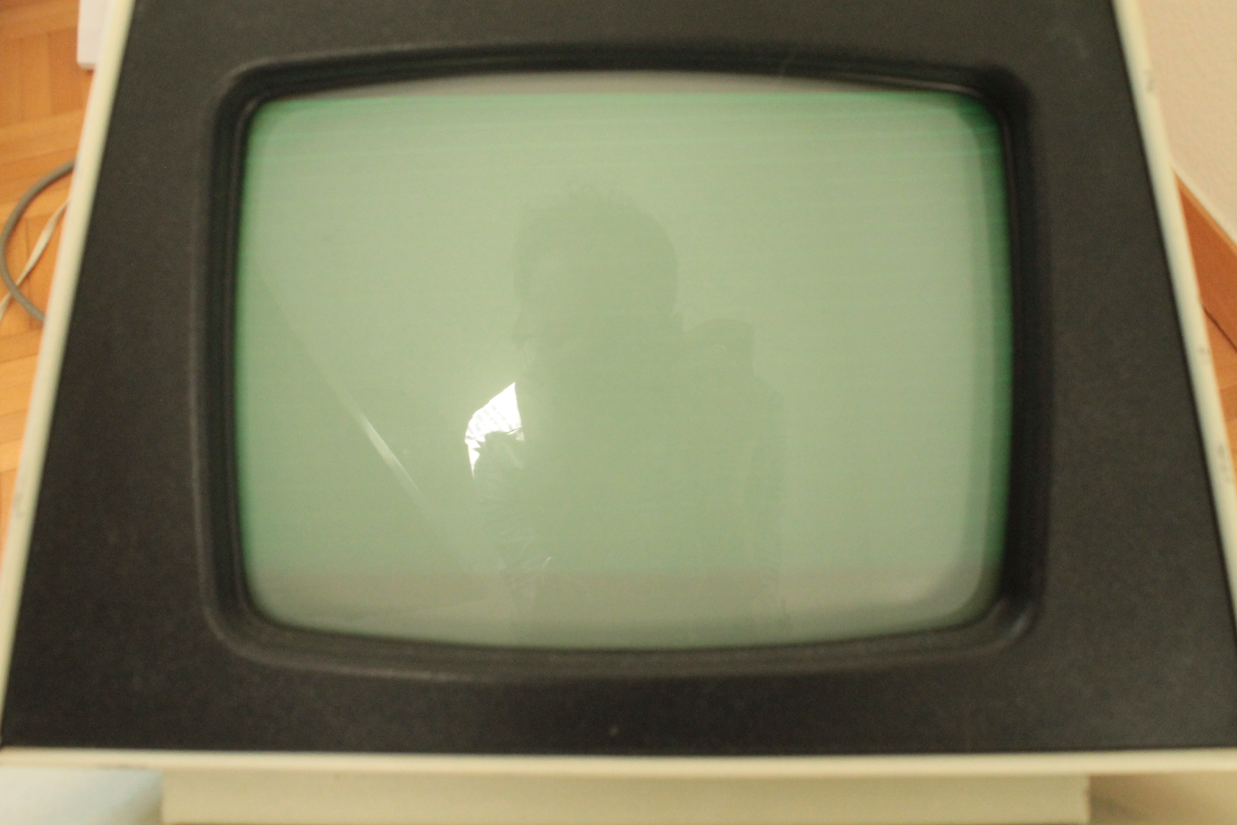

If i turn up the brightness setting on the back, i think see rastering. I see faint horizontal lines/bars and i think someone referred to this as rastering in a youtube video I watched.
Normally, raster with no input signal to the vertical deflection circuits would paint the screen a uniform green (in the case of a PET) and would be fairly bright if the brightness is all the way up. Your description sounds like a possible failure in the horizontal deflection circuits. My money would be on the flyback transformer.

Hi again, im posting a picture of the screen brightness turned all the way up.

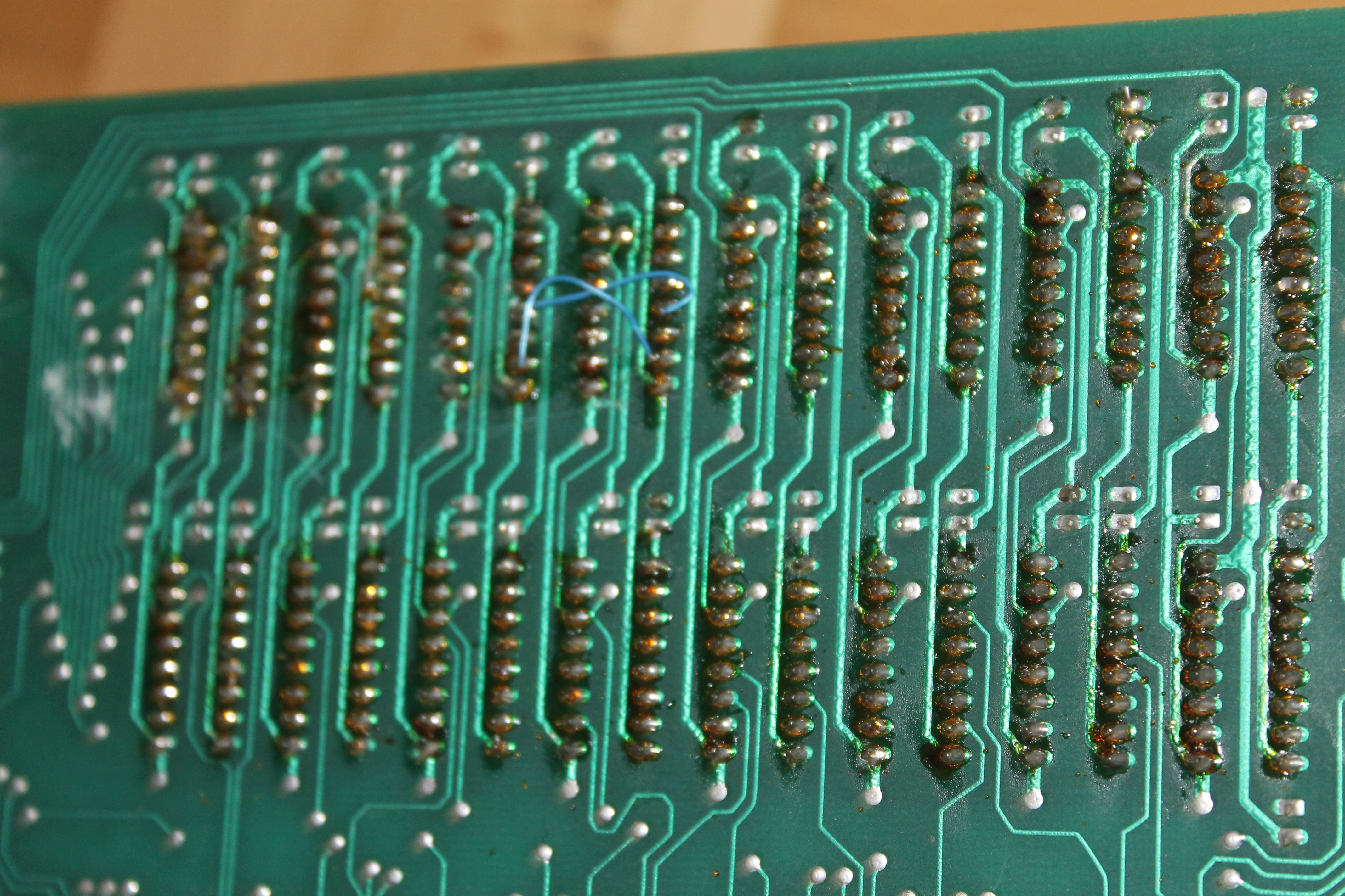

im also posting a picture of the back side wires, plus an other wire jumper on what i presume are the RAM chips.

File comment: This is the image of the back side of the RAM chips with some questioning soldering and a wire run between two.
File comment: This is what i see when i turn up the brightness to max.

To my amateur eyes, that screen looks correct for drawing a blank screen.
Time to check the computer side of things, is the clock working, is the CPU stuck in reset, do the address/data lines look good, that type of thing.
The main board bodge wires look like factory fixes, or are VERY well done repairs.
The RAM chips look like someone has attempted to reflow all of the chips and not cleaned up their flux. The bodge wires look fine, but someone thought the RMA was the issue and didn't do the neatest job with resoldering all of the chips.
Edit: Looking at the first post, someone socketed all of the RAM chips rather than reflowed, but it's still a messy job.

The bodge wiring in that first pic is definitely a Commodore modification—repairs usually don't go to the extent of bonding the wires to the PCB with adhesive. Can't really tell for certain in the second pic.
The raster is pretty dim and the vertical sweep rate appears to be out of sync. Do you know if this is a PAL or NTSC PET?

Do I have to deal with the bad soldering of the RAM sockets or is that something that can wait?
I wouldn't deal with it at all -- I don't think the soldering is bad. It only looks different because the flux hasn't been cleaned off.
However, it *is* a bit worrisome that somebody has apparently attempted a repair. Was that a successful attempt, far in the past? Or a recent attempt that failed? (But either way, we can only go forward and try to learn what we can.)

Could it be that's a RAM upgrade and not a repair ?
2 full banks of 16x1 chips making 32k, but the first post says its a 2001-16 system.
