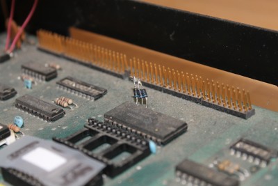

Hello Guys,
I was pointed towards this forum from Reddit. I have purchased a Commodore PET 2001-16. Sadly it is not fully working.
I have taken it apart and i see tons of modifications, like jumper cables running on the back of the board. I dont think i have a way to actually find out what these fixes do, so I think my best course of action is to reverse all the "fixes" and start the trouble shooting from there. Then, actually fix it instead of running these jumper cables. Is this the correct course of action?
I dont really have any experience with these sorts of computers but i saw one close by selling online for 200$ so i bought it. And now i will repair it and make it work again.
i am very open to buying modern parts Like these http://www.dasarodesigns.com/product/mps-6540-commodore-pet-2001-rom-adapter-obsolete-rev-3-version/ as long as they dont permanently stop me from making it original as possible if i by chance find original parts.
https://imgur.com/a/dqFy3in These are the pictures my machine and a short video of the issue im experiencing.
Thanks a million for any input, im really just worried about starting out with no real plan.
edit: im gonna add pictures of the back of the board later, where the jumper wires are run.

File comment: A picture of a modification

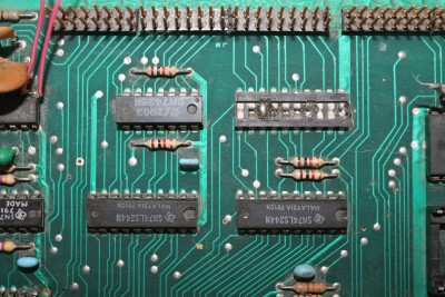

File comment: A picture of two of the modifications

PostPosted: Wed May 20, 2020 8:09 pm
Posts: 8534
Welcome!
Commodore_PET wrote:
Hello Guys,
Mike Naberezny probably knows more about PETs than the rest of us, so hopefully he will jump it. I would definitely not go removing jumpers right away though. In many cases, products were sold that way brand new, rather than the manufacturer taking the long delays and high costs of re-doing a board after a problem showed up or a part became unavailable and they had to adapt to a different one.

PostPosted: Wed May 20, 2020 9:18 pm
Posts: 8468
Firstly, welcome.
Secondly, you can attach images to your posts here.
Thirdly, some of those patches look like they may have been done when the machine was manufactured. As Garth noted, that is not-uncommon, especially on machines of your PET's vintage. I would not disturb any of them at this time.
All-in-one units such as the PET can fail to operate due to a fault in the computer part of the circuit, a fault in the video circuitry or a failed CRT. A logic probe can assist in determining if you've got microprocessor activity going on and if appropriate control and bus signals are being generated.
Are you seeing any signs of a raster on the screen?
Hi again, im posting a picture of the screen brightness turned all the way up.
im also posting a picture of the back side wires, plus an other wire jumper on what i presume are the RAM chips.
The bodge wiring in that first pic is definitely a Commodore modification—repairs usually don't go to the extent of bonding the wires to the PCB with adhesive. Can't really tell for certain in the second pic.
