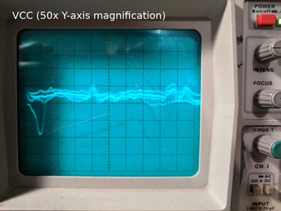

I got it under the scope. The signals look quite a lot cleaner than I was expecting. The clock looks great to me, and the ripples visible give me confidence in the fidelity of the scope, which, like I say, is pretty beaten.
The failure of R/W is clearly visible as it is pulled back towards 5V part way through a cycle.
Vcc looks pretty stable. Examining it at 10x X-axis zoom, and 50x Y-axis (relative to the other photos), I was able to look back and forth across the whole 10x magnified time range and the photo is of the portion showing the most variation. But at 50x zoom, it's showing a fluctuation of 100 to 150mV. Does that seems plausible to trigger brown-out?
I haven't had chance to do the schematic tonight. I'm semi-asking, semi-blogging my investigation here to get pointers, but also to help organise my thoughts. Thanks for listening.

The strange glitches on RWB looks as if there is a capacitive coupling from somewhere. Do you have a capmeter that can measure down to 100 pF? If, I would turn off power and measure RWB against any other signal. There ought to be no capacitive load anywhere but you may find an exception. Perhaps an ill placed blocking C.

I suggest you use the scope to examine the waveforms on the Gnd and +5 pins of all your IC's -- be sure to probe the pin itself. This is to rule out the possibility of a poor connection from the IC pin to the Gn / +5 rails of the breadboard.
