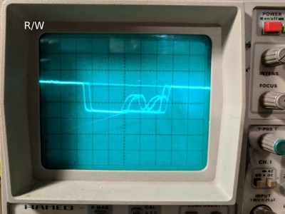

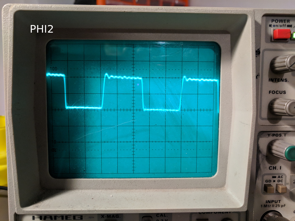

I got it under the scope. The signals look quite a lot cleaner than I was expecting. The clock looks great to me, and the ripples visible give me confidence in the fidelity of the scope, which, like I say, is pretty beaten.
The failure of R/W is clearly visible as it is pulled back towards 5V part way through a cycle.

File comment: Vcc
File comment: RW
File comment: PHI2

The strange glitches on RWB looks as if there is a capacitive coupling from somewhere. Do you have a capmeter that can measure down to 100 pF? If, I would turn off power and measure RWB against any other signal. There ought to be no capacitive load anywhere but you may find an exception. Perhaps an ill placed blocking C.

What's the bandwidth of the 'scope? If it's fairly low (say, 50 MHz or less) then the waveforms probably have some "dirt" which simply isn't displayed.
Maybe the CPU can't reliably pull R/W low because it doesn't have a reliable connection to "low" ie, Ground. I admit it's kind of a goofy theory, but I do wonder if a bad connection may play a role here.
I suggest you use the scope to examine the waveforms on the Gnd and +5 pins of all your IC's -- be sure to probe the pin itself. This is to rule out the possibility of a poor connection from the IC pin to the Gn / +5 rails of the breadboard.
Along with a schematic, it might be helpful to see a recent photo of your project.

What I would normally do is put the phi2 signal on one channel and the R/W on the other and trigger off the Phi2. All bus operations on the 6502 depend on Phi2, so most timing measurements should be made WRT to it.
Also, if you needed to see the relationship between 2 signals, such as R/W and a chip select, you could scope them against each other. You could also feed Phi 2 into the external trigger and see how those 2 signals line up with Phi2.

That RnW waveform is very odd indeed. It almost looks like there are two drivers fighting each other: RnW twice is driven positive, but not to the rail.
So, you need to review your design, and your implementation. Something isn't right.
