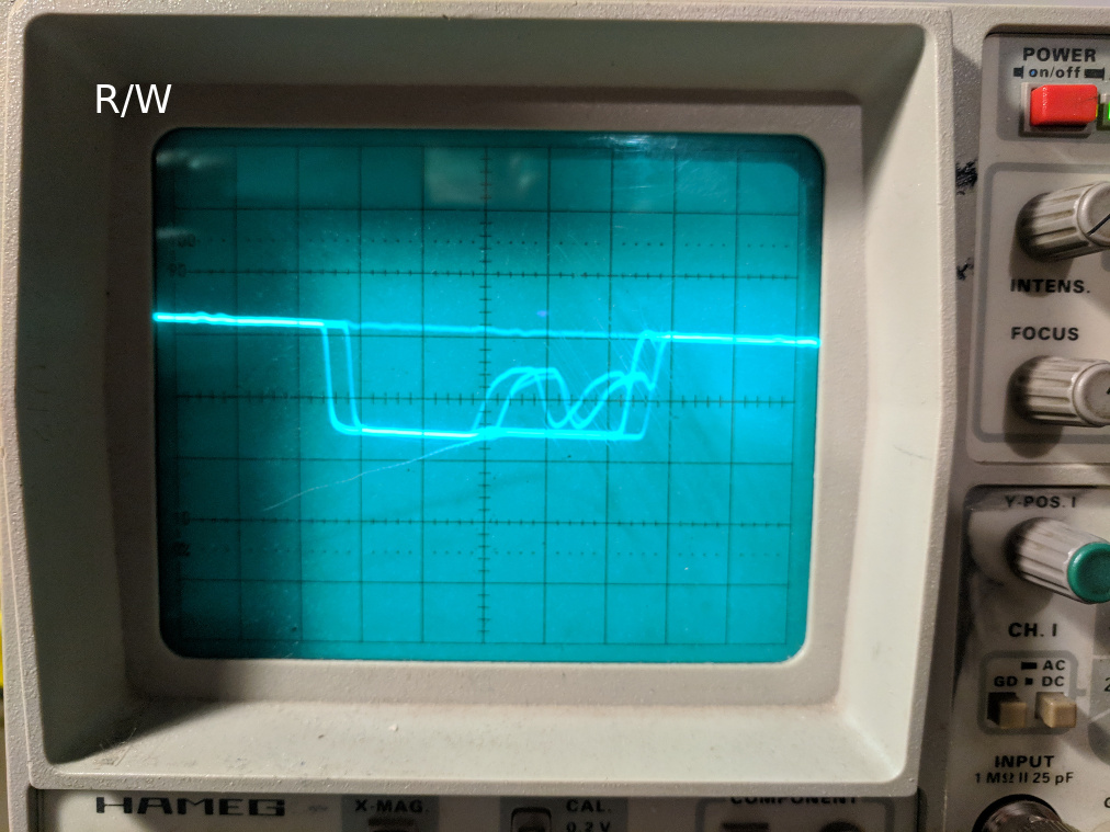

I can successfully write to my serial port, but the majority of what is written is garbage. In fact, it's 0xFF.
Looking with the logic probe, I can see that for the majority of write cycles, the R/W line (wired directly from the 6502 to both the SRAM /WE pin and ACIA R/W pin) is only asserted for the first part of the cycle (PHI2 low). My chip select lines only go low when PHI2 rises, and when it does, 70 or 80% of the time, R/W goes high with it, as do all of the data lines, which held the correct value to be written during the first half of the cycle. This happens when writing to either RAM or the ACIA, though it seems to be worse with the ACIA.
I realise a more detailed schematic will probably be required for full diagnosis, but I need to go back over it and check it against the reality of what I have soldered down before it's worth sharing, so I thought I'd describe the symptoms in case there are any avenues of investigation which can be suggested from that alone.

R/W is a signal I usually write as RnW, and should go low to cause a write. To avoid writing to the wrong location, when the address lines and chip selects might still be holding the previous cycle's value, or be changing, it's normal to arrange the glue logic so that RnW can only go low when Phi2 is high.
Does it seem that your design is instead allowing RnW to go low only when Phi2 is low? That would be unexpected, and probably wrong.
It's extremely weird for R/W to change state midway through the cycle. It's as if the CPU had been reset. Maybe /RES goes low and/or the VCC supply experiences a brownout at this point -- as it may do when bus contention arises, or when the output of a logic gate (a decoder, perhaps?) tries to drive low into a line that is shorted high (or tries to drive high into a line that is shorted low). Can you monitor VCC with an oscilloscope?

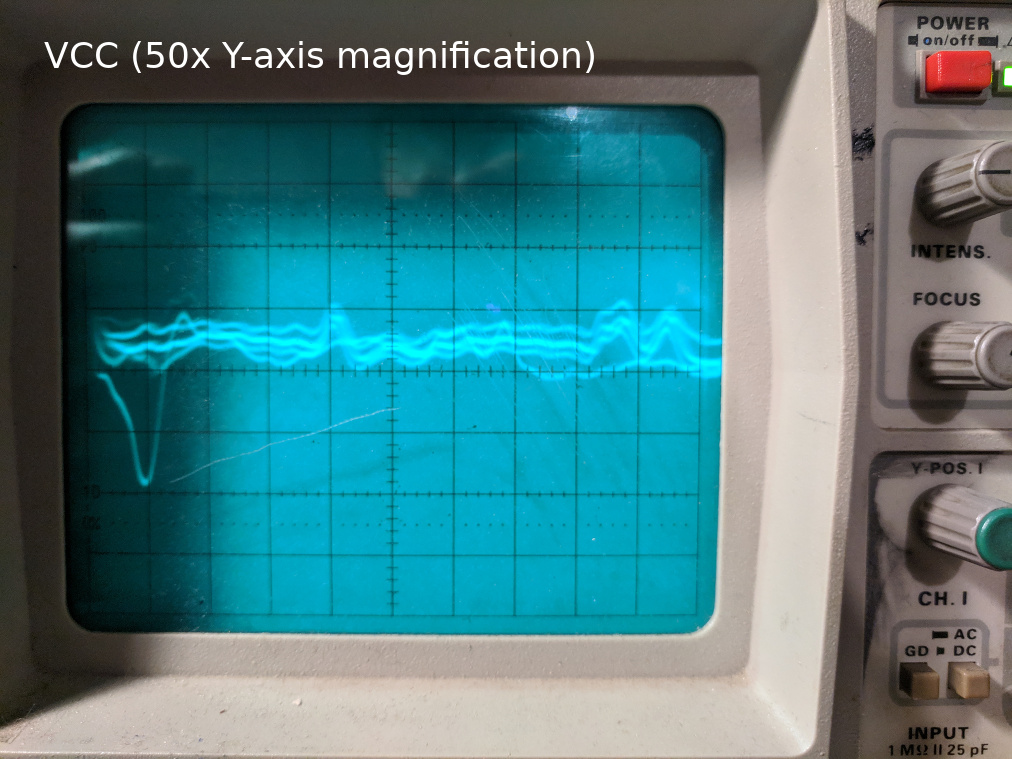

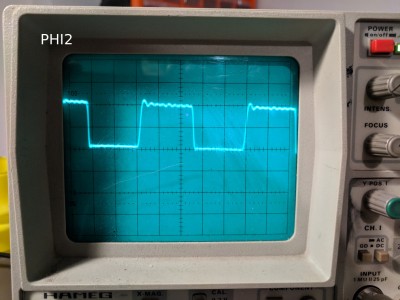

I got it under the scope. The signals look quite a lot cleaner than I was expecting. The clock looks great to me, and the ripples visible give me confidence in the fidelity of the scope, which, like I say, is pretty beaten.
The failure of R/W is clearly visible as it is pulled back towards 5V part way through a cycle.
Vcc looks pretty stable. Examining it at 10x X-axis zoom, and 50x Y-axis (relative to the other photos), I was able to look back and forth across the whole 10x magnified time range and the photo is of the portion showing the most variation. But at 50x zoom, it's showing a fluctuation of 100 to 150mV. Does that seems plausible to trigger brown-out?

The strange glitches on RWB looks as if there is a capacitive coupling from somewhere. Do you have a capmeter that can measure down to 100 pF? If, I would turn off power and measure RWB against any other signal. There ought to be no capacitive load anywhere but you may find an exception. Perhaps an ill placed blocking C.

What's the bandwidth of the 'scope? If it's fairly low (say, 50 MHz or less) then the waveforms probably have some "dirt" which simply isn't displayed.
Maybe the CPU can't reliably pull R/W low because it doesn't have a reliable connection to "low" ie, Ground. I admit it's kind of a goofy theory, but I do wonder if a bad connection may play a role here.
I suggest you use the scope to examine the waveforms on the Gnd and +5 pins of all your IC's -- be sure to probe the pin itself. This is to rule out the possibility of a poor connection from the IC pin to the Gn / +5 rails of the breadboard.

What I would normally do is put the phi2 signal on one channel and the R/W on the other and trigger off the Phi2. All bus operations on the 6502 depend on Phi2, so most timing measurements should be made WRT to it.

That RnW waveform is very odd indeed. It almost looks like there are two drivers fighting each other: RnW twice is driven positive, but not to the rail.
So, you need to review your design, and your implementation. Something isn't right.
