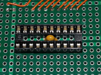

Slotted IC Sockets

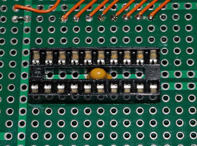

Let me start this off with a tip that I've used with DIP type proto boards. I buy IC sockets that have an ample slot in them between the pins so that I can mount bypass capacitors midway between the Vcc and Gnd pins.

Good thread... I've also used the same technique for bypass caps under the sockets, both in prototype boards and in final PCBs... saving space is saving space, plus it also keeps connections short.

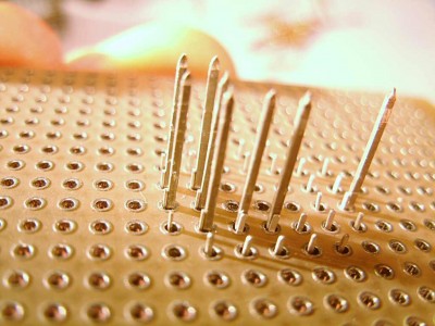

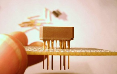

See also this post, which mentions two different ways to adapt IC sockets for wire-wrap. The technique shown in the first photo works with a PLCC socket or an ordinary DIP socket. The pins are harvested from inexpensive header strips. Notice the proto-board has plate-through holes, which, for mechanical reasons, I consider mandatory with this trick. The technique in the second photo uses machined pins. For a PLCC socket it makes sense but, for a DIP socket, not so much. Again, the proto-board has plate-through holes (although it's perhaps slightly less critical in this case).

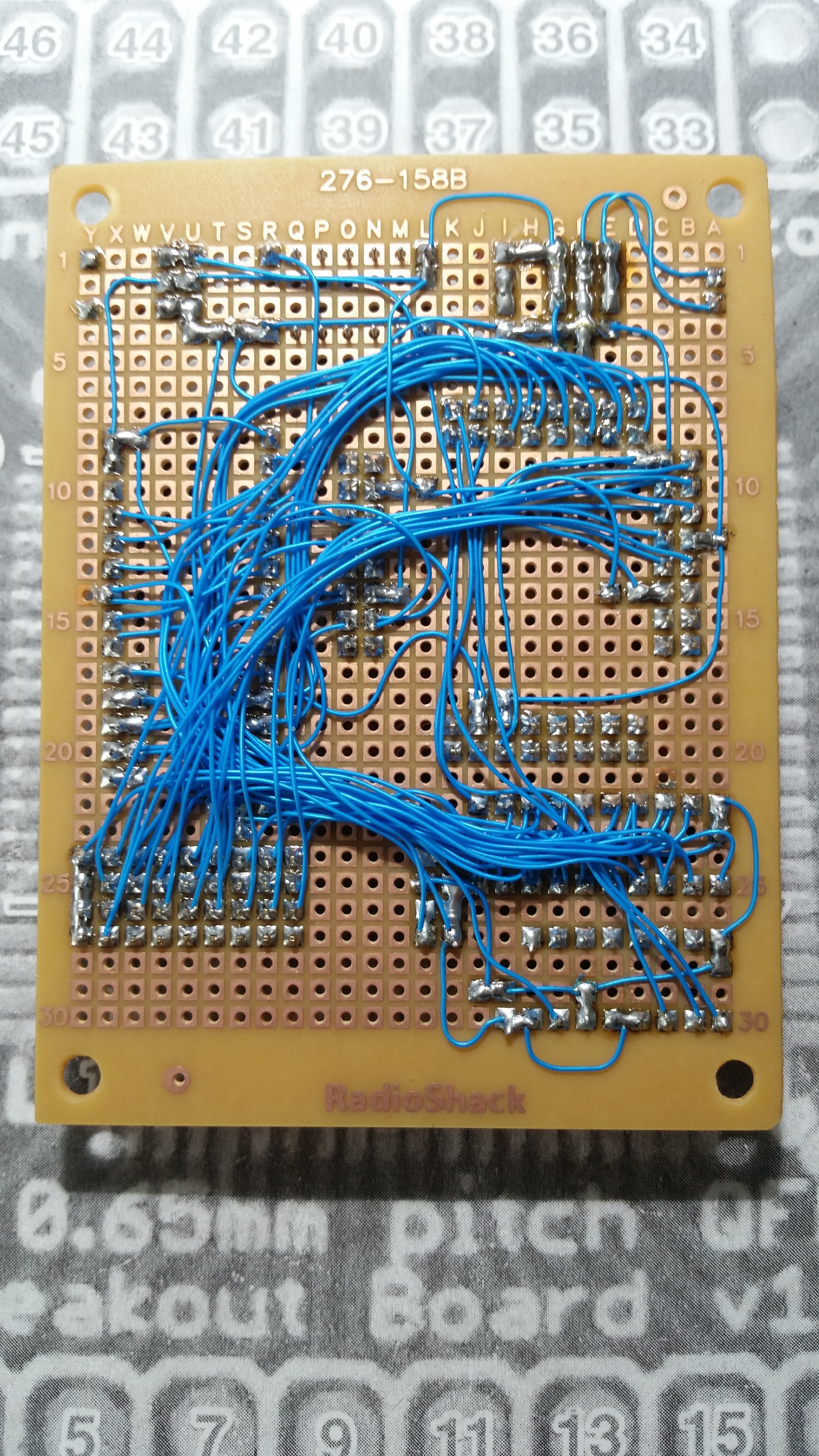

I've tried to do it like Ben Heck does with no luck. Basically, just soldering through the insulation without stripping. One long wire for multiple connections without cutting or stripping. Sounds like an excellent idea but in my experiences, the wire either breaks, pops off or the insulation melts so much that too much wire is exposed.

I have a bunch of AWG30 in different colors. I'm usually pretty good at handling this stuff but I think I just have some poor quality wire. I got all of it from eBay. When I compare my WW to what I've seen online, the ones online just look thicker. I mean mine seems like it could be used for PCB traces.

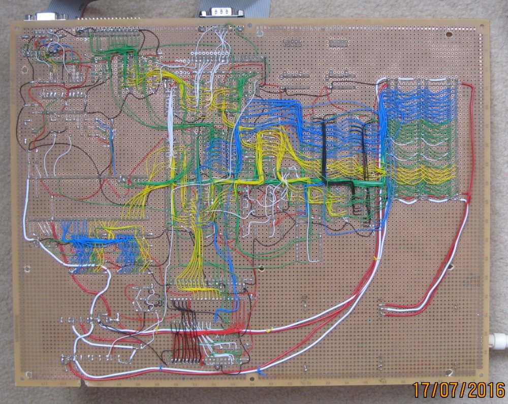

I use 30 awg Kynar for point to point, there's almost no shrinkage. I melt 2mm or so with the iron tip for each joint.
Most of my stock is either https://www.mouser.co.uk/ProductDetail/ ... ziThR3k%3d or https://uk.rs-online.com/web/p/hookup-e ... e/2094811/
It works well on long traces. Some of the data bus connections on this board (yellow) have 10 or so loops going across the board in a single piece. The address bus in blue is almost as long.
BTW the power links use much larger 2A PVC coated wire and shrinking insulation was a constant problem.
