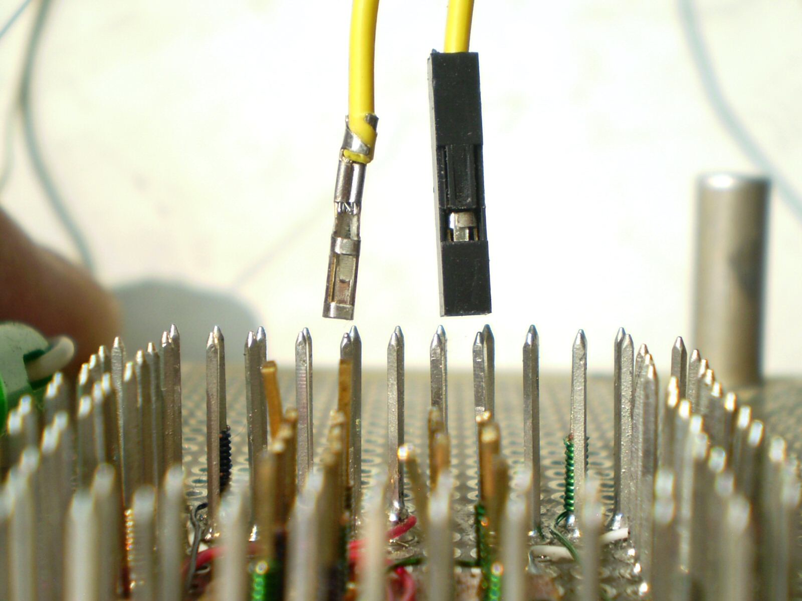

For starters, the genders are reversed as compared to a solderless breadboard. I'm using jumper wires with female tips, and they mate with a .025" male post far more reliably than the male-female connections which a solderless breadboard uses. Furthermore, .025" male posts are compatible with wire-wrap (as well as soldering, of course).

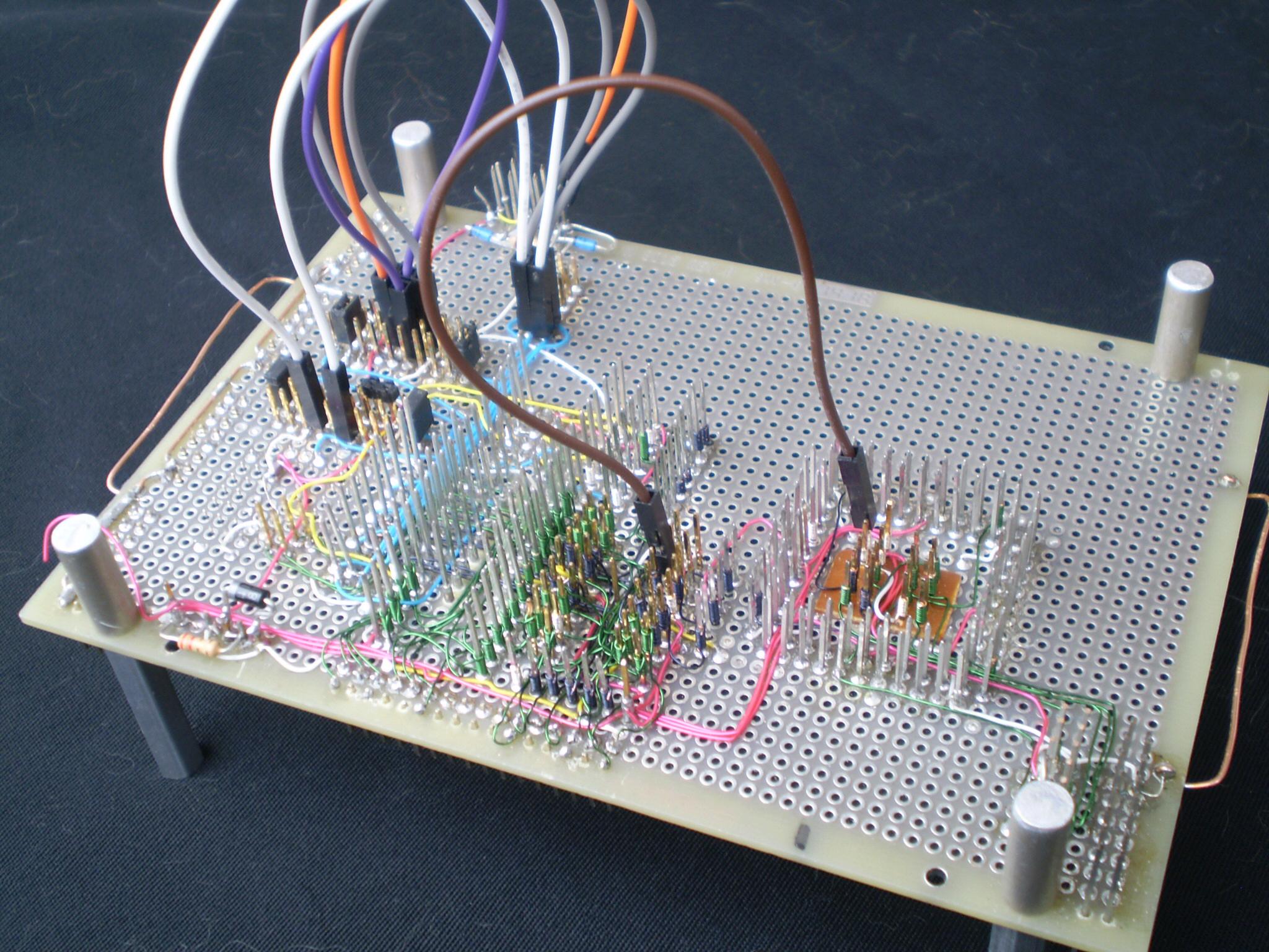

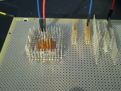

In its natural habitat TTC spends most of its time upside-down, with the wiring on top. The power & ground connections and the associated bypass capacitors are soldered; stuff like that isn't gonna change, and it doesn't need the flexibility afforded by wire-wrap or -- even easier to alter -- jumper connections.
For reasons of economy I use solder-tail (rather than wire-wrap) IC sockets in several places. And for reasons of laziness I exploit opportunities for broadside bus connections, such as the 8 pins of the 40-pin DIP 65xx's databus which connect directly to the '245 transceiver that's immediately adjacent (see the annotated photo near the end). That's a real labor saver since those connections are only .1" long and don't cross over other one another... and that means they don't involve an insulated wire which needs to be stripped at both ends. :!: The other side of that '245 transceiver also has stuff (SIP resistor arrays) located immediately adjacent for the same reason.
BTW it's not a bit uncommon for a wire (or group of wires) to attach with solder on one end and with wire-wrapping on the other. Whatever works!

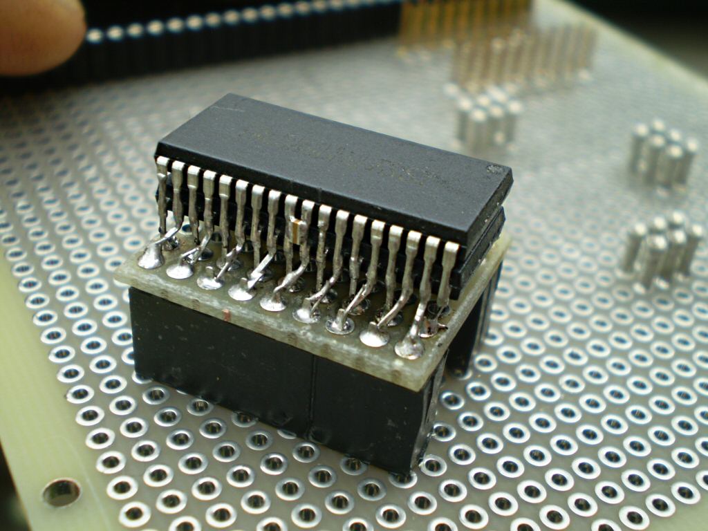

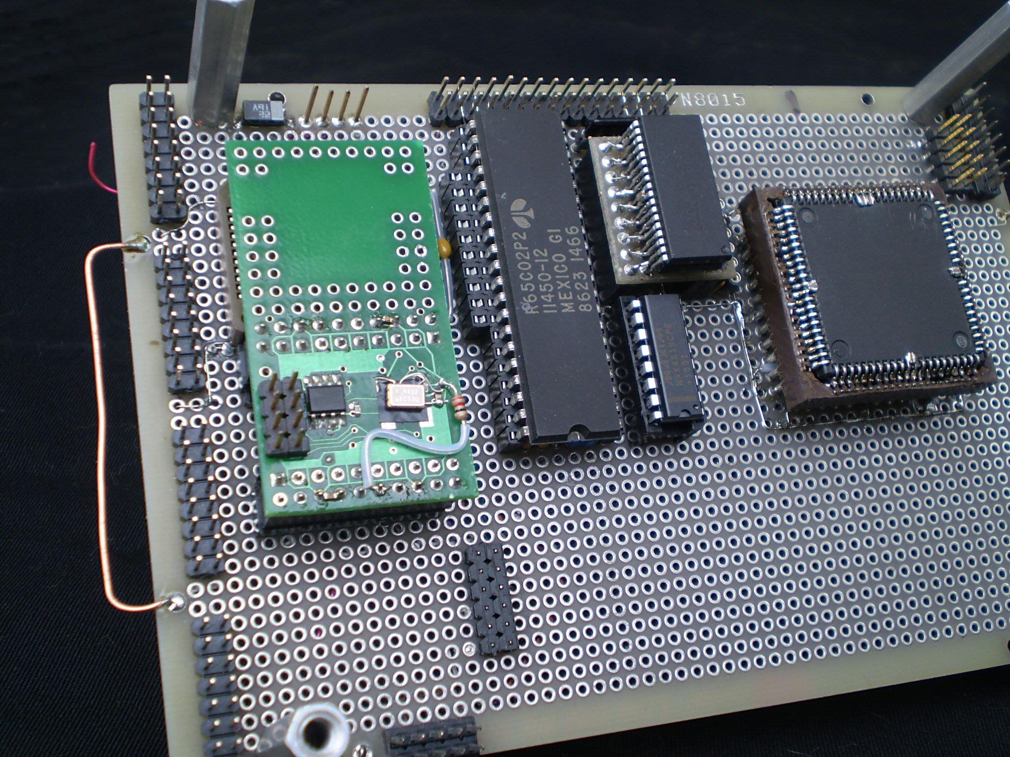

The two RAM's are soldered for an obvious reason -- ie; the piggybacking (I have a megabyte of 10ns memory in less than one square inch! :mrgreen: ).
Also, notice how easy the .050" pin spacing is to deal with -- just two staggered rows of .1". These are supposed to be SMD chips, but it doesn't take much to uncurl their J leads and situate them on a .1" grid. To make the RAM assembly removable I chose to use a daughterboard that includes female headers that mate with the gold-colored male pin layout you see in the background. A cheaper but more permanent approach would be to solder directly to the main board.

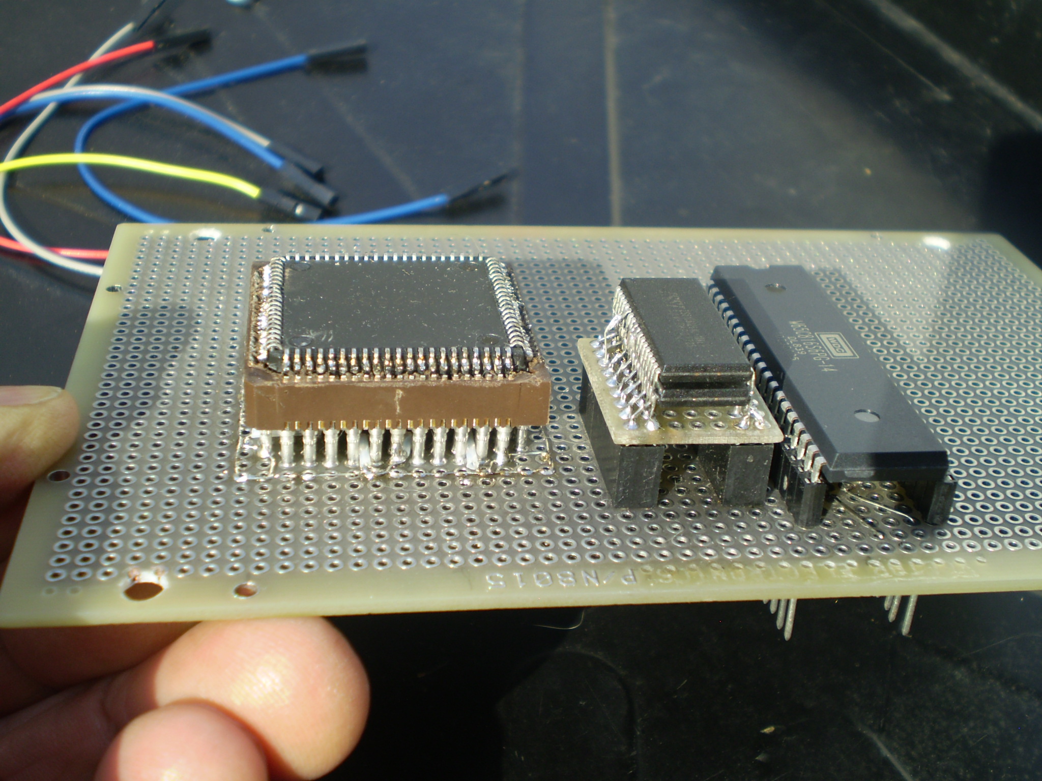

The PLCC-84 -- a 128-macrocell CPLD -- could have (and maybe should have) been mounted with the same technique as the RAM's. For me it's a big priority to attach bypass cap's directly to the IC package -- attaching merely to the socket is a compromise I prefer to avoid. But instead of using a daughterboard I opted to socket the CPLD... and the socket in turn attaches to wire-wrap pins via the method described here. And: the chip is inserted upside down so I could solder some SMD caps directly onto its J leads! :lol:
That worked out alright, but I discovered that the PLCC when upside down won't snap in to the socket 100%, and I was obliged to solder it in place. To do that I firstly had to mill away part of the socket. The thing ended up with kind of a rustic look, but the bypass caps ended up where they need to be, and that's the main thing.

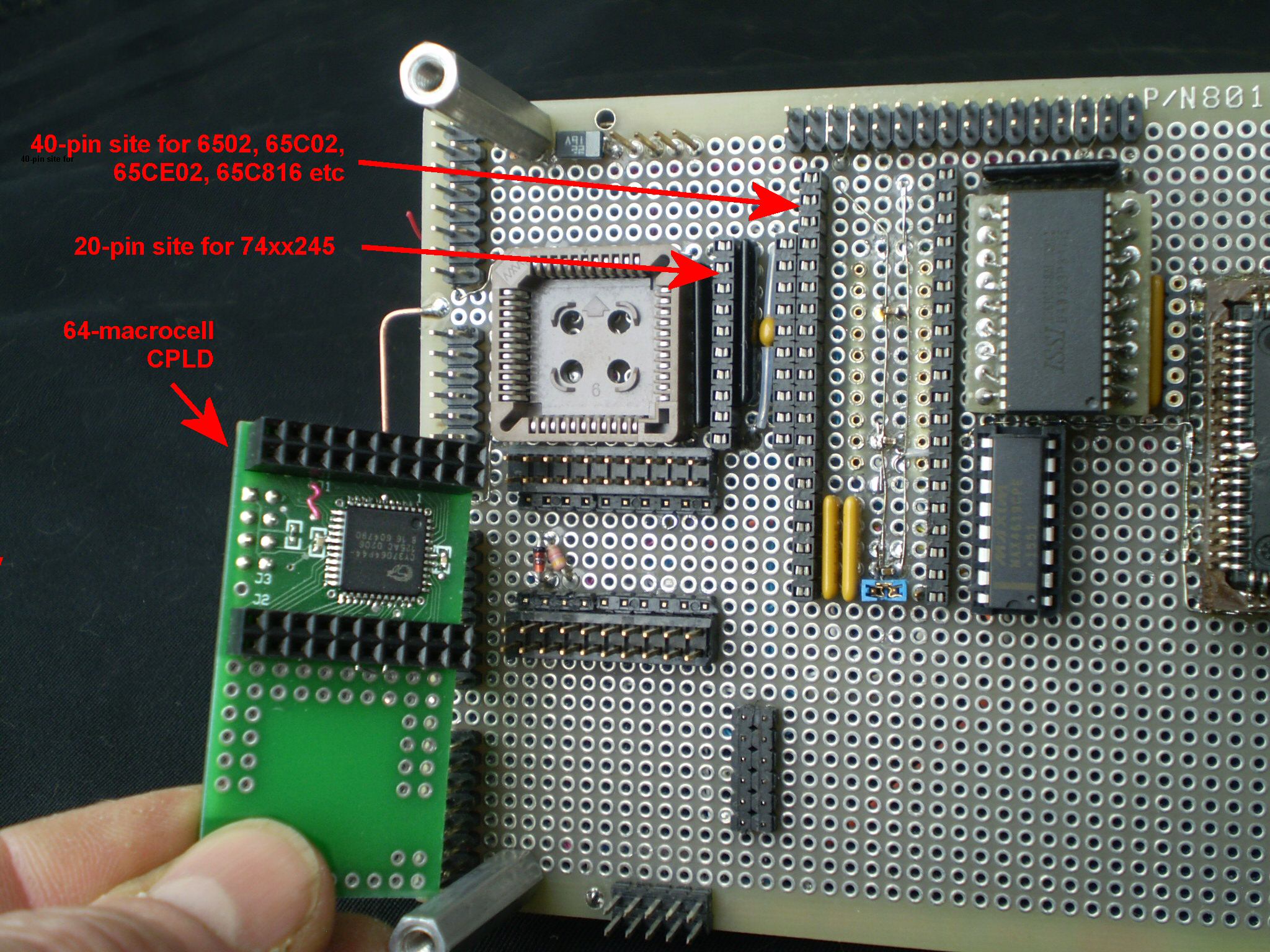

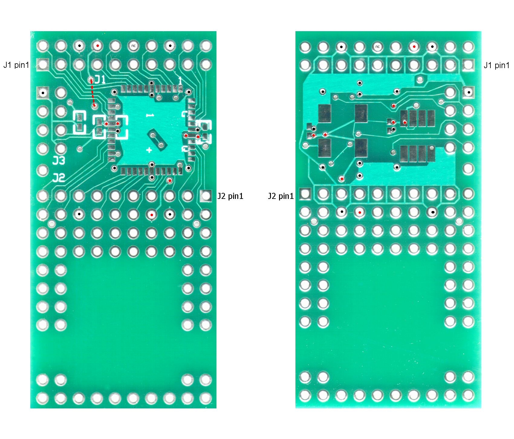

In the two photos above you can see a second CPLD attached to a etched daughterboard that serves as a breakout. (No .050" pin spacing on this chip, unfortunately.)
Unlike the large CPLD (which is entirely reserved for experimentation) this smaller device has well-defined functions. It receives asynch communication at 115.2 kbaud from a host computer, and it features a byte-wide output and a bunch of individually addressable single-bit outputs which the host can wiggle by remote control. These outputs serve to boot up the 65C02 (or '816 as the case may be) and to provide it with reset and a clock signal -- the latter being either single-step or a free-running 920 kHz (half the 1.8432 MHz communications oscillator frequency).

Bravo! A bed-of-nails. I have enough trouble figuring out which pin is which, without having an upside down CPLD in a socket underneath an upside down board... labels needed?
That smaller CPLD daughterboard which offers a QIP socket interface - I think I understand that - but what's the extra bit of the board which you've arranged to hover over the (unpopulated?) socket just north of the QIP nails? Is this a kind of either/or approach for the second CPLD? Or is there a third CPLD in play?

Thanks, fellas. It is kinduva bed of nails, although I certainly could have spaced things a lot further apart if I'd wanted to. Another person might might choose to forgo the obsessive compactness but still adopt other techniques seen here.
One nice thing about the TTC approach is this. After you've ironed out the new idea(s) you were grappling with you have the option of replacing the jumpers with wire-wrap or soldered wires, and what you end up with is a robust, permanent device. I wouldn't say the same for a breadboard.
I'm just juggling options and looking for alternatives. One nice thing about breadboards is how you're automatically able to make multi-point connections, as there are several (about 5?) attach points for every pin of every IC you plug in. With the TTC approach you need to add that capacity explicitly, either by providing duplicate pins or by making some custom daisy-chain jumpers with 3 or more ends on each jumper.
But I don't expect there'll be much need for those measures. TTC does have multi-point connections in the form of an address bus and two data buses (separated by the '245). But they were established with wire wrap and with soldering -- and, with the buses taken care of, there isn't much remaining need for multi-point connections! I do anticipate using jumpers to experimentally extend the data bus to the CPLD, for example. But I won't need 3-ended jumpers; I can just use the ordinary kind for the last leg of the journey. (Even in this circumstance there'd still be freedom to tap the data bus in a different place and jumper-extend to a second experimental device at the same time.)

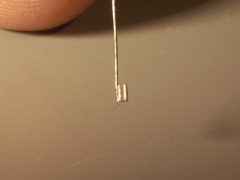

A couple more points regarding construction techniques. I've gotten more and more comfortable using SMD parts, and it's been a real boon. Through-hole stuff begins to look dumb by comparison -- needlessly bulky. In order to grasp SMD parts during assembly it's sometimes helpful to temporarily attach a "handle."

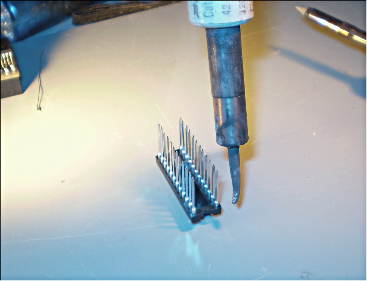

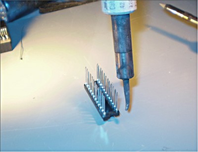

To reach into the bed of nails and solder a pin right where it emerges from the board requires a slender soldering iron tip, ideally with a slight curl on the end. I improvised, mostly using bits sold by Weller IIRC. The long, slender tip doesn't conduct heat very well, so a fairly high wattage element is needed (this one's 42 watts).
Drass wrote:
Looks like the footprint didn't fit and you improvised the wiring?
Yes there's a story there, but not a very meaningful one. The breakout board is a project I cooked up to take advantage of some leftover area on an unrelated order I was about to place with Express PCB. I wanted the breakout to have a prototyping area attached, and I was able to manage that. (Some of the holes had to remain undrilled due to the order's hole limit, but I can drill them myself if necessary.) TTC doesn't require the breakout's prototyping area, but some future project might, and despite it looking goofy I've resisted the urge to cut it off.
