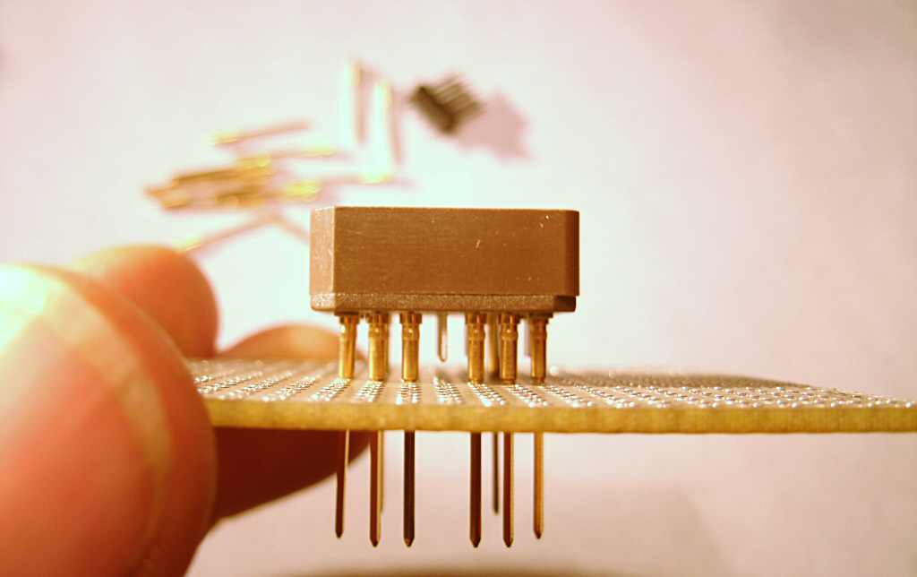

There are several prototyping tips in my thread, TTC: a 65xx sandbox *not* built on a breadboard.
See also this post, which mentions two different ways to adapt IC sockets for wire-wrap. The technique shown in the first photo works with a PLCC socket or an ordinary DIP socket. The pins are harvested from inexpensive header strips. Notice the proto-board has plate-through holes, which, for mechanical reasons, I consider mandatory with this trick.
The technique in the second photo uses machined pins. For a PLCC socket it makes sense but, for a DIP socket, not so much. Again, the proto-board has plate-through holes (although it's perhaps slightly less critical in this case).
