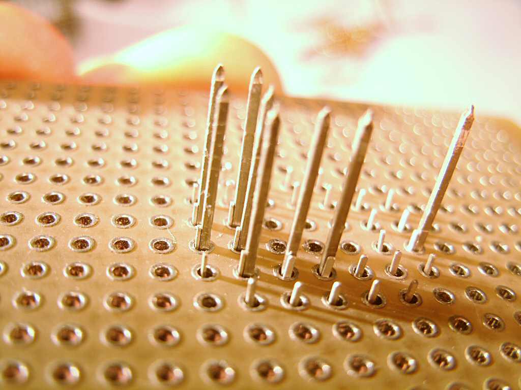

There are several prototyping tips in my thread, TTC: a 65xx sandbox *not* built on a breadboard.
See also this post, which mentions two different ways to adapt IC sockets for wire-wrap. The technique shown in the first photo works with a PLCC socket or an ordinary DIP socket. The pins are harvested from inexpensive header strips. Notice the proto-board has plate-through holes, which, for mechanical reasons, I consider mandatory with this trick.
The technique in the second photo uses machined pins. For a PLCC socket it makes sense but, for a DIP socket, not so much. Again, the proto-board has plate-through holes (although it's perhaps slightly less critical in this case).

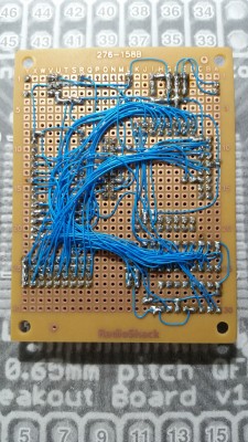

PostPosted: Mon Nov 12, 2018 10:15 pm
Posts: 197
I use 30 awg Kynar for point to point, there's almost no shrinkage. I melt 2mm or so with the iron tip for each joint.
Most of my stock is either https://www.mouser.co.uk/ProductDetail/Jonard-Industries/R30W-0100?qs=sGAEpiMZZMtW9UaYX5J1tA5kwbIAvdfRQwwnziThR3k%3d or https://uk.rs-online.com/web/p/hookup-equipment-wire/2094811/
It works well on long traces. Some of the data bus connections on this board (yellow) have 10 or so loops going across the board in a single piece. The address bus in blue is almost as long.
File comment: ATX size board Point to point wired
BTW the power links use much larger 2A PVC coated wire and shrinking insulation was a constant problem.

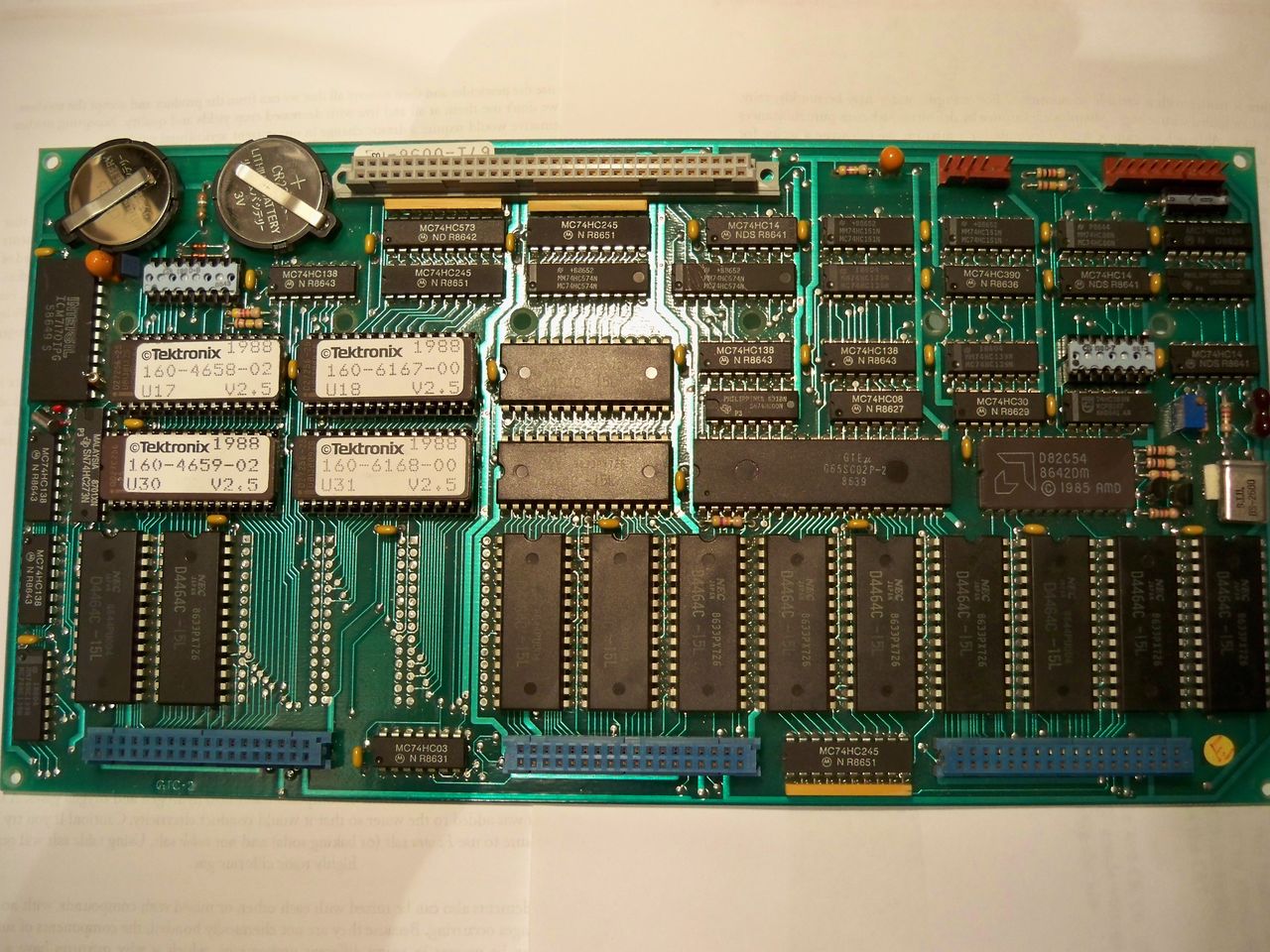

I should have thought about putting components under the sockets!
Looking at the design I recently made I'm starting to realize how badly designed it is. It works, but I could have done a better job at the routing. I've noticed that on professional boards, on one side the traces run horizontal and the other vertical. You probably all know this already.
-Floopy

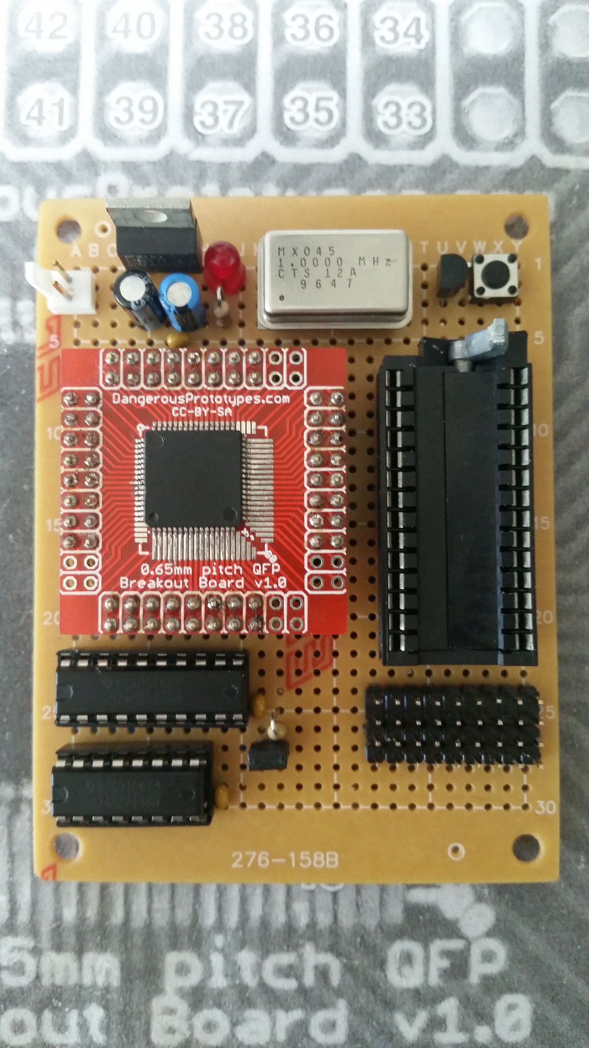

I am also using point-to-point with 30 AWG. I always strip the ends. I hold the wire with a pair of needle nose pliers. The pliers I use have flat jaws so they don't score or cut the insulation. While holding the wire, I strip the end with a sharp pair of small wire cutters. Sometimes I have a bus wire that passes through several connections and I'll melt the inner connections. Below are a couple of photos of a board that I built recently.
File comment: Fujitsu F2MC-8L SBC (Top)
File comment: Fujtisu F2MC-8L SBC (Bottom)
