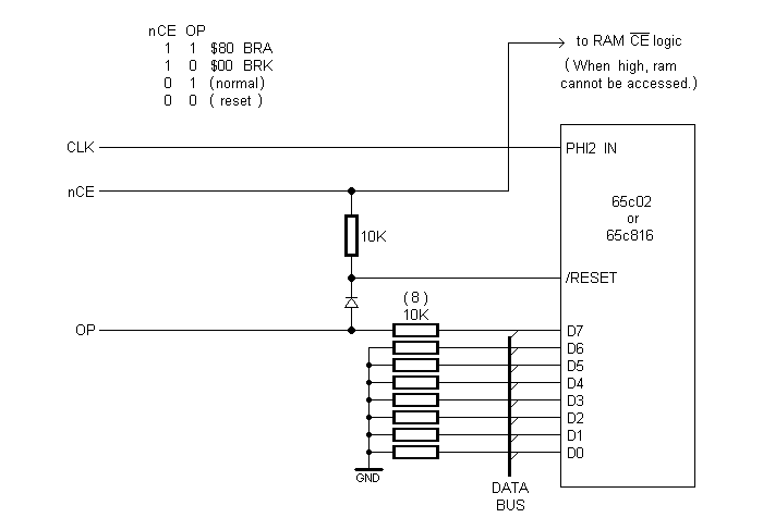

Here is a three-wire interface sufficient to boot up a ROM-less 6502-, 65C02- or 65C816-based computer. Because no ROM/ EPROM/ EEPROM is used the 65xx computer can benefit from simpler address decoding and from running with no wait states.
In one possible scenario, the three signals would originate on-board, supplied either by a microcontroller (possibly a tiny, 8-pin device) or by an SPI EEPROM and some glue logic.
In another scenario, the three signals could deliver code supplied by a separate host computer, in which case the on-board microcontroller or SPI EEPROM would be either omitted or just temporarily inhibited. Notice that this offers an opportunity to download arbitrary code, making the scheme attractive for development as well as for testing. (With suitable glue logic you could even temporarily attach the host computer in order to update the contents of the SPI EEPROM.)
  • Edit (the latest of several): Later in this thread forum member nyef proposes some promising changes, and I follow through by implementing and testing that idea as well as another key improvement. As a result, the 3-wire interface becomes usable on NMOS CPU's (which were ineligible for the original version). Also the bootup sequence becomes somewhat simpler and faster, and it becomes possible to create a substantially more efficient Level 2 Loader.
    Thus the description that follows is slightly obsolete (although still valid and workable). In future I hope to provide a revised writeup, but what follows won't lead you too far astray. The original interface often places dummy $00's and $80's on the data bus, and the CPU is fooled into accepting these in place of values fetched from memory -- values which represent instruction opcodes, instruction operands and vector bytes. The revised interface is similar but the dummy values are $00 and $6A instead.
The interface was inspired by Jens Madsen's remarkable Z-80 version; however, 65xx CPU's present a different set of challenges. Two years ago forum member DavidBuchanan described a 5-wire 65xx version which looks like it would work, and borrowing slightly from that I developed and successfully tested this 3-wire version using a rudimentary 6502/65C02/ 65C816 system described here.
3-wire bootup interface.png (6.14 KiB) Viewed 15831 times
Overview
The so-called "Level 1 Loader" executes two loops. The first loop fills the stack area ($0100 - $01FF) with a very specific program I devised; then the program is executed. Its sole purpose is to initialize the 65xx's stack pointer, S.
Then the second loop writes another program to the stack area. This program can be one you created, and assuming your program is happy running in the stack area then maybe it's all you'll ever need. :) But if not then what you'll run in the stack area is a "Level 2" loader that executes from the stack area but can write to anywhere.
The Level 2 loader could be one that you create, one that activates a UART or mass storage controller specific to your system. But in many cases it'll make sense to just continue using the 3-wire interface instead, and it's my assumption that this is what most users will do.
Now the details of the Level 1 loader.
The 65xx PC register (Program Counter) is adjusted to a desired value by means of a series of two-byte BRA (BRanch Always) relative branch instructions which get faked onto the data bus by 8 resistors. (While this is happening memory is inhibited; see schematic above.) Then PC (or at least PCH, the high eight bits of PC) gets pushed to stack in response to a BRK (software interrupt) instruction which is also faked. 256 iterations of this procedure result in the entire stack area ($0100 - $01FF) being written. Then memory is enabled (causing the fake instructions to cease) and the newly written bytes are executed, starting at $0100.
Notice the order of the bytes is known, but their location within the $0100 - $01FF stack area is probably skewed, because the writes were performed via S (the Stack Pointer). S probably didn't point to $00FF on powerup, which means it probably wrapped around before the last of the 256 bytes got pushed. But, as I'll explain later, the bytes are a program which is written to execute properly regardless of the starting point. :shock: $0100 may turn out to be somewhere in the middle of the program, but nevertheless if you start at $0100 it will always initialize S to a known value. With this important matter resolved, memory is inhibited, the fake BRA and BRK instructions resume, and another 256 bytes are written, this time to a predictable destination.
What's now in the stack area is actual bootstrap code that's customized for whatever you want to happen next. Probably that'll be a Level-2 loader, which might activate mass storage or open a serial port. Alternatively, the Level-2 loader can be one that continues accepting input from the 3-wire interface... but at higher speed, and without being constrained to writing in the stack area.
One of the three signals is simply the 65xx Clock and the other two are used mainly for controlling the data bus, as follows:
  • When nCE = 1 and OP =1 memory and I/O are inhibited and the resistors cause $80 to appear.
  • When nCE = 1 and OP =0 memory and I/O are inhibited and the resistors cause $00 to appear.
  • When nCE = 0 and OP =1 the data bus is normal -- ie; able to read and write memory and I/O in the usual fashion.
  • When nCE = 0 and OP =0 reset is asserted (and the data bus = don't-care).
The latter condition (reset) is detected by an OR "gate" -- the diode and resistor. An actual OR gate could of course be substituted. (Also, an octal tristate buffer could replace the 8-resistor array attached to the data bus. Such a substitution isn't helpful in most situations, although exceptions exist. I'll save that topic for future posts.)
My tests used an x86 box as the host computer, and the host code includes a couple of variables which are maintained as images of the 65xx PC (Program Counter) and S (stack pointer) registers. These register-image variables are crucial -- and updates to them are based entirely on inference, because all the host communication is outward bound. There's absolutely *no* feedback from the 65xx system! Therefore you need to keep track of what opcode the 65xx is executing, and keep a 100% perfect tally of thousands of clock pulses that need to be sent! I found this latter goal finicky to achieve. But in principle the code isn't terribly complicated, and things got easier after the basic routines were working.
A few of the maneuvers I'll explain in advance. Sometimes there's a need to use fake instructions merely as a means to alter the Program Counter before PCH gets pushed. The values $80 and $00 allow me to do this, as follows. $80 (as a fake BRA opcode) followed by $00 (as a fake operand) will advance PC by two, and $80 followed $80 will BRA backwards by about half a page. With these two tricks you can move PC all around the 64K map. [ PC can only ever point to even locations but that's OK because it's PCH we're gonna push. In the new version, $6A replaces $80, and $6A aka ROR can be used as a one-byte NOP. Thus PC can be made to point at both odd and even locations, making it feasible to push PCL instead. ]
You can also alter PC by using $00 as a BRK opcode and then faking the vector-low and vector-high bytes, in effect accomplishing a jump. $00 (used as a BRK) can serve as a jump, a push, or both a jump and a push. Its most common use is to push PCH to stack. Of course BRK will try to push *three* bytes (PCH, PCL, and P), and the trick is to enable RAM only during the cycle when the write of PCH is attempted. Here are the details for the push-PCH maneuver:
  • with clock high on a cycle when the 65xx is poised to accept an opcode, put $00 (BRK) on the bus.
  • wiggle the Clock line low then high again, twice. This takes us to cycle 3 of the BRK instruction (cycle 1 was the opcode), which is when the 65xx tries to write PCH to stack.
  • switch the data bus to "normal" mode. This enables RAM, causing the write to take place immediately. Then switch the data bus to $80 mode. RAM is now un-enabled. (And the $80 will, in cycles 6 and 7, serve as the low-byte and high-byte respectively of the software-interrupt vector.)
  • wiggle the Clock line low then high 5 more times. This takes us past cycles 4, 5, 6 and 7 of the BRK and leaves the 65xx poised to accept the next opcode.
So, PCH got pushed -- which is good :) -- and S got decremented..... by 3, :roll: which may seem not-good but is actually OK. By the way, note that the "push-PCH" maneuver has the side effect of updating PC to $8080 (thanks to the vector-low and vector-high bytes fetched in cycles 6 and 7 respectively).
the Play By Play
The host begins by setting clock high. Then it switches to Reset Mode, which immediately resets the 65xx CPU. Next is a switch to $80 Mode (which releases reset) followed by 9 clock pulses -- meaning clock low then high, 9 times. (Note: that's for a WDC 'C02 or '816. I also tested a Rockwell 'C02, which wanted 8, not 9.)
In any case you need to "get to first base," with the 65xx poised to accept the first opcode. At that time SYNC (or VPA and VDA) will be high, and PC -- which'll appear on the address bus -- will be $8080. (When debugging your host software you can pause to verify the state of these pins manually.) Because PC is now known the host software can give the PC register-image its first update. (S is still unknown, and the S image can remain uninitialized.)
Now begins the first 256-iteration loop. The host has reserved 256 bytes as a source buffer, and its content is what'll be copied to the stack area ($0100 to $01FF) in 65xx RAM. The host software uses the S image as a post-decrementing index to *read* a byte from the buffer. Next it manipulates the 65xx PC until PCH becomes equal to the byte. Then the push-PCH maneuver uses actual S as a post-decremented index to *write* PCH into the stack area. The decrement value is 3, not 1; also the 8-bit index will underflow and wrap around twice before we're done. But the same anomalies occur on both ends, and it all works out alright provided the number of iterations is 256. Here is the procedure in more detail:
  • using the S image as an index, the host fetches a byte from the buffer. This byte and PCH from the PC image are compared to see if they are equal.
  • if they're not equal then $80 (BRA) is placed on the 65xx data bus and 3 clocks are issued (or 4 in case of a page crossing; see Misc Tips below). As mentioned earlier this BRA $80 maneuver moves the 65xx PC backwards about half a page. (The PC advances by 2 as the instruction is fetched. Then sign-extended $80 aka $FF80 is added to PC.) The PC image is updated accordingly ($7E backwards) and then PCH is tested again. (I opted for a simple BEGIN - WHILE - REPEAT algorithm.) If necessary more BRA $80's are executed, and sooner or later PCH will equal the byte from the buffer.
  • PCH is pushed to stack using the BRK-based push-PCH maneuver explained previously.

Wouldn't it be faster and easier to push PCL (instead of PCH)? Yes. But we need all 256 values available, and there's no sequence of $80's and $00's that can cause PCL to have 0 in the least-significant bit. Edit: nyef's suggestion sidesteps this by using $E8's and $00's rather than $80's and $00's.
The 3-wire interface won't work with NMOS 65xx CPU's because they lack the BRA instruction. Edit: this, too, is sidestepped by nyef's suggestion.
Be careful to avoid accidental resets. When you're wiggling nCE and OP, always set first then clear. ie: to switch to "BRK" mode, first set nCE then clear OP. To switch to "normal" mode, first set OP then clear nCE.
Your bootstrap code should start by initializing S again, to $FF. :wink:
Only high input-impedance chips (eg, NMOS and CMOS) may connect to the bus that's driven by the resistors. The resistors wouldn't be capable of driving any TTL or LSTTL loads.
Especially with 65c816, a '245 transceiver may be present between the memory-I/O data bus and the CPU data bus. If the resistor array attaches to the memory-I/O data bus then nCE must inhibit memory and I/O. If the resistor array attaches to the CPU data bus then nCE must inhibit the '245 and memory and I/O.
Cycle counts must be perfect. Note that a BRA will take 3 or 4 cycles depending on whether there's a page crossing. The exact definition of a page crossing is crucial. You need to compare the ADH of the byte that's 2 past the BRA opcode with the ADH of the byte you're branching to. Also (and maybe this is obvious), having a BRA operand of 0 (as in the BRA $00 "two-bye NOP") doesn't make a BRA execute faster. It's not like BNE or BMI which are conditional, and take only 2 cycles in the case of "branch not taken."

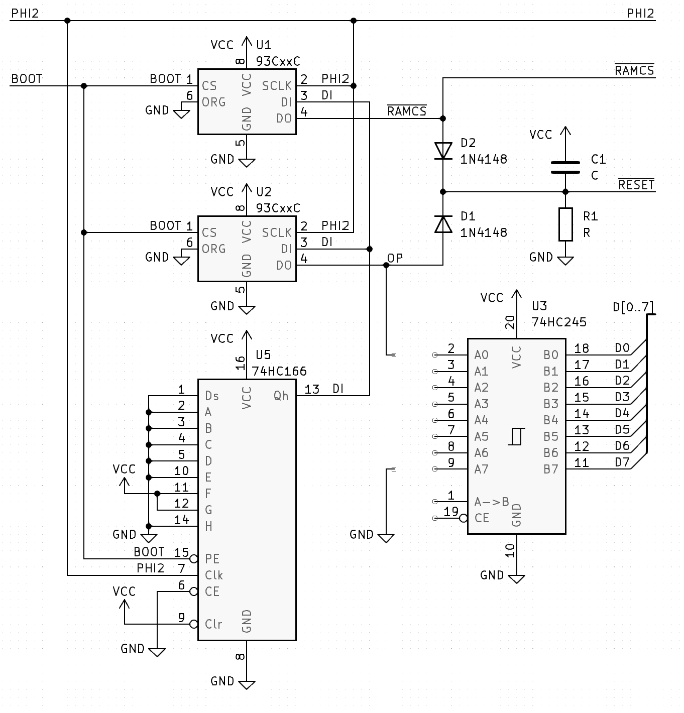

Posts: 11464
Re: Ultra-minimal 3-wire Interface boots up 65xx CPU's
Very clever indeed! (Lazy question: roughly how many clock cycles are needed to get to the point of executing the 256 byte program in page 1?)
Posts: 11464
Oops, I see now you say 250ms should be enough to get to the point of running the 256-byte loader.
In effect that loader is then free to bit-bang a synchronous serial interface, perhaps a bit like this:

Posts: 3526
Yes, I edited the lead post to clarify this point and a few others. 250 ms would cover the wonky "initialize S" code and the download of 256 bytes of comparatively normal code. (I refer to the latter as the bootstrap code). The delay estimate is based on the microcontroller or host link requiring about 1 uS every time any of the 3 wires goes high or low. (The host link I used happens to be much slower -- about 87 uS per event).
The bootstrap code might be a loader that relies on mass storage or an RS232 link. These are solid options, and it's pretty easy to imagine how they'd work. But it's more fun :) (and in some circumstances it'd be better) to avoid other I/O channels and instead continue accepting input from the 3-wire interface... whose abilities revolve around faking $00's and $80's onto the data bus.
Whoa -- excellent! Yes. In fact you leapfrogged my first idea for the "get-a-byte" snippet. (That version put a constant in X then repeatedly used CPX #$ xx to set or clear carry before ROR'ing it into A). But you suggested this...

Wow, nyef, I believe you've cracked the "one size fits all" challenge! By avoiding both BRA (which the 6502 lacks) and /SO (which the '816 lacks) you've arrived at a recipe that's equally palatable to 6502, 65C02 and '816! :P That's due to stuffing $E8 (INX) and $00 (BRK) onto the data bus, rather than $80 (BRA) and $00 (BRK).
You're concentrating on pushing PCL, rather than PCH as in the version I presented. ( In an unpublished earlier version there was a reason -- which I've forgotten -- why PCL wasn't easily workable. I guess in the course of subsequent iterations that reason ceased to apply, but I failed to notice.)
The speed enhancement of sometimes pushing both PCH and PCL is very clever, although it may perhaps be a tad tricky to code cleanly -- we'll see. Faster is always nicer, but I'm not that worried about speed when it comes to the "initialize S" phase of the operation. What pleases me most is the "one size fits all" breakthrough. Thanks for your contribution!
Update 1 (Jun 16, 2021): In this post, Enso asked,
Dr Jefyll, how is it going with your 3-wire bootloader?
I have a new version in the works, with two key improvements! The details will be duly posted, but here's a Spoiler. :)
As noted upthread, with the original version I would manipulate PC then push its high byte (PCH) when it had the desired value. That proved successful, but (as also noted) forum member nyef very kindly chimed in with the suggestion that I manipulate and push PCL instead. Besides being somewhat simpler and faster, this makes NMOS 02's eligible -- a "one size fits all" approach -- because the resistor-based "fake" data bus values would be $E8 and 0 rather than $80 and 0 as in my original. ($80 was problematic because I sometimes used it as a BRA opcode; but BRA is not in the NMOS 02's repertoire.)
So, manipulating PCL has a double benefit, being simpler and increasing the scope to include NMOS.
The other key improvement arose when I was looking ahead to the issue of the 2nd-level loader (Loader Two) -- a subject that's been only passingly discussed so far
. I'll backtrack briefly for some context:
The bottom-level loader (Loader One) is sufficient to initialize S and do a simple RCE exploit in page $01. :P That's the gist of the hack, and it gets us over the hump. But if you wanna download more than just a small program that runs in Page $01, what you run in Page $01 is Loader Two... and it in turn can download anything to anywhere, with no restrictions.
Loader 1 is necessarily very wonky. Writes executed by the processor sometimes get suppressed, and sometimes during reads the two fake resistor values get slipped onto the bus. This could happen almost anytime; for example, when the processor is fetching an instruction's opcode or its inline operand, or when it's fetching the vector associated with a BRK instruction. The activity each cycle is under control of the host.
Loader 2 is also under cycle-by-cycle control, but the wonky BRKs and PC manipulation are absent. Instead the 65xx is merely running a simple program from (mostly) RAM whose inner loop spends most of the time shifting bits into the A register.
Recently I did some sweating over the Loader 2 inner loop because it seemed suboptimal -- 2 instructions for each bit shifted. :| To improve that, I changed the resistor-based "fake" data bus values, which are now $6A and 0. This is actually a slight but tolerable disadvantage for Loader 1... but it is a major boon for Loader 2! Here's how $6A is used by Loader 2 for quickly shifting in bits.
As stored in memory, Loader 2's inner loop has eight $4A's (LSR instructions) in a row. The setup for the loop has already loaded A and Carry full of ones. What will happen is eight shifts in a row, leaving any of 256 possible values in A. The values vary because each of the eight shifts will be either a real $4A/LSR from memory (to shift in a 0) or a fake 6A/ROR from the resistors (to shift in a 1). Naturally it's the host which'll determine each individual $4A vs $6A choice, based on the data it wants to shift in. I'm pleased with the efficiency boost that results. The inner loop now only requires one instruction for each bit shifted.
Thanks for your interest. If you're eager, feel free to take the ball and run with it! I do hope to post fuller details "soon" but other projects are competing for my attention. Maybe I should give this one a higher priority...

Looking into potentially using this from SPI EEPROMs rather than connected to another computer, this is the kind of circuit I think I'd need, any thoughts?
I used two EEPROMs - one per signal. They need to be at least 2Kbit according to the stats posted above - larger would allow for later boot stages to also be present in these EEPROMs. The clock for this stage needs to be slow enough to drive them - the ones I looked at here only support up to 3MHz, but alternatives could go faster. So the clock probably needs to go through a multiplexer with a faster clock to switch to when the boot is complete.
The BOOT signal should be low on power-on to load the shift register, then high during boot, then low again after booting is complete - I think this requires some external feedback, or could possibly be driven by an RC circuit based on the EEPROM outputs so that if they are both high for a long enough period we deem the boot process to be over - that's assuming there's generally quite a bit of transitioning going on on these signals, without long periods of both being high.
I changed the reset wiring a bit to make it tolerant of brief dips as new data is clocked from the EEPROMs, in case both signals need to change at the same time. The RC circuit should be very fast, much less than a clock period - just enough to cover any transition time on the outputs from the EEPROMs after they are clocked. Maybe D2 isn't actually needed and R1 could go there instead, like in Jeff's circuit - so my only addition would be the capacitor.
The EEPROMs are clocked by PHI2 so their state changes at the rising edge of PHI2 and is held steady through the low phase of the clock.
I added the transceiver too to avoid having resistive loads on the data bus permanently. Jeff I think you suggested this, but hinted it might cause probelms but I don't think you said what they were, or I missed it. If it's an issue then we could have resistors after the transceiver, then at least when the transceiver is disabled after booting, the data bus is not really being pulled to any particular level. The transceiver inputs need to be set up for whatever values are working best - it sounds like this is $4A/$6A - and its output enable probably comes from the inverse of the RAM's one.

Thanks for your interest, George! I was dazzled by Jens Madsen's original (ie, Z80) version of this idea, and IMO it and this 65xx version are potent secret weapons for scenarios such as those I describe in the lead post. I'm eager to see your effort succeed. However, I am presently on vacation which means my comments at this time will be somewhat brief and/or half baked! :)
I like it. :) In case anyone's wondering what the heck the shift register is for, "In order to start (or restart) regurgitation, the SPI EEPROM needs to be sent an 8-bit Read opcode followed by a 24-bit Start Address." There's further description and a timing diagram here (pertaining to an SPI-EEPROM readback scheme similar to George's).
I changed the reset wiring a bit to make it tolerant of brief dips as new data is clocked from the EEPROMs, in case both signals need to change at the same time. The RC circuit should be very fast [...] my only addition would be the capacitor.
It's a crucial concern, because asserting the CPU /RES input even a very briefly will upset the apple cart. I managed the "potential glitch" problem by wiggling the nCE and OP signals individually, one at a time. If I need to do a transition that threatens to produce a low-going glitch on the diode-OR output that feeds CPU /RES, I break it into two parts. First I transition to the state where both nCE and OP are high; then I transition to the desired state. (This is perhaps explained more clearly in the lead post under "Misc. Tips and comments.") Basically, I simply avoid the situation where both signals change at the same time and a a low-going glitch could result. Compared to this, I not sure if the the capacitor approach offers much advantage.
It's been five years since I wrote those posts, so if there's any hinting I'll need to re-read the material and evaluate the clues myself! Meanwhile, do you have any particular concerns about leaving resistive loads on the data bus permanently? The resistors can have a fairly high value (chosen, of course, as a tradeoff with bootup speed).
Signing off for now... Sorry I've failed to address some of the points you mentioned.
Your EEPROM has a slightly different interface to the ones I was looking at - it requires a different command code and has an active-low chip select. Fairly minor differences overall though, just an extra inverter or two would be needed for that one I think.
In any case I don't actually have any yet, I'm planning to just buy a selection and see what they end up being useful for!
The trouble for me is that the CPU clock is the same as the SPI clock, so I can't really change one signal and then the other without the CPU executing a cycle in between. The capacitor is meant to help with this, but if it's not enough then it might need a more complex clocking circuit.
It's been five years since I wrote those posts, so if there's any hinting I'll need to re-read the material myself! Meanwhile, do you have any particular concerns about leaving resistive loads on the data bus permanently? The resistors can have a fairly high value (chosen, of course, as a tradeoff with bootup speed).
I think I figured it out - or at least that my initial scheme wouldn't work very well - it's that when we are blocking writes to RAM, the CPU is still driving the data bus, so we can't simply use the RAM's chip select inverted to control a transceiver, it needs to also be disabled during write operations. There are options, like putting the resistors on the other side of the transceiver and hooking its direction up to RWB, but it's at least not as simple as replacing the resistors with a transceiver alone.
My only concern with the resistive load is that one of the design constraints on the prototype I designed a few weeks ago was to avoid loading this bus as much as possible. It is probably being a bit extreme and overcautious though.
Not at all, good to hear from you and I hope you enjoy your vacation!

I wonder if you can do it in a simpler way.
Assume a 12 bit counter. Put its output onto the address bits of a 4k parallel ROM, and you have a general purpose signal generator.
Use the ROM output for SPI clock, MOSI and select, as well as RAM /cs etc. One state bit that disables the counter when done, could be reused as cpu /res and /be, and put the upper 8 bits of the counter on address bits 0-7, pulling the other bits up. Then use a serial in parallel out shift register to read spi miso and put it into the databus - to read the first spi ROM block into page $ffxx
That's basically the discrete version of what I have implemented as part of a larger CPLD.

I've come back to this, reread the notes, and thought through how the stage 1 loader works using the new $6A system. I had to transcribe everything onto paper and doodle there, to fully get my head around the building blocks. I thought I'd summarise my notes here, but am conscious it might not add much to the discussion, as I am just retreading Jeff's path - however, this train of thought helped me figure out how to control this system, so maybe it will be helpful to others.
One thing I've found is that regarding the reset issue, at least in the first stage loader it never comes up because I can always transition from having nCE and OP both high to having one being low - I never need to directly transition between one being low and the other being low.
So we have two control lines going to the CPU/RAM - nCE and OP. I enumerated the combinations of states of these lines as 0, 1, 2, and 3, with the low bit being the state of OP and the high bit being the state of nCE. Thus state 0 is reset; state 1 is normal operation with RAM enabled; state 2 is RAM disabled, pushing 0 to the data bus; and state 3 is RAM disabled, pushing $6A to the data bus.
Then we can list the various actions we can take to control the CPU, along with the specific state transitions necessary to achieve them. In contrast to Dr Jeffyl's original post, I am considering that there's a clock pulse (low-high-low) after every state change, so there's no need to encode the clock. I haven't built any hardware though so may have missed a reason why this wouldn't work. (Dr Jeffyl's description had the clock idling in the high state, and for a RAM write operation he was toggling nCE low then high without ticking the clock.)
I'll enumerate the actions that I think are possible or useful:
RESET - sequence 000...33333 - this forces a reset for a number of clocks, then takes five clocks of non-reset state to recover, during which the value doesn't matter much. I've used 3 because that's the safest state, transition-wise. SP is reduced by 3 and the CPU is on the point of loading a new address, which I'll mention below.
INC PC - sequence 33 - this is a ROR A operation, the second state could equally be a 2 but we avoid 1, perhaps, because of the possible need to follow this up with a "2" state (we want to avoid 1-to-2 or 2-to-1 transitions) and also because perhaps reading from arbitrary PC addresses could cause I/O issues.
BRKxx (stack write and branch) - sequence 23, followed by 1 or 3, then 1 or 3, then 3 - this is a BRK instruction. The second state could be a 2, but again we want to avoid a possible transition from 2 to 1, so use 3 here. The third state controls whether the first stack write - PC high - occurs. The second controls the second stack write - PC low. For these, 1 allows the stack write, 3 prevents it. The third controls the status register stack write, which is not useful so is always disabled. After this operation the CPU is ready to receive a new PC address.
From now on I'll write BRK for a BRKxx operation with both writes disabled, BRKH for one with the PCH write enabled, BRKL for one with PCL write enabled, and BRKHL for one with both PC byte writes enabled.
I think those are all the useful actions. The only other option is starting with state 1, which would read from RAM, and that's only useful if there's something in RAM, so later in the process.
RESET and BRKxx end with the CPU about to read a program counter value, and values we can load there are $0000 (states 22), $006A (states 32), $6A00 (states 23), or $6A6A (states 33). Note that state 2 supplies zero, state 3 supplies $6A, and the low byte is first.
So using these basic primitives we can set the program counter to a specific value, and then write either the low byte, or the high byte, or both to the stack. It is much cheaper in terms of CPU cycles to write arbitrary values via the low byte, because it takes a lot of cycles to change PC's high byte. All these stack writing operations reduce SP by 3. After each stack-writing operation, the CPU will be expecting a new PC value, so it is very convenient to consider supplying this to be part of the next high level operation we perform - i.e. all these high level operations will start by supplying an initial PC value.
As an example of such a higher level operation, we can set PC to $6A6A, advance by one, then write $6A followed by $6D to the stack (note that the low byte is two higher than you'd expect), followed by reducing SP one more time without writing, by executing the sequence "load 6A6A; INC PC; BRKHL" which, in states, is "33; 33; 23113". This state sequence is effectively a macro to perform the operation of writing $6A6D.. to the stack.
So what values are useful to write to the stack? Dr Jeffyl's original stack code was essentially two copies of "A2; xx; 9A" with EAs in between - that's "LDX #xx; TSX; NOP; NOP; ..." - the value of xx doesn't matter so long as it's consistent. In the $6A version we use 6A instead of EA, with much the same effect but using ROR instead of NOP. 6A is by far the cheapest useful value to write to the stack; 00 is also easy to write but we mustn't because it would cause unpredictable BRKs.
We want to write at least two copies of the useful initialisation code into the stack. Writing more copies could reduce the number of instruction cycles necessary later on to execute the stack memory and know confidently that the required operations have taken place. Spreading out the two copies also reduces the number of cycles needed. Writing "A2 6A 9A A2 6A 9A 6A 6A 6A ...", if we happen to start execution at the second "6A", would require 256*2=512 cycles to fully execute the critical 9A (TXS) instruction. But if the second copy is halfway through, then we only need half as many cycles. Using three copies would reduce the number of cycles to one third of the original value. However, as far as I can see, each extra copy costs about 190 cycles to insert, so at that point it's no longer worth adding more copies.
We can fill the whole stack with $6A by executing BRKH instructions back-to-back, loading the program counter with $6A00 or $6A6A after each one. This costs 7 cycles per stack byte. We can also fill it more efficiently by writing the high and low bytes together. This costs 7 cycles for two stack bytes, but the second (low) byte costs a bit more to set up. We can't just load $6A00 or $6A6A because that would result in the low byte being $02 or $6C (two greater than the loaded value of PC) neither of which are acceptable opcodes - $02 is undocumented, and $6C is a JMP instruction. We need the low byte to be a single-byte, two-cycle instruction, occuring as soon after $02 or $6C as possible. The first that looks useful is $0A - ASL.
So we can fill most of the stack with - in descending address order - $6A, $0A, $?? - by loading address $6A00, executing 8 "INC PC" operations, then one BRKHL operation, and repeating this 256/3 times (83 and a third). After that - or before it - we need to fill in the blanks ($??) that were not written during this step.
