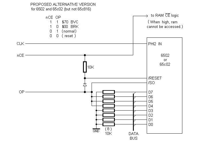

I don't know if this would work or not (either electrically in terms of the data bus, or in terms of the NMOS CPU behaviour), but a possible angle for an NMOS 6502 version would be to stuff $70 (BVS) instead of $80 (BRA), and to tie /RESET to /SO. Run the clock once while the CPU is in the reset state to force the V flag to be set coming out of reset. At this point your branches jump forward by $72 instead of backwards by $7E, your RESET and IRQ vectors are $7070, and everything else is "the same".
PostPosted: Fri Dec 21, 2018 3:58 pm
Hmmm, like this, then.... :)
Thanks for your interest and your suggestion, nyef! I think this version would indeed work for NMOS '02. Too bad there's no "one size fits all" which could include '02, 'C02 and '816. But the '816 lacks an /SO input! :| BTW, in this diagram I tied /SO to OP instead of /RESET, but probably either would work. And the host software would require only minor changes, as you noted.
Due to time constraints, I'm unlikely to test this version. Comments welcome. What I think would be more valuable is...
  • to clean up the host code and post it
  • to implement a Level-2 Loader similar to what Ed and I discussed

Wow, nyef, I believe you've cracked the "one size fits all" challenge! By avoiding both BRA (which the 6502 lacks) and /SO (which the '816 lacks) you've arrived at a recipe that's equally palatable to 6502, 65C02 and '816! :P That's due to stuffing $E8 (INX) and $00 (BRK) onto the data bus, rather than $80 (BRA) and $00 (BRK).
You're concentrating on pushing PCL, rather than PCH as in the version I presented. ( In an unpublished earlier version there was a reason -- which I've forgotten -- why PCL wasn't easily workable. I guess in the course of subsequent iterations that reason ceased to apply, but I failed to notice.)
The speed enhancement of sometimes pushing both PCH and PCL is very clever, although it may perhaps be a tad tricky to code cleanly -- we'll see. Faster is always nicer, but I'm not that worried about speed when it comes to the "initialize S" phase of the operation. What pleases me most is the "one size fits all" breakthrough. Thanks for your contribution!
Update 1 (Jun 16, 2021): In this post, Enso asked,
Dr Jefyll, how is it going with your 3-wire bootloader?
I have a new version in the works, with two key improvements! The details will be duly posted, but here's a Spoiler. :)
As noted upthread, with the original version I would manipulate PC then push its high byte (PCH) when it had the desired value. That proved successful, but (as also noted) forum member nyef very kindly chimed in with the suggestion that I manipulate and push PCL instead. Besides being somewhat simpler and faster, this makes NMOS 02's eligible -- a "one size fits all" approach -- because the resistor-based "fake" data bus values would be $E8 and 0 rather than $80 and 0 as in my original. ($80 was problematic because I sometimes used it as a BRA opcode; but BRA is not in the NMOS 02's repertoire.)
So, manipulating PCL has a double benefit, being simpler and increasing the scope to include NMOS.
The other key improvement arose when I was looking ahead to the issue of the 2nd-level loader (Loader Two) -- a subject that's been only passingly discussed so far
. I'll backtrack briefly for some context:
The bottom-level loader (Loader One) is sufficient to initialize S and do a simple RCE exploit in page $01. :P That's the gist of the hack, and it gets us over the hump. But if you wanna download more than just a small program that runs in Page $01, what you run in Page $01 is Loader Two... and it in turn can download anything to anywhere, with no restrictions.
Loader 1 is necessarily very wonky. Writes executed by the processor sometimes get suppressed, and sometimes during reads the two fake resistor values get slipped onto the bus. This could happen almost anytime; for example, when the processor is fetching an instruction's opcode or its inline operand, or when it's fetching the vector associated with a BRK instruction. The activity each cycle is under control of the host.
Loader 2 is also under cycle-by-cycle control, but the wonky BRKs and PC manipulation are absent. Instead the 65xx is merely running a simple program from (mostly) RAM whose inner loop spends most of the time shifting bits into the A register.
Recently I did some sweating over the Loader 2 inner loop because it seemed suboptimal -- 2 instructions for each bit shifted. :| To improve that, I changed the resistor-based "fake" data bus values, which are now $6A and 0. This is actually a slight but tolerable disadvantage for Loader 1... but it is a major boon for Loader 2! Here's how $6A is used by Loader 2 for quickly shifting in bits.
As stored in memory, Loader 2's inner loop has eight $4A's (LSR instructions) in a row. The setup for the loop has already loaded A and Carry full of ones. What will happen is eight shifts in a row, leaving any of 256 possible values in A. The values vary because each of the eight shifts will be either a real $4A/LSR from memory (to shift in a 0) or a fake 6A/ROR from the resistors (to shift in a 1). Naturally it's the host which'll determine each individual $4A vs $6A choice, based on the data it wants to shift in. I'm pleased with the efficiency boost that results. The inner loop now only requires one instruction for each bit shifted.
Thanks for your interest. If you're eager, feel free to take the ball and run with it! I do hope to post fuller details "soon" but other projects are competing for my attention. Maybe I should give this one a higher priority...

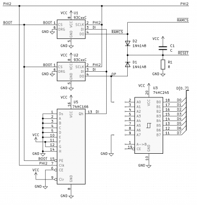

Looking into potentially using this from SPI EEPROMs rather than connected to another computer, this is the kind of circuit I think I'd need, any thoughts?
I used two EEPROMs - one per signal. They need to be at least 2Kbit according to the stats posted above - larger would allow for later boot stages to also be present in these EEPROMs. The clock for this stage needs to be slow enough to drive them - the ones I looked at here only support up to 3MHz, but alternatives could go faster. So the clock probably needs to go through a multiplexer with a faster clock to switch to when the boot is complete.
The BOOT signal should be low on power-on to load the shift register, then high during boot, then low again after booting is complete - I think this requires some external feedback, or could possibly be driven by an RC circuit based on the EEPROM outputs so that if they are both high for a long enough period we deem the boot process to be over - that's assuming there's generally quite a bit of transitioning going on on these signals, without long periods of both being high.
I changed the reset wiring a bit to make it tolerant of brief dips as new data is clocked from the EEPROMs, in case both signals need to change at the same time. The RC circuit should be very fast, much less than a clock period - just enough to cover any transition time on the outputs from the EEPROMs after they are clocked. Maybe D2 isn't actually needed and R1 could go there instead, like in Jeff's circuit - so my only addition would be the capacitor.
The EEPROMs are clocked by PHI2 so their state changes at the rising edge of PHI2 and is held steady through the low phase of the clock.
I added the transceiver too to avoid having resistive loads on the data bus permanently. Jeff I think you suggested this, but hinted it might cause probelms but I don't think you said what they were, or I missed it. If it's an issue then we could have resistors after the transceiver, then at least when the transceiver is disabled after booting, the data bus is not really being pulled to any particular level. The transceiver inputs need to be set up for whatever values are working best - it sounds like this is $4A/$6A - and its output enable probably comes from the inverse of the RAM's one.
PostPosted: Wed Aug 09, 2023 2:47 pm
Thanks for your interest, George! I was dazzled by Jens Madsen's original (ie, Z80) version of this idea, and IMO it and this 65xx version are potent secret weapons for scenarios such as those I describe in the lead post. I'm eager to see your effort succeed. However, I am presently on vacation which means my comments at this time will be somewhat brief and/or half baked! :)
I like it. :) In case anyone's wondering what the heck the shift register is for, "In order to start (or restart) regurgitation, the SPI EEPROM needs to be sent an 8-bit Read opcode followed by a 24-bit Start Address." There's further description and a timing diagram here (pertaining to an SPI-EEPROM readback scheme similar to George's).
I changed the reset wiring a bit to make it tolerant of brief dips as new data is clocked from the EEPROMs, in case both signals need to change at the same time. The RC circuit should be very fast [...] my only addition would be the capacitor.
It's a crucial concern, because asserting the CPU /RES input even a very briefly will upset the apple cart. I managed the "potential glitch" problem by wiggling the nCE and OP signals individually, one at a time. If I need to do a transition that threatens to produce a low-going glitch on the diode-OR output that feeds CPU /RES, I break it into two parts. First I transition to the state where both nCE and OP are high; then I transition to the desired state. (This is perhaps explained more clearly in the lead post under "Misc. Tips and comments.") Basically, I simply avoid the situation where both signals change at the same time and a a low-going glitch could result. Compared to this, I not sure if the the capacitor approach offers much advantage.
It's been five years since I wrote those posts, so if there's any hinting I'll need to re-read the material and evaluate the clues myself! Meanwhile, do you have any particular concerns about leaving resistive loads on the data bus permanently? The resistors can have a fairly high value (chosen, of course, as a tradeoff with bootup speed).
Signing off for now... Sorry I've failed to address some of the points you mentioned.
PostPosted: Wed Aug 09, 2023 4:19 pm
Posts: 741
Your EEPROM has a slightly different interface to the ones I was looking at - it requires a different command code and has an active-low chip select. Fairly minor differences overall though, just an extra inverter or two would be needed for that one I think.
In any case I don't actually have any yet, I'm planning to just buy a selection and see what they end up being useful for!
The trouble for me is that the CPU clock is the same as the SPI clock, so I can't really change one signal and then the other without the CPU executing a cycle in between. The capacitor is meant to help with this, but if it's not enough then it might need a more complex clocking circuit.
It's been five years since I wrote those posts, so if there's any hinting I'll need to re-read the material myself! Meanwhile, do you have any particular concerns about leaving resistive loads on the data bus permanently? The resistors can have a fairly high value (chosen, of course, as a tradeoff with bootup speed).
I think I figured it out - or at least that my initial scheme wouldn't work very well - it's that when we are blocking writes to RAM, the CPU is still driving the data bus, so we can't simply use the RAM's chip select inverted to control a transceiver, it needs to also be disabled during write operations. There are options, like putting the resistors on the other side of the transceiver and hooking its direction up to RWB, but it's at least not as simple as replacing the resistors with a transceiver alone.
My only concern with the resistive load is that one of the design constraints on the prototype I designed a few weeks ago was to avoid loading this bus as much as possible. It is probably being a bit extreme and overcautious though.
Not at all, good to hear from you and I hope you enjoy your vacation!
PostPosted: Fri Aug 11, 2023 6:26 pm
Posts: 1043
I wonder if you can do it in a simpler way.
Assume a 12 bit counter. Put its output onto the address bits of a 4k parallel ROM, and you have a general purpose signal generator.
Use the ROM output for SPI clock, MOSI and select, as well as RAM /cs etc. One state bit that disables the counter when done, could be reused as cpu /res and /be, and put the upper 8 bits of the counter on address bits 0-7, pulling the other bits up. Then use a serial in parallel out shift register to read spi miso and put it into the databus - to read the first spi ROM block into page $ffxx
That's basically the discrete version of what I have implemented as part of a larger CPLD.
