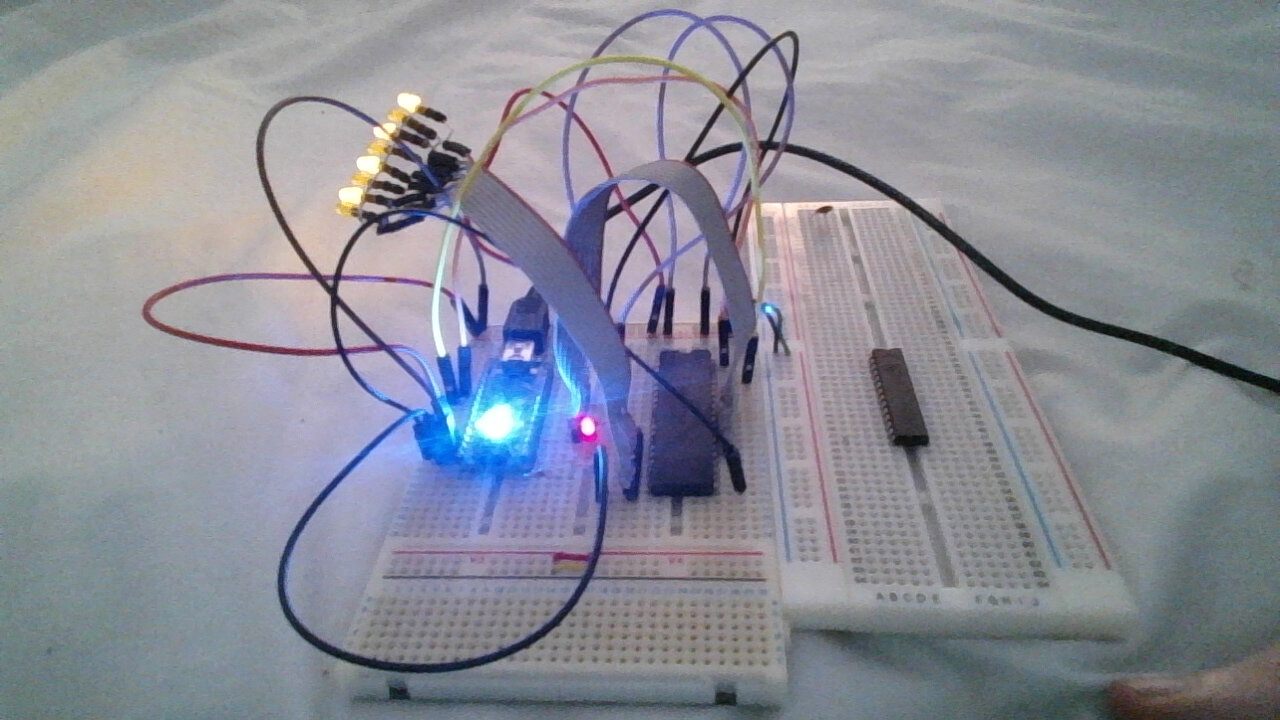

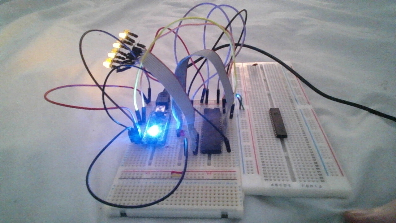

3-Chip ROMless designs have been done in the past, using a microcontroller to load up the RAM.
However, all the ones I've seen so far have had the whole address and data bus wired up to the microcontroller. To save microcontroller pins, I came up with a much simpler design, that also works for CPUs without a BE input. It's so simple, it doesn't even need a circuit diagram.
The data bus is wired to the microcontroller, CPU and RAM, while the address bus is only wired between the CPU and RAM. The microcontroller also provides the clock and reset signals.
At startup, the microcontroller can put instructions directly onto the data bus. To load up the memory, it would use LDA, STA repeatedly to write to memory, without needing direct control of the address bus.
I haven't got the RAM wired up yet, but I have the CPU executing instructions straight from the microcontroller (Arduino nano) as a proof-of-concept. The code tells it to jump between 0x5555 and 0xAAAA repeatedly, which means I can put some LEDs on the address lines to verify that it works. I have attached some images of the system in action.
This is the Arduino code I used:

I'm planning to buy some surface mount parts, and get a tiny board made once I finish prototyping.
PostPosted: Wed Jun 15, 2016 9:04 pm
Posts: 8512
Getting away with three chips was the purpose behind the 6530 and 6532 RIOTs (RAM, I/O, and Timer, all in one IC) of yesteryear. The RAM afforded some ZP and page-1 storage space. Those were NMOS only, and probably never exceeded 1 or 2MHz, but they allowed a system with 6502, EPROM, and RIOT, before the days of workbench-programmable microcontrollers. I'm not aware of any workbench-programmable 6502-based microcontrollers that might have ever been available, but there are still the 65134 and 65265 microcontrollers which can use external ROM.
I do like your idea though!

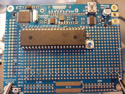

My L-Star project is basically a 2-chip 6502 computer: it uses a Propeller and a 65C02 to make a working system. Well... I admit it really takes 3 chips because you also need an EEPROM to make the Propeller work. But that's not connected to the 65C02 so I could argue that it doesn't count :-).
The Propeller is connected to the address bus and data bus, R/~W and the clock. The Propeller is programmed through a serial port that can also be used as terminal. That leaves 3 pins on the Propeller free for monochrome video and a PS/2 keyboard. I have working software to emulate the Apple 1 and the OSI Superboard II (also known as the OSI Challenger or UK101).
This is a picture of L-Star on a Propeller proto board. Obviously there are more chips on the board because this includes a power supply and an FTDI chip for the serial port. But all I needed to solder on there to make it work was the 65C02, two pull-up resistors and a reset button.
The version in the picture doesn't have a PS/2 or video out connector because it's the simplest possible version. I also made a custom PCB that does have the connectors, and also has a power supply, an expansion header and a static RAM chip.
The 65C02 has complete control over the address bus but that's not a problem: The Propeller can bitbang a ROM image onto the data bus to let the 65C02 boot. It can also emulate I/O hardware such as the PIA on the Apple-1 to get text in and out. The RESET line of the 65C02 is not connected to the Propeller but when the system starts, the Propeller can generate BRK instructions and when the 65C02 retrieves the IRQ/BRK vector, the Propeller can feed the address of what's normally the reset vector. This works most of the time but not at power-up time: the 65C02 is jammed at that time and needs an actual reset, so the pushbutton is necessary.

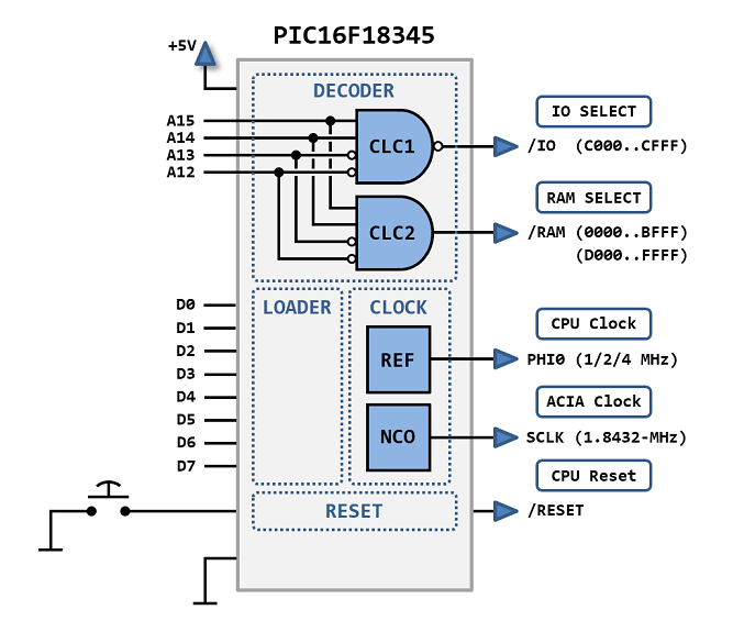

PostPosted: Tue Jun 21, 2016 11:52 am
Posts: 588
Hi David:
I learned about this blind loader method several years ago when I came across Nicholas FitzRoy-Dale's Hardware SID Player article.
I'm expanding the method and working on code for a 'blind monitor'. Basically a full blown monitor with memory read/modify commands, mini assembler and disassembler, and a 'flash' command to copy a block of upper RAM to PIC flash memory for the loader function. The 'blind monitor' runs in an otherwise unused 16 byte block of addresses within the I/O address space.
You might utilize other microcontroller features to reduce the amount of 'glue' chips required for a design. Just add CPU, RAM, VIA and/or ACIA to the example below for a 'minimal' system with 60K RAM and 4K I/O address space (including a 'blind loader' and 'blind monitor'). All that in a single 20-pin 'glue' chip... very cool.
Good luck in your research... Cheerful regards, Mike

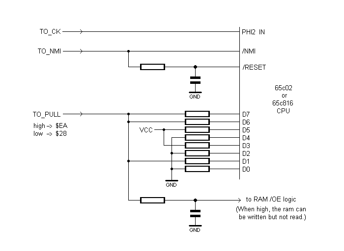

PostPosted: Sat Jun 25, 2016 12:56 am
I saw a bootup scheme for Z80 [...]
DavidBuchanan wrote:
This intrugues me. I have thought of a way to make similar system with a 6502. [...]
Very nice, sir! I confess I doodled with a 65xx version myself, but, daunted by the 8-bit Stack Pointer, I set the problem aside. It didn't occur to me to use pullup and pulldown resistors -- an innovation which sets your approach apart from the Z80 version.
Borrowing your pullup/pulldown idea, I took another run at the problem and managed to develop a scheme which uses 3 signals from the host rather than 5. I cheated by adding two resistors and two capacitors! :roll: :)
Edit: see my subsequent post for a simpler version of the idea.

As shown above, the signal called TO_NMI drives both /NMI and -- via an RC network -- /Reset. Similarly, TO_PULL drives certain pullup/down resistors and -- via an RC network -- the logic that asserts RAM Output Enable. The pullups and pulldowns are arranged to produce both $EA (NOP) and $28 (PLP). The slow (1 ms, say) rise and fall transitions from the RC's won't matter because they occur while the clock is stopped -- I think I'm on solid ground when I say that. Here's the play by play:
    After powerup, TO_NMI is brought low if it's not already. We wait 1 ms (eg) to ensure /Reset is also low, then, using TO_CK, feed the 65xx maybe 6 or 8 clock pulses, then stop. We bring TO_NMI high, wait 1 ms for /Reset to follow suit, then deliver 7 clocks to execute the reset sequence. Henceforth, TO_NMI remains high, as a rule. Only brief low pulses (to generate NMI's) occur.
    TO_PULL is high, did I mention? :) The 65xx sees $EA on the data bus, and $EAEA is where the reset vector lands us.
    Next comes a loop, repeated 64 times:
    • We do NOP's until the PC equals $EA9A - 1, then execute an NMI by pulsing TO_NMI low and issuing 2 clocks while it's low. This brings PC to $EA9A. Now 7 more clocks for the interrupt sequence (and the interrupt vector takes us to $EAEA).
    • Although the NMI pushed 3 bytes, we discard the last one by momentarily dropping TO_PULL and doing a PLP (4 clocks).
    • We do NOP's until the PC equals $EAA2 - 1, then execute an NMI as before, again using PLP to discard the 3rd byte pushed
    The stack page is now full of repetitions of the pattern $A2, $EA, $9A, $EA. Alignment is unknown (eg, starting from $0100 you might see, say, the 4th byte of the pattern first), but no worries -- if you run it you'll eventually execute LDX# $EA then TXS. So, that's what we do: run NOP's until the PC equals $0100, then enable memory reads (ie; drop TO_PULL and wait 1 ms) and deliver enough clocks to run the LDX# $EA and TXS sequence at least twice (to ensure recovery from any misalignment).
    Now we know S = $EA! :mrgreen: [Edit: the misalignment recovery means PC isn't known exactly. Possible remedy: another NMI, making PC=$EAEA and S= $E7. Still pondering this.] The rest is predictable. We inhibit memory reads (set TO_PULL =1 and wait 1 ms), then:
    • do NOP's until PC= the last byte-pair of our actual boot program - 1. NMI the byte-pair to stack.
    • do NOP's until PC= the 2nd-last byte-pair of our actual boot program - 1. NMI to stack.
    • (etc until done)
    • do NOP's until PC= the start of the actual boot program just pushed. Then enable memory reads, and let fly!
Comments welcome -- I hope there's nothing serious I've overlooked. One minor point is the RC delay of the pullup/down resistors driving the bus lines themselves. It won't be possible to instantly switch between $EA and $28; a delay must be allowed of perhaps a few microseconds (for a firmer figure you need to do the math or do an experiment). And of course LS TTL devices aren't permitted -- only (C)MOS. Finally, you might as well let Ck default to high and only momentarily pulse low, rather than vice versa. That's in case you ever end up dealing with a Rockwell or similar 'c02 which can't tolerate extended clock-low periods.
