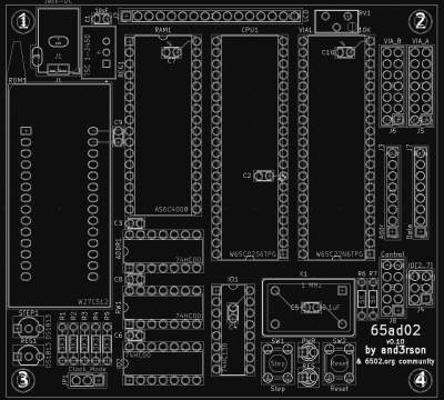

P. S. I think it's about time I split my Kicad schematic into multiple sheets... I tried resisting it (I really like having everything in front of me on a single page), but it's getting too crammed now. Maybe I'll simply try increasing sheet size to A3!

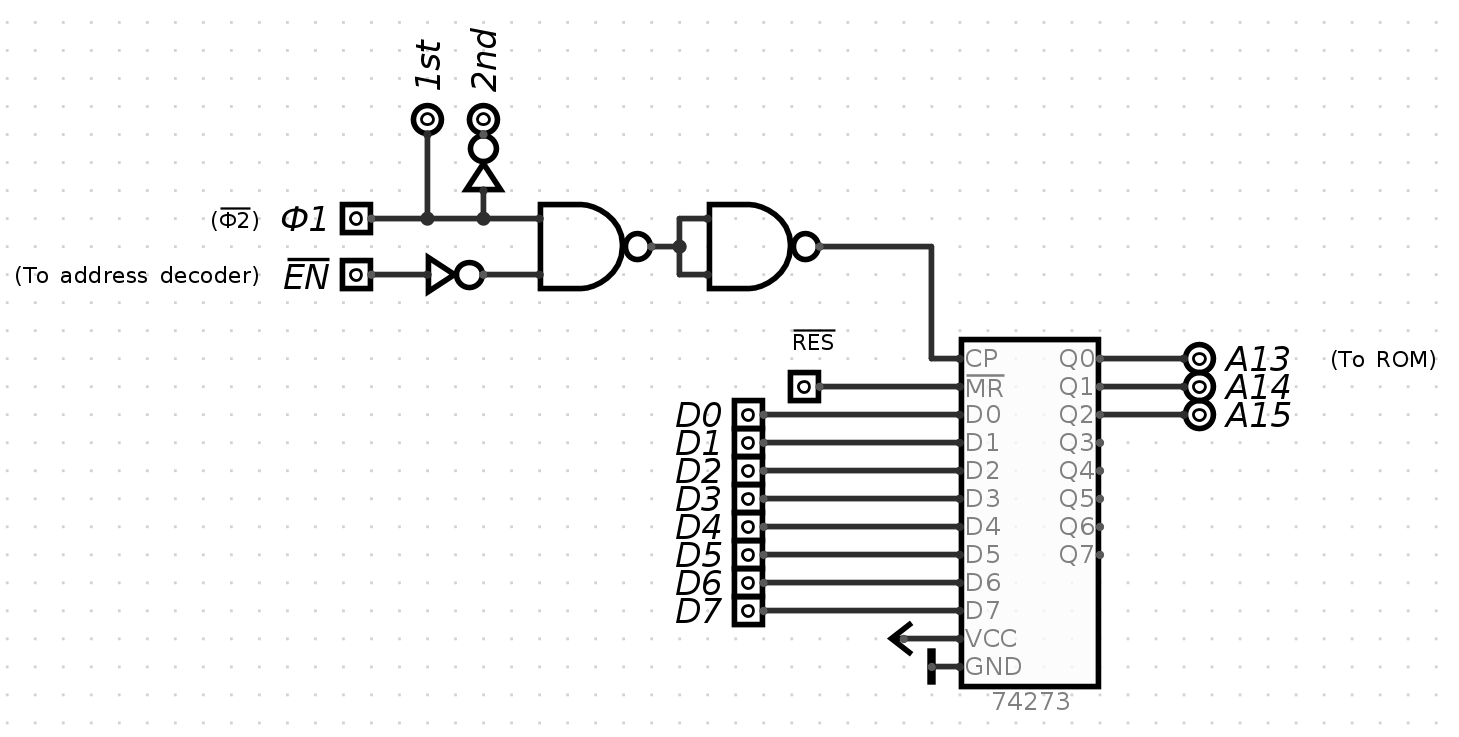

Meanwhile, I've been thinking about a possibility to have several programs on one ROM and to be able to develop & run them individually by having some software banking for ROM. I have lots of W27C512 (which fit 8x 8-KB ROM images) that I used with my C64s, and the idea of implementing the banking itself feels so cool. It can also be used to bank RAMs (although I don't have any needs for RAM banking yet.)
I've seen people on this forum suggesting to use '273, and it turned out to be a perfect solution: I'll simply have a byte somewhere in memory (possibly I/O region), to which I'll write the number of bank that I want to use.
On reset, '273 will also be reset, thus always starting with the first bank.

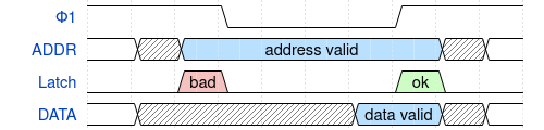

Here's a schematic I came up with: There's a caveat though: '273 latches two times with this approach, once when data is invalid and once when the data is valid, so there's this "bad" section. I wonder if there are any other caveats with this.
Here's a rough timing diagram of how I think this is going to work (I hope my understanding of 6502 write timings is correct). I've also used Ф1 instead of Ф2 to save one inverter. Schematic file:

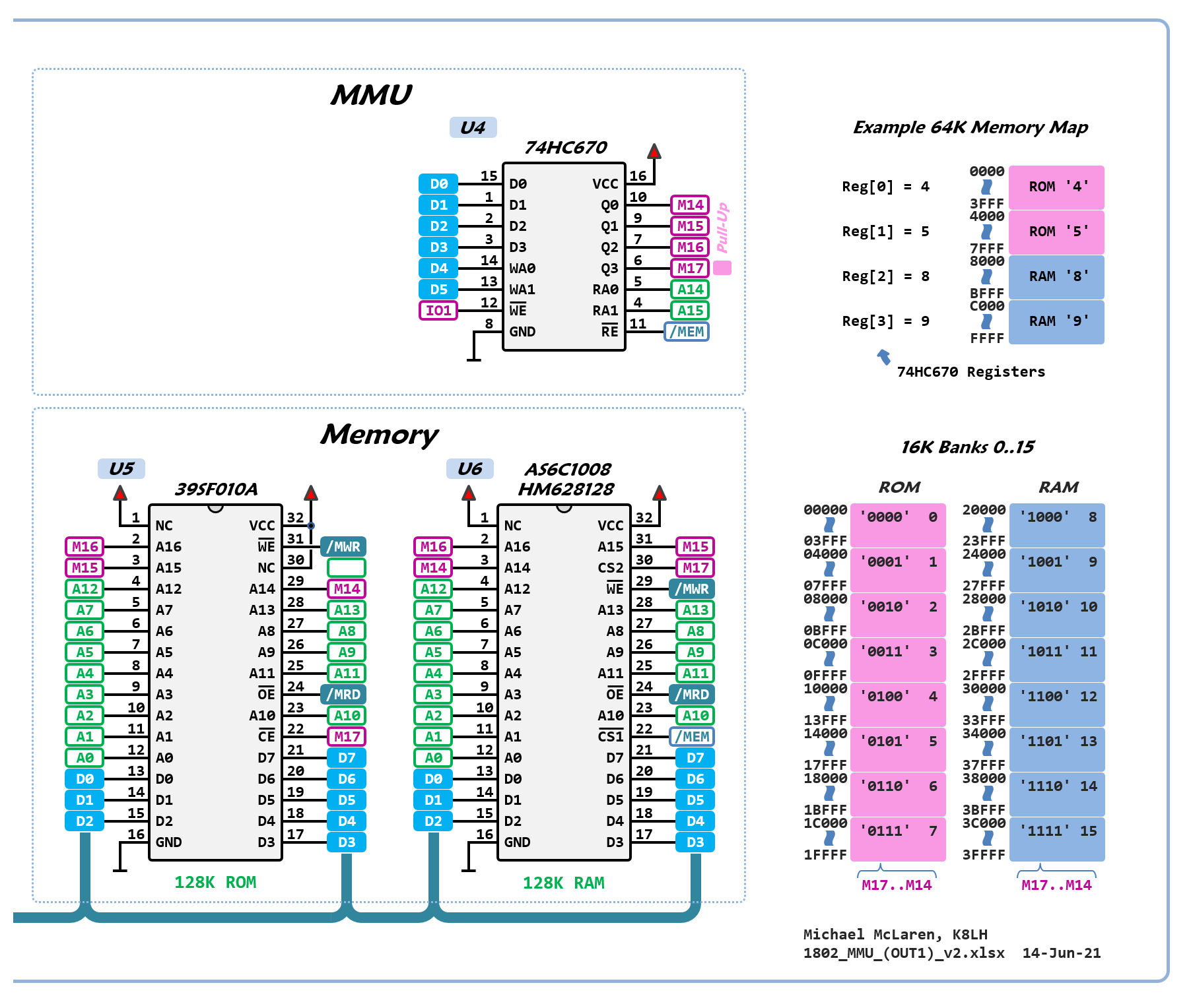

Speaking of banking... I was wondering if the 74HC670 "4x4 Register File" IC might be a relatively simple and elegant solution for mapping RAM or ROM into 64K address space? I'm just not sure how you could force a particular block of ROM into the $C000..$FFFF space during power-up in order to load initial or default values into the four register files. Anyway, food for thought...
- Attachments
- 74HC670.pdf
- (398.89 KiB) Downloaded 63 times
Re: Attempting to build a simple 6502 SBC from scratch (65ad
(Food for thought indeed - see perhaps also @hoglet's design for the 6809 over here.)
AND(Ф1, NOT(/EN))/EN comes from I/O my address decoder ('138) and is not synced with Ф, so it's low as long as the address line is valid.
"Latch" in my diagram is an input to clock pin of '273. I think I should have called it "74x273 clock" in my diagram.

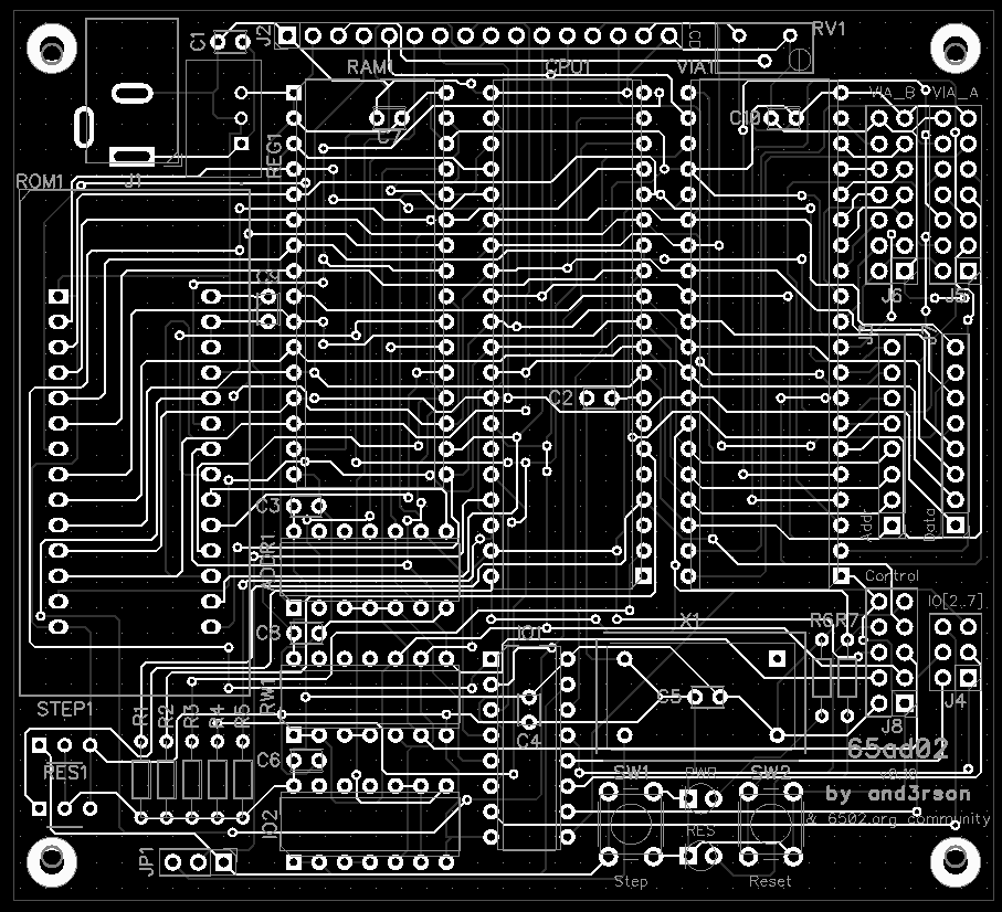

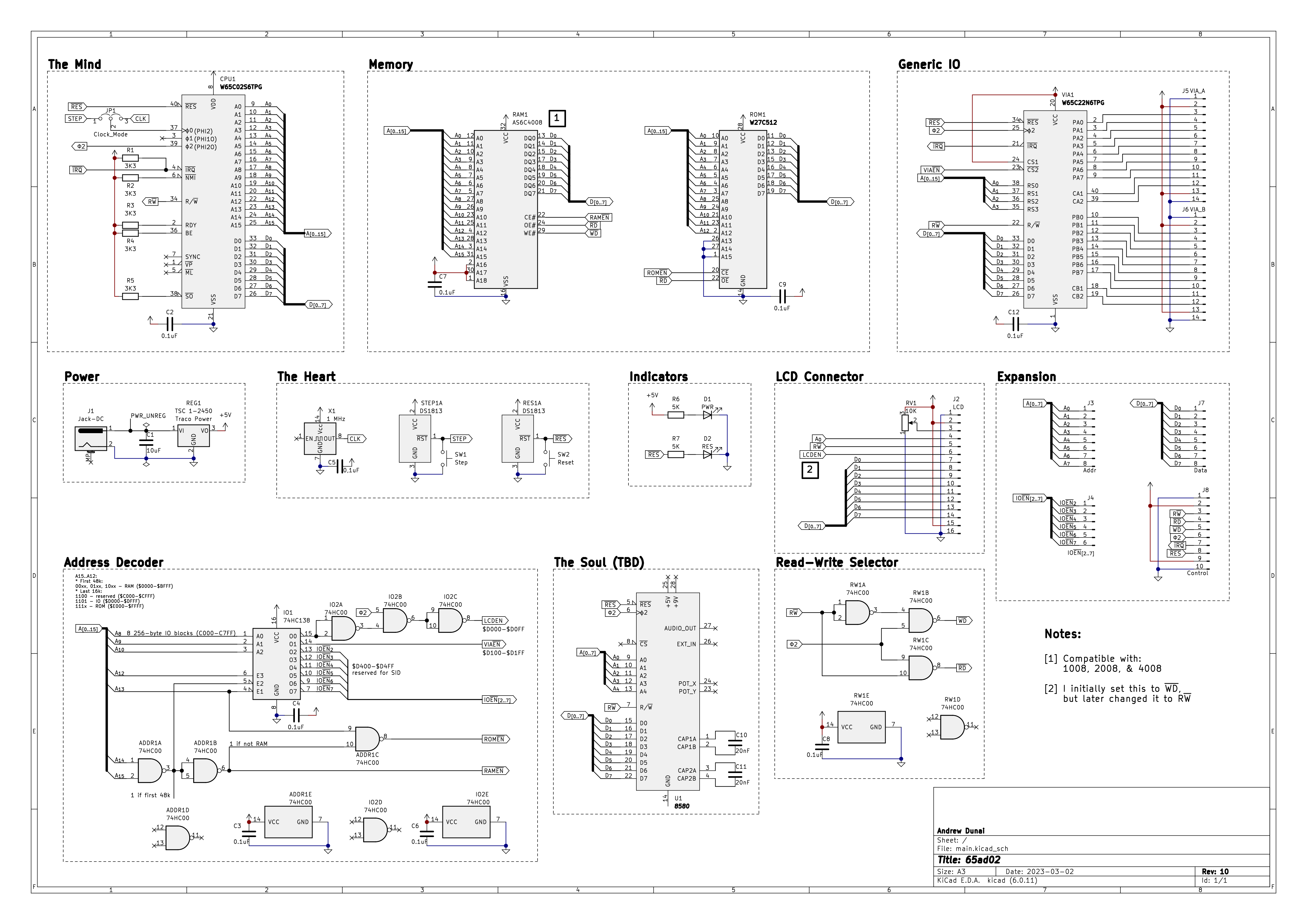

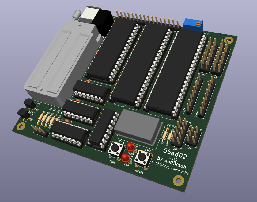

Great success - I've managed to squeeze an extra NAND into my board! And it's still less than 100 cm² (15.5 in²). Diptrace's autorouter was struggling with this design, so I had to move some chips around a little bit in order to successfully route all traces.
Also, I forgot to mention that Diptrace works perfectly in Wine! It's even mentioned on their website. I've been running it on my GNU/Linux under Wayland without a single problem.
I also hid some caps under chips - I'm having all of them socketed (event oscillator, using a machine-tooled P14P socket with all but 4 outmost pins removed with a thin screwdriver), so there's some extra clearance to place stuff underneath.
I cloud have hidden the resistors as well, but I really like boards where resistors are all nicely lined up and visible. I also kept some caps visible for the same reason.
Additionally, I've manually traced decoupling capacitors for this version. I've made a mistake in a previous design by allowing autorouter to do this, and as expected - it didn't wire them to where I wanted. Hindsight is 20/20.
Finally, I'm considering an option of feeding a 9V input to the board so that I can pass it over to the extension header and have a daughterboard with 8580r5 SID & a 1/8" headphone jack. I'm using a switching Traco Power RST 1-2450 instead of a 7805 regulator, so it should be fine with 9V input.
I've also increased my sheet size to A3 to have some extra breathing space. I like how the schematic looks now!

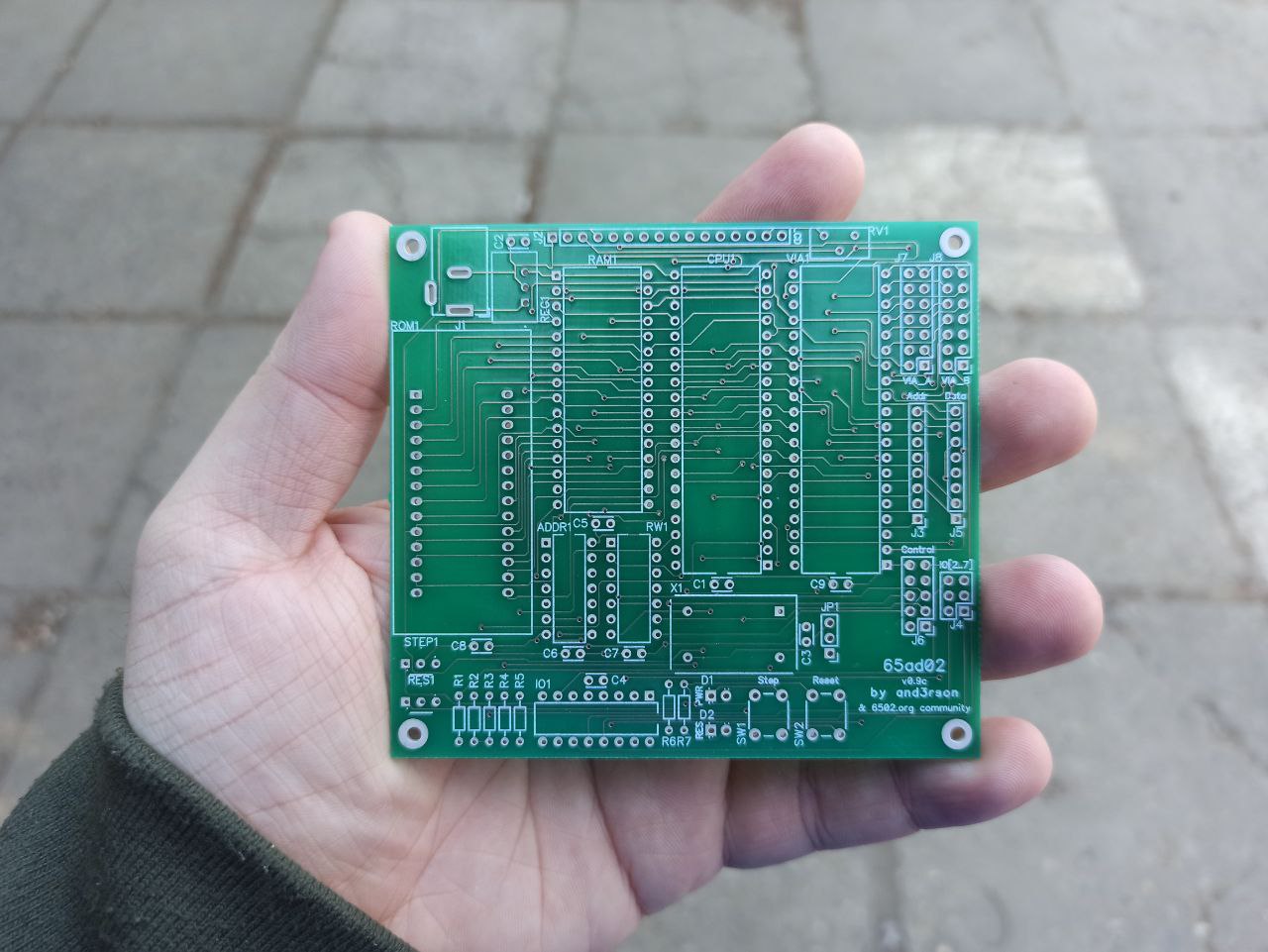

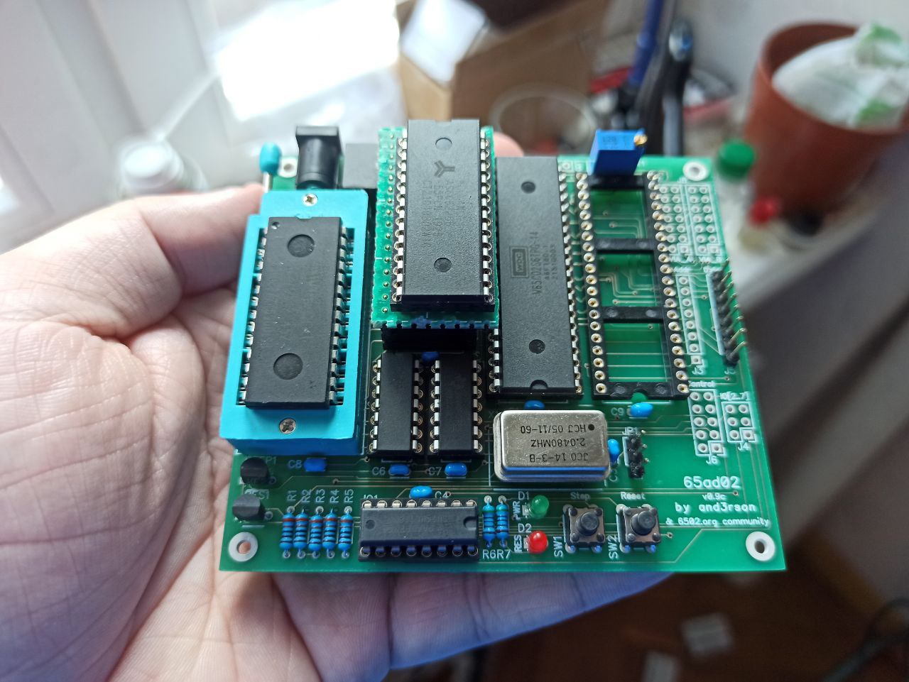

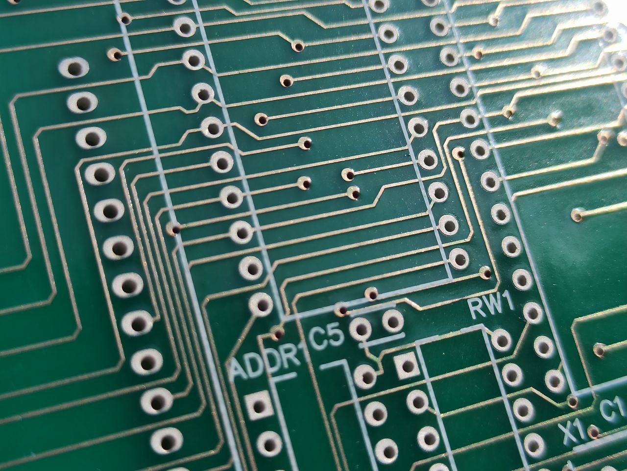

Okay, today is the big day for me. I've got a big update!
My PCB has arrived this morning:
I was almost shaking when they handed it over to me. My first real PCB ever, what a feeling to have my design manufactured in real life!

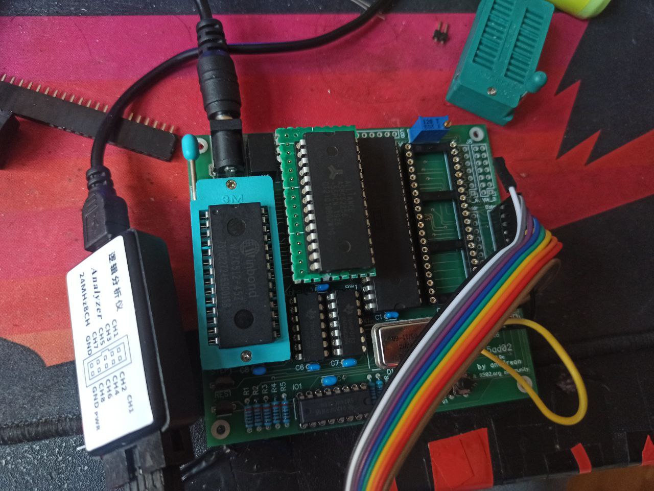

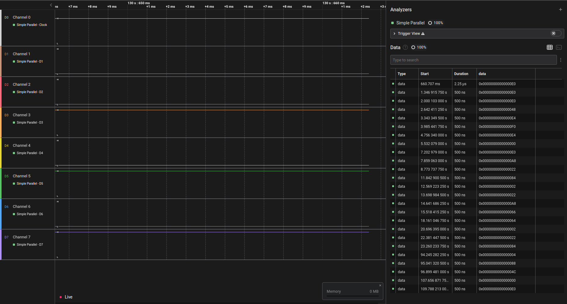

I've also bought a simple 8-line digital analyzer (Saleae-compatible). I wish I've got a 16-line model - I could really use a spare clock line! But I've decided to try with 8 lines first, and simply use D0 as clock. This would mean that I'd lose 1 data line, but I really wanted to see if anything would be happening on at the data line at all.
I've assembled a thing and witnessed my SBC in its full glory: (I'm currently using a DIP-28 SRAM, so I had to make simple adapter to insert it into my DIP-32 socket.)
At this point, I was EXTREMELY happy I've added pin headers for major CPU lines (including data bus & Ф2). Connecting an analyzer was a piece of cake:
I've then flashed my W27C512 with a simple program (vector setup & zeropage excluded for brevity) that adds $22 + $66:

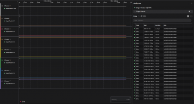

I then set my clock mode to manually triggered (using JP1) to step 1 cycle at a time using a button, launched Saleae analyzer UI (it worked out of the box on my Arch), and held my breath.
I hit "Step" switch several times, and I was presented with this absolute beauty: Here's the dump:
IT WORKS! Address & read-write selectors (NAND glue) seems to behave just as they should!
You'll notice that the values don't match the actual opcodes (e. g. STA (zp) has opcode $85, but it's shown as $84 in my dump). This is because I've sacrificed D0 (lowest data line bit) in favor of feeding Ф2 to analyzer, so all captured values are rounded down to closest even value (D0 is always low).
I'm still sitting here in awe. Need a breather to proceed with connecting LCD.
name type start_time duration data
Simple Parallel data 0.660707 2.25e-06 0x00000000000000E0
Simple Parallel data 1.34691575 5e-07 0x00000000000000E0
Simple Parallel data 2.000103 4.99999999e-07 0x00000000000000E0
Simple Parallel data 2.64241125 5e-07 0x0000000000000048
Simple Parallel data 3.3433495 5e-07 0x00000000000000E4
Simple Parallel data 3.98544175 5e-07 0x00000000000000F0
Simple Parallel data 4.75634 5e-07 0x00000000000000E4
Simple Parallel data 5.532079 4.99999999e-07 0x0000000000000000 <======\
Simple Parallel data 7.202979 4.99999999e-07 0x00000000000000E0 <===== Init vector value
Simple Parallel data 7.859063 5e-07 0x00000000000000A8 <===== LDA (zp), should be $A9 (see explanation below)
Simple Parallel data 8.77373775 4.99999998e-07 0x0000000000000022 <===== $22
Simple Parallel data 11.8429005 4.99999998e-07 0x0000000000000084 <===== STA (zp)
Simple Parallel data 12.5692233 5e-07 0x0000000000000002 <===== V0
Simple Parallel data 13.6989845 5e-07 0x0000000000000022 <= write to RAM
Simple Parallel data 14.6416862 5.00000002e-07 0x00000000000000A8 <===== LDA (zp), should be $A9
Simple Parallel data 15.5184153 5e-07 0x0000000000000066 <===== $66
Simple Parallel data 18.1610468 4.99999998e-07 0x0000000000000064 <===== ADC (zp)
Simple Parallel data 20.696395 5.00000002e-07 0x0000000000000002 <====== V0
Simple Parallel data 22.3814475 5.00000002e-07 0x0000000000000022 <= read from RAM
Simple Parallel data 23.2602338 5.00000002e-07 0x0000000000000084 <===== STA (zp), should be $85
(at this point, I just sat for a whole minute, not being able to fully comprehend what did just happen - did I REALLY just see $22 and $66?!)
Simple Parallel data 94.2452823 4.99999995e-07 0x0000000000000004 <===== V1
Simple Parallel data 95.0413205 4.99999995e-07 0x0000000000000088 <===== Result of adding $22 + $66 (!)
Simple Parallel data 96.899481 4.99999995e-07 0x000000000000004C <===== JMP to absolute
Simple Parallel data 107.656872 5.00000009e-07 0x0000000000000000 <======\
Simple Parallel data 109.788213 4.99999995e-07 0x00000000000000E0 <===== $E000 (ROM start)

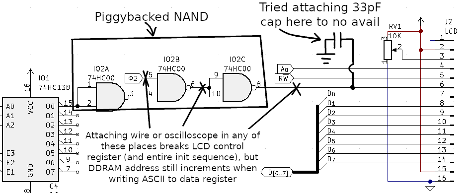

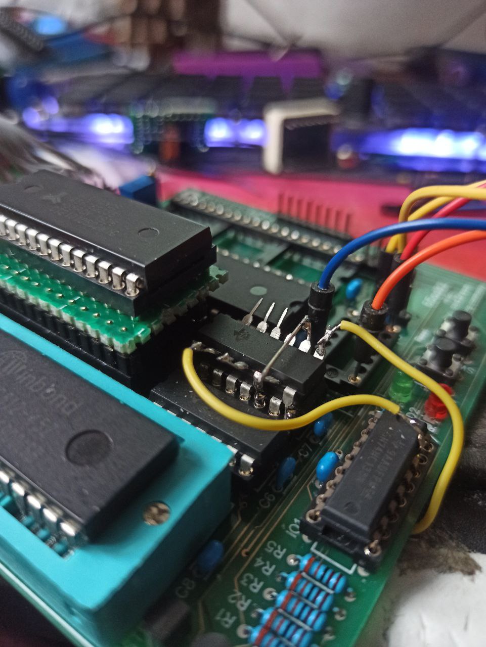

I'm having a new problem now: the LCD.

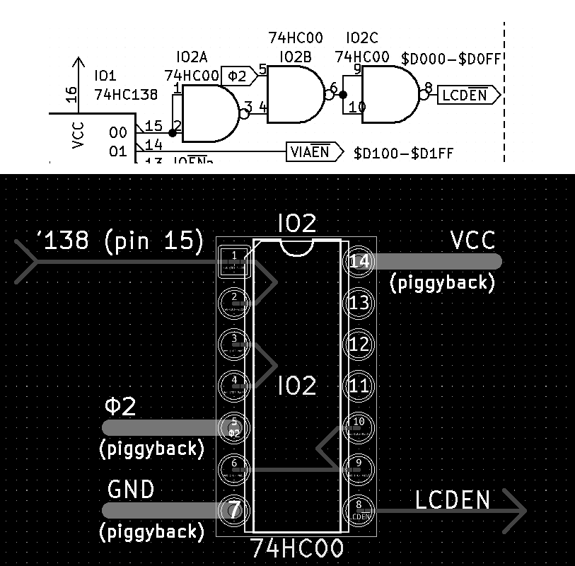

I've added an additional 74HC00 on top of my RW1 so that I could convert LCD/EN into LCDEN and sync it with Ф2: I've then rewired a low-active LCD/EN to to through this NAND and become LCD/EN as described here:
http://www.6502.org/mini-projects/optrexlcd/lcd6502.gif
And this is where all the weird stuff started happening.

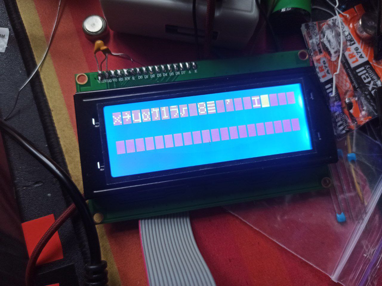

The screen is initialized, but I can only see the garbage being printed: (The string I'm attempting to print is "ABCDEFGH01234567".)
No matter what I tried, I couldn't produce any actual characters. The screen initializes, the cursor advances, but the garbage is always there.
I've tried clocking my SBC at 2MHz, 1.8432MHz, 1MHz, 500KHz, 100KHz, 10KHz, 1KHz, and even 100Hz - it's still the same.
Writing to HD44780's control register still works fine, I can read the busy flag & the DDRAM address just fine.

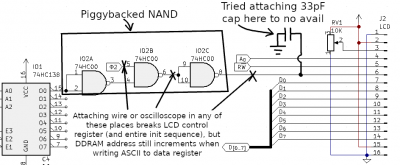

Now, here's the weirdest part: if I connect a wire longer than ~5 inches to Ф2, leaving the other way unconnected, the LCD initialization commands don't seem to have any effect, but writing to data register still advances the caret (although text is not visible), because if I read the control register, I can see that the DDRAM address has increased).
It happens whenever I connect a piece of wire, an oscilloscope probe, or a digital analyzer to either of the following places:
- Ф2;
- Between 2nd & 3rd quarters of NAND (http://www.6502.org/mini-projects/optrexlcd/lcd6502.gif);
- Ф2;
- Directly to LCD's Enable pin.
I thought there was some voltage drop or extra capacitance on Ф2, but my scope still shows sharp edges on it. Additionally, the CPU still works normally, and LCD even seems to properly clear the busy flag (because my CPU doesn't hang on LCDBUSY routine).
In all of the above cases, I never saw any noise or voltage drop on Ф2 with my scope, and my digital analyzer always showed correct values of data bus at all times.
I've also tried adding filters on LCD's power terminals & Enable pin - no luck. Is there anything else I need to do to make the Enable pin work properly? It seems to be overly sensitive or something.
I also tried using 7805 instead of my TSR 1-2450.
Finally, I've tried adding a 20K pull-up (and pull-down) at Enable line.
Some more details:
- The ribbon cable between the board & the LCD is around 3-4" long.
- I also tried jumpers instead of the ribbon cable. I also tried connecting LCD directly to the main board without cables.
- The garbage pattern does not change when hitting "Reset", but DOES change when power-cycling the board. However, the first character is almost always lowercase "x". (The string I'm attempting to print is "ABCDEFGH01234567")
Any thoughts would be appreciated!
EDIT: I'm suspecting that the display itself might be faulty (unlikely, but still possible, especially with all the knock-off models)... Will try a different one just to be sure.
