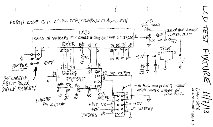

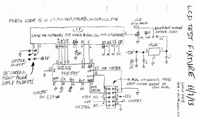

The SR changes the data line to the next state immediately after the falling edge. It idles with the clock line high, and the first falling edge has invalid data. It expects the receiver to clock the data in on the rising edge, which is what the '595 does, as it is positive-edge-triggered. The following is a diagram of an LCD test fixture I made with connectors for various LCD brands, using a '595 and 4-bit mode. It's from the 3x5" quick-reference ring binder I keep on the workbench for my workbench computer. What should be labeled, but isn't, is that the 595's clock input, pin 11, which goes to pin 1 of the header to my workbench computer, is the VIA1CB1 connection. No inverters. I've used this fixture to test quite a few different intelligent character LCDs (all of which worked fine with it).
I can post my code, but it's in Forth.
PostPosted: Sat Apr 16, 2022 3:26 pm
Posts: 489
Studying your schematic, I think that you never check the busy status of the LCD. I'm guessing that means you use software timers in your FORTH code to make sure you wait long enough between bytes. Do I have that right?
Also, looking at the way you have the latch clock connected, I suspect you wait until all 8 bits are shifted into the 595, then use one pulse on PORTB7 to latch the whole byte at once. That is a cool idea. I tied those two together so that the output register was always one bit behind the shift register, as described in the datasheet. I think I have been overcomplicating things. I'll have another go at it this this afternoon.

Posts: 8514
Yes; I've always just given it enough time to just make sure it's ready for the next instruction, rather than polling it. The Hitachi driver IC's data sheet has the maximum execution timings listed so you can know how much to give it to be safe if you don't poll.
Right.

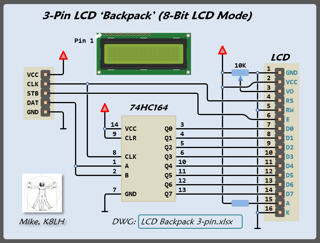

Posts: 588
Which pins on the VIA are being used in SR mode to drive the CLK, DAT, and LAT inputs on the '595, please? Can the CLK pin be re-tasked to output a '0' or a '1' after shifting 8-bits into the '595 shift-register?
I've used two or three pins to drive a 74HC595 or 74HC164 and an HD44780 type LCD display in 8-bit mode. Basically, one line is used to both latch the '595 outputs and strobe the LCD 'E' input and the CLK line is re-tasked to drive the LCD 'RS' (Register Select) input after loading 8-bits into the '595 shift-register. I'm just not sure how you might re-task the CLK line in VIA SR mode. An Arduino demo' is attached...

Posts: 588
Perhaps you could just use CB2 plus two port pins and bit-bang the driver and enjoy using the LCD 8-bit interface mode? Also, there may be an advantage using the 74HC164 over the 74HC595. That is, the ability to load 8-bits of data onto the outputs without sending it to the LCD which might come in handy for driving column or row lines on a multiplexed keypad or display (???).

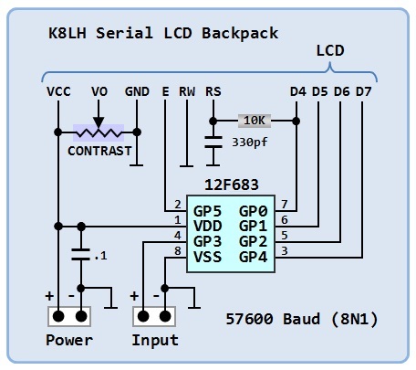

Posts: 588
There are also serial LCD backpacks that might be driven by a single VIA pin (bit-banged serial). I created one long ago using an 8-pin 12F683 PIC (see below) but a more up-to-date version might use an 8-pin 16F15313 ($ 1.03 @ Mouser) which can be programmed using a relatively inexpensive Arduino Nano clone.
