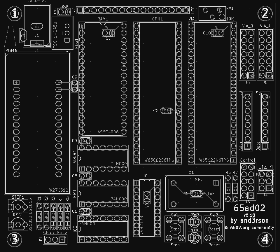

Posts: 163
Location: Lviv, Ukraine
Great success - I've managed to squeeze an extra NAND into my board! And it's still less than 100 cm² (15.5 in²). Diptrace's autorouter was struggling with this design, so I had to move some chips around a little bit in order to successfully route all traces.
Also, I forgot to mention that Diptrace works perfectly in Wine! It's even mentioned on their website. I've been running it on my GNU/Linux under Wayland without a single problem.
I also hid some caps under chips - I'm having all of them socketed (event oscillator, using a machine-tooled P14P socket with all but 4 outmost pins removed with a thin screwdriver), so there's some extra clearance to place stuff underneath.
I cloud have hidden the resistors as well, but I really like boards where resistors are all nicely lined up and visible. I also kept some caps visible for the same reason.
Additionally, I've manually traced decoupling capacitors for this version. I've made a mistake in a previous design by allowing autorouter to do this, and as expected - it didn't wire them to where I wanted. Hindsight is 20/20. :D
Finally, I'm considering an option of feeding a 9V input to the board so that I can pass it over to the extension header and have a daughterboard with 8580r5 SID & a 1/8" headphone jack. I'm using a switching Traco Power RST 1-2450 instead of a 7805 regulator, so it should be fine with 9V input.
I've also increased my sheet size to A3 to have some extra breathing space. I like how the schematic looks now!
EDIT: Received an email from Mouser that my package shipment has been released. Looking forward to receiving my VIA & ACIA!
EDIT 2: I'm also planning to order several low-profile Aries ZIF sockets (DIP-28), seems like they might save me some space in my quest for cheap PCB manufacturing.
/Andrew

It happens whenever I connect a piece of wire, an oscilloscope probe, or a digital analyzer to either of the following places:
- Ф2;
- Between 2nd & 3rd quarters of NAND (http://www.6502.org/mini-projects/optrexlcd/lcd6502.gif);
- Directly to LCD's Enable pin.
I thought there was some voltage drop or extra capacitance on Ф2, but my scope still shows sharp edges on it. Additionally, the CPU still works normally, and LCD even seems to properly clear the busy flag (because my CPU doesn't hang on LCDBUSY routine).
In all of the above cases, I never saw any noise or voltage drop on Ф2 with my scope, and my digital analyzer always showed correct values of data bus at all times.
I've also tried adding filters on LCD's power terminals & Enable pin - no luck. Is there anything else I need to do to make the Enable pin work properly? It seems to be overly sensitive or something.
I also tried using 7805 instead of my TSR 1-2450.
Finally, I've tried adding a 20K pull-up (and pull-down) at Enable line.
Some more details:
- The ribbon cable between the board & the LCD is around 3-4" long.
- I also tried jumpers instead of the ribbon cable. I also tried connecting LCD directly to the main board without cables.
- The garbage pattern does not change when hitting "Reset", but DOES change when power-cycling the board. However, the first character is almost always lowercase "x". (The string I'm attempting to print is "ABCDEFGH01234567")
Any thoughts would be appreciated!
EDIT: I'm suspecting that the display itself might be faulty (unlikely, but still possible, especially with all the knock-off models)... Will try a different one just to be sure.
/Andrew
