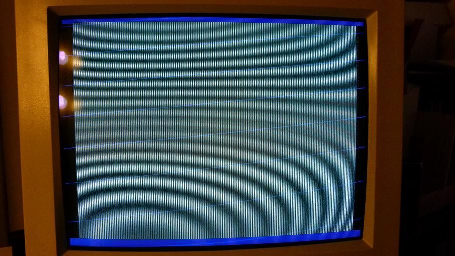

Well this was the best I could do without help:

And the result:

Instead of picking colors based on countflag and hblank/vblank, you could make a x/y counter.
Restart x = 0 at htstart, and increment x when countflag = 1. If you get it right, x should go from 0 to 639 (for normal VGA). Then, you can select a pixel color based on x value.

Counters, yes I started with counters earlier. So I modified my code and have this now, with same action in previous pic:

Much easier to see in sim now I can see the X counter, it is resetting properly...
Now that nasty retrace going across the back of the screen, how do we get rid of it? Is it possible for a different colored border without using the videoDAC DACBLANK signal? or will we be forced to use black borders?
EDIT: video is presently 320x200.
