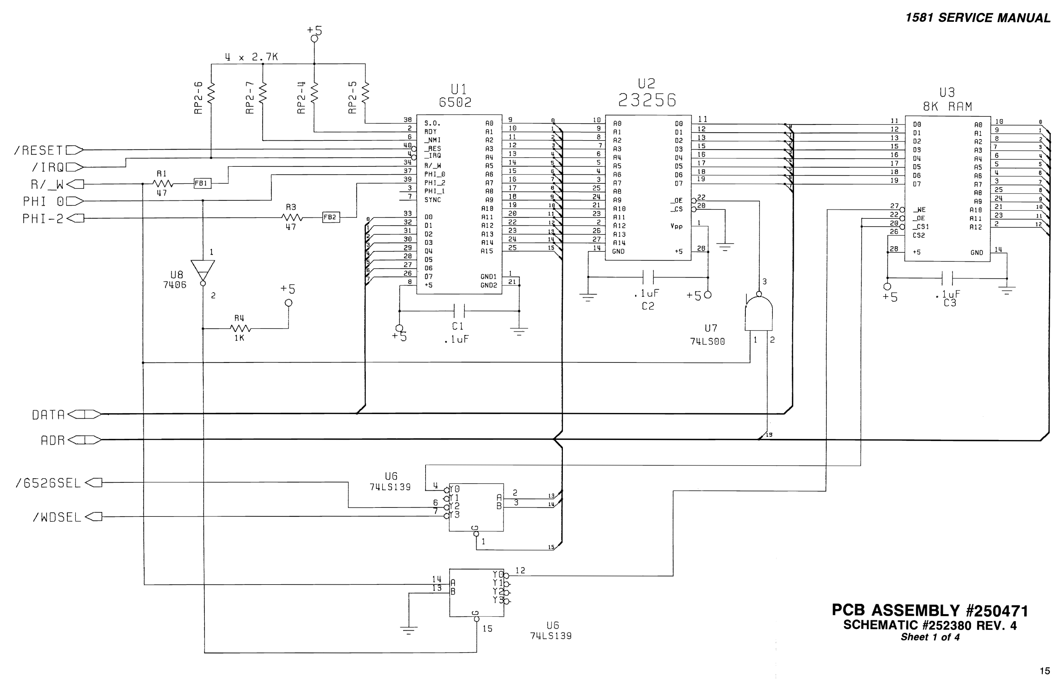

Using the 74139 for I/O decode and read/write with clk2 validation goes way back. I posted Doug Beattie's schematic (dates back to 2000) here:
viewtopic.php?f=4&t=6667&p=84821&hilit=diy6502a#p84821
Jeff converted it to black and white which is much easier to see.
Also, the Commodore 1581 diskette drive did much the same using a 74139, which dates back to 1987:
What's old is new :wink:

kernelthread wrote:
Paganini wrote:
My current favorite memory interface is this one...
That's quite a nifty little circuit.
However, using the '139 to gate the read/write signals is slower than this circuit:
True, but not by much. Max propagation delay for the AHC139 is about 9ns, which is one ns slower than AC00. :)
ETA: Not strictly on topic, but:
In this case, what's old is old, as the linked thread is from 2004! (Or maybe what's new is old?) When I first started reading 6502.org about 3 years ago, that nearly 20 year old thread was one that really helped my understanding of Ø2 and memory read/write timing "click." So much so that I still had that diagram from it saved on my desktop! And here I am, 3 years later, sharing it with another new person who will hopefully benefit from it as much as I did. This is one of my favorite features of this forum.
