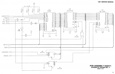

Also, the Commodore 1581 diskette drive did much the same using a 74139, which dates back to 1987:
What's old is new :wink:

kernelthread wrote:
Paganini wrote:
My current favorite memory interface is this one...
That's quite a nifty little circuit.
However, using the '139 to gate the read/write signals is slower than this circuit:
True, but not by much. Max propagation delay for the AHC139 is about 9ns, which is one ns slower than AC00. :)
ETA: Not strictly on topic, but:
In this case, what's old is old, as the linked thread is from 2004! (Or maybe what's new is old?) When I first started reading 6502.org about 3 years ago, that nearly 20 year old thread was one that really helped my understanding of Ø2 and memory read/write timing "click." So much so that I still had that diagram from it saved on my desktop! And here I am, 3 years later, sharing it with another new person who will hopefully benefit from it as much as I did. This is one of my favorite features of this forum.

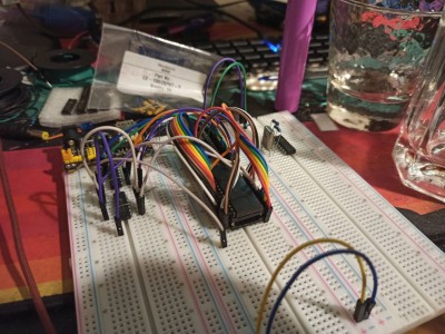

Few updates:
- I've started prototyping my design on a breadboard (mostly for testing things around, since in the past I've had some really bad luck with parasitic capacitances, wobbly connections & shitty chinese jumpers). As soon as I get the desired layout & selection of components, I'm going to move everything to a perfboard for a functional prototype before going for the PCB.
- Primer suggests to use 74LS04 for oscillator specifically. I disregarded that and used my 74HC00 with a 3.072 MHz crystal I've had around. Needless to say, it didn't work. :D As soon as I replaced it with 74LS04, I could get the oscillation like a charm.
- I can't wait for my W65C02S from Mouser, but I feel like it's going to take forever: their processing is slow, and the mail has also been rather slow recently.
Here's a mess I've made out of my breadboard so far. My next stop is caps, RAM & the CPU itself. Might take a while before I have those parts on me...

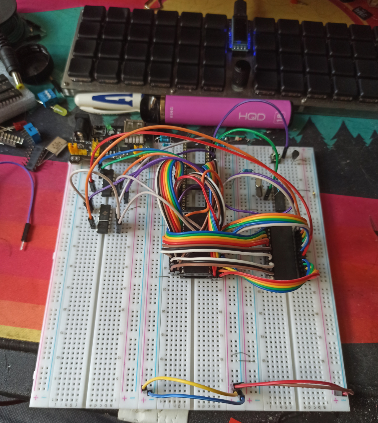

Actually, I was just thinking how painful it will be to remove EPROM, since every time I want to update the code I'll need to re-flash it. Your suggestion of using one of those boards for clock actually gave me an idea to use Nano as a simulator for DIP-28 ROM! I think there *should* be enough pins (12 addr + 8 data + /CE & /RD interrupts) for the task. Also, I'm not sure if 16MHz will be enough for this, I'll see if I manage to write a code that will take less than 8 CPU cycles of Nano to read the data (and I have serious doubts about this). As a last resort, I can just underclock my W65C02S so that Nano has more time to assert the data line.
I have a whole lot of ESP-based boards (NodeMCU, etc), but there's not enough pins on them. Might consider ESP32 for this, though it feels like an overkill. But hey - as long as it works!
EDIT: Note to future self - "never put EPROMs in the middle of the board with too many jumpers around, you'll need to remove it pretty often..."
EDIT 2: OK, so atmega328p & ESP-32 are off the table: the former takes 11 cycles to jump into ISR (687.5ns, source: https://www.embeddedrelated.com/showthr ... 1437-1.php) and the latter takes astounding 500 (!) cycles fo this - i. e. ~2us (source: https://www.esp32.com/viewtopic.php?t=422)... And that's the time it takes them just to start executing ISR.
