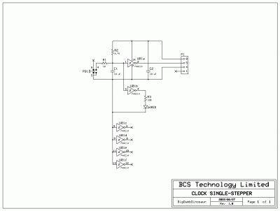

The idea of single-stepping the clock is to be able to hold bus conditions so you can take accurate measurements using a DVM. As the WDC 65C02 may be stopped with the clock held in either phase, this is a convenient method of testing something that is elusive during normal operation.

MPU Clock Single-Stepper

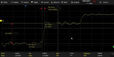

On the subject of RAM chips and which are/are not appropriate I went through my inventory of 32Kx8 SRAMs and tried them out in a working design and scoped the data bus for Voh when they were writing.
The system in question is very small, on a 4 layer PCB and running at 14MHz. The components on the data bus are: W65C02, SST 27SF256 EEPROM, an Intersil CDP65C51, the memory in question and a scope probe with a scope attached to it. The capacitance of the data line with the scope attached measured at 62pF.
From best to worst:
Samsung KM68257BP - 4.84V average from 4 samples
Winbond W24257AK - 4.24V average from 10 samples
Cypress CY7C199 - 4.12V from 3 samples
Toshiba TC55328P - 3.53V from 4 samples
The interesting thing is all of these are spec'd the same: Voh=2.4V @ 4ma. Clearly they are not the same.
BTW, they all work in that board with no issues.
Another thing of interest. Given the stray capacitance of 63 pF, you'd expect, according to the spec sheet and the calculation done by Garth earlier in this thread, that these chips would have a 3V rise time of in the order of t ~ (3V*62pF)/4mA ~ 42.6nS.
The worst of them, the Toshiba, was measured at ~4.4nS! 10 times better!
Well, the situation is as clear as mud and in my estimation we can't take any of the data sheet information seriously. From my perspective, I will stick to the Samsung and Winbond chips going forward.
BTW, here is the measurement of the data line capacitance with the scope attached.

Thank you BDD. And thank you for the single stepper schematic

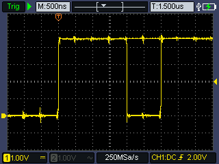

Here are some recent shots from my (ahem) oscilloscope:
This is phi2 at the 'C02 pin37 with the probe GND lead removed and a GND spring to the oscillator can (its that close)

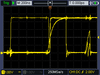

Here is D1 (with its pullup attached) at the RAM chip pin
D1 at RAM pullup.png (5.96 KiB) Viewed 1586 times
Clock noise is everywhere and what are those curved - really slow rise lines on D1 (with pullup) (they are also on D2-7)?

Those 5V voltages you are showing on the data lines are likely from the CPU. I do see a runt pulse in one of the data line shots. However, it's difficult to know where that is coming from.
You need to look at the data line when both the RAM /CS and /OE lines are low at the same time. That is when the RAM is driving the data buss.
But that runt pulse is a little weird. It could be a timing problem (two devices trying to drive the bus in opposite directions at the same time), a short to another data line or even a weak device trying to drive the bus high.

I don't see anything unusual. Clock noise is normal, some is instrumentation induced. Data lines are generally chaotic; they only need to be stable around the falling edge of the clock. With pull up resistors on data lines you'll see slow rising waveform because of the pull-up resistor overcoming the data bus capacitance. The waveform you need to watch out in any signals (data/address/control) is mid-value steps in the range of 1-2V with sharp rise and fall before/after the steps. That's strong indication of contention. Generally there is a supply voltage spikes coincide with the steps because of large current draw at the time of contention.
... in the first half of the cycle. To be clear in case anyone's wondering, I'm sure Bill is referring to the Phi2-low time, during which neither the CPU nor memory/IO is driving the bus.
