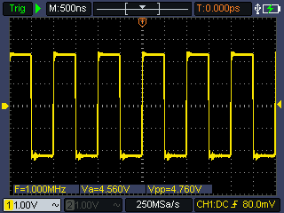

One possible fault that might cause writes to be missed is a clock integrity issue that caused additional clock transitions to be seen by the CPU. This might generate occasional, very short write cycles. It's possible that cross-talk from several drivers turning on at the same time (during a RAM write cycle) is getting coupled back onto the CPU clock.
Sometimes just adding capacitance (e.g. a scope probe) to the clock pin of the 6502 is sufficient to change the symptoms significantly.
What scope model do you have?
BTW, this is the sort of problem a cheap logic analyzer and the 6502 Decoder can help with. The 6502 Decoder maintains a model of memory, and checks this model on every read cycle. Any inconsistencies are flagged, and you can usually infer quite alot about the nature of a fault from the pattern of errors.

I do have a simple oscilloscope. I assume you are suggesting single stepping because you are not aware of that or is it for some other reason?
Okay. I don't think I am overloading. I am using all HC glue chips and all WDC CMOS parts.
I will go back and re-test. I'm not at all sure whether its read or write faults any more. A lot of water has passed under the bridge since I made the "read error" statement.
I have a handheld Owon HDS242S. Not a great scope but better than nothing.

Regarding the clock. The oscillator can is right next to the 'C02 phi2 input pin.
In the attached image (sorry, its old but not much has changed) the 1mHz oscillator is just above the Alliance memory next to the CPU. Its even upside down so the output is nearer the phi2 pin! The wire is about 3/10th inch. I have a capacitor across the power/gnd of the oscillator. Is there anything else I can do to improve things from the point of the oscillator spewing unwanted rubbish out into the rest of the lines? I even (in my naiveity) tried to find micro miniature coax for the clock line. No such thing available as far as I can find.
When you say the oscillator might not be "properly specified". I didn't go to a lot of trouble I will admit. It is marked ECS-2100 and the datasheet says "The ECS-2100X Series clock oscillator offers low current drain and is compatible with HCMOS/TTL logic".

When an intermittent problem is "cured" by lower supply voltage, system noise is a likely candidate. This is because lower voltage slows down the devices and reduces rail-to-rail voltage swing thus reducing system noise. Contention can also be affected by supply voltage because the drive output weaken and caused less power spike.

Another thing of interest. Given the stray capacitance of 63 pF, you'd expect, according to the spec sheet and the calculation done by Garth earlier in this thread, that these chips would have a 3V rise time of in the order of t ~ (3V*62pF)/4mA ~ 42.6nS.
The worst of them, the Toshiba, was measured at ~4.4nS! 10 times better! Well, the situation is as clear as mud and in my estimation we can't take any of the data sheet information seriously. From my perspective, I will stick to the Samsung and Winbond chips going forward.
BTW, here is the measurement of the data line capacitance with the scope attached.

Here are some recent shots from my (ahem) oscilloscope:
This is phi2 at the 'C02 pin37 with the probe GND lead removed and a GND spring to the oscillator can (its that close) This is A0 at the CPU. You can see the clock noise Here is +5V at the oscillator pin I have the pullup resistors still attached on the data lines, so I disconnected the resistor on D0 and here is a trace of D0 at the RAM chip pin Here is D1 (with its pullup attached) at the RAM chip pin Clock noise is everywhere and what are those curved - really slow rise lines on D1 (with pullup) (they are also on D2-7)?
Sorry about the really rubbish scope folks - I know the John Ruskin quote ( https://www.nthong.co.uk/ruskin.htm ) but I regularly ignore it, much to my disadvantage!

I don't see anything unusual. Clock noise is normal, some is instrumentation induced. Data lines are generally chaotic; they only need to be stable around the falling edge of the clock. With pull up resistors on data lines you'll see slow rising waveform because of the pull-up resistor overcoming the data bus capacitance. The waveform you need to watch out in any signals (data/address/control) is mid-value steps in the range of 1-2V with sharp rise and fall before/after the steps. That's strong indication of contention. Generally there is a supply voltage spikes coincide with the steps because of large current draw at the time of contention.
