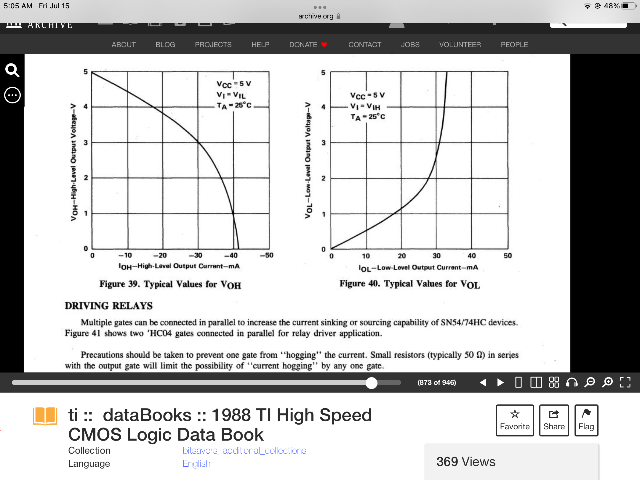

Voh and Vol characteristics of TI high speed CMOS (HC) logic family. Page 873 of 1988 TI’s high speed CMOS data book.
PostPosted: Fri Jul 15, 2022 7:20 pm
Posts: 166
The sink current graph for the ATF1508AS and the 74HC are quite similar in shape - pretty linear to 1V output, rolling over to 2V, then only a small increase in current to 5V. But the source current graph is completely different - apart from never sourcing >4V, the 1508 output is much more linear at high currents and low output voltages. It looks like the output pull-down element is a standard N channel mosfet for both the 1508 and 74HC, but whereas the pull-up element of the 74HC is a standard p-channel mosfet, the 1508 has something more complicated.
