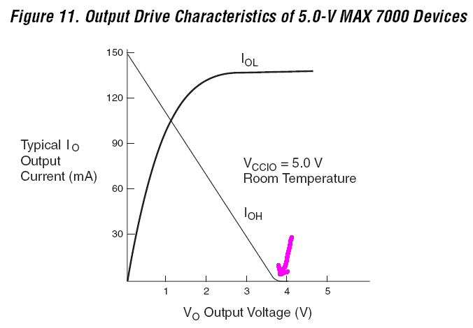

It's a shame that data sheets typically say so little about output characteristics. But, as an exception to the rule, here's a graph that's far more revealing:
This CPLD is described by its manufacturer as CMOS, and internally it probably is. But its output stage does not behave like the simple stacked MOSFET outputs we are familiar with. Specifically, Vo fails to even approach the 5V rail... even when the output current (ie, load) is zero. I don't see how this graph can be reconciled with your suggestion (in this post) that the output, when in its high state, can be modeled as a simple resistor to Vcc.
This is not CMOS like we had in the old days. So, correct me please if I've mistaken your point, but if you're saying that any CMOS chip is automatically OK voltage-level-wise to drive other CMOS, I can't agree. There's definitely been a change since you & I entered the biz. These new-fangled, so-called "CMOS" outputs on 5V-powered LSI devices do still manage to produce levels that conform to TTL spec. But we can't assume that they exceed the spec by a greater margin simply because of the device's CMOS-ness! :)

Looks a bit like 2 or 3 diodes and a 25 ohm resistor all in series. But if you run it with VCCIO=3.3V somehow the diodes are bypassed. For some reason they've gone out of their way to limit the positive voltage excursions when running on 5V. I wonder if the idea is you can connect the outputs to 3.3V logic? VccIO can be 5V or 3.3V, but VccINT is always 5V. It would be more understandable if the guts ran at a lower voltage than the I/O.

I've not seen what I would consider to be a satisfactory explanation of how it's done, or why. It could be there is some sort of LDO regulator involved so VCCIO is internally 3.3 volts open circuit, no matter the external VCC.

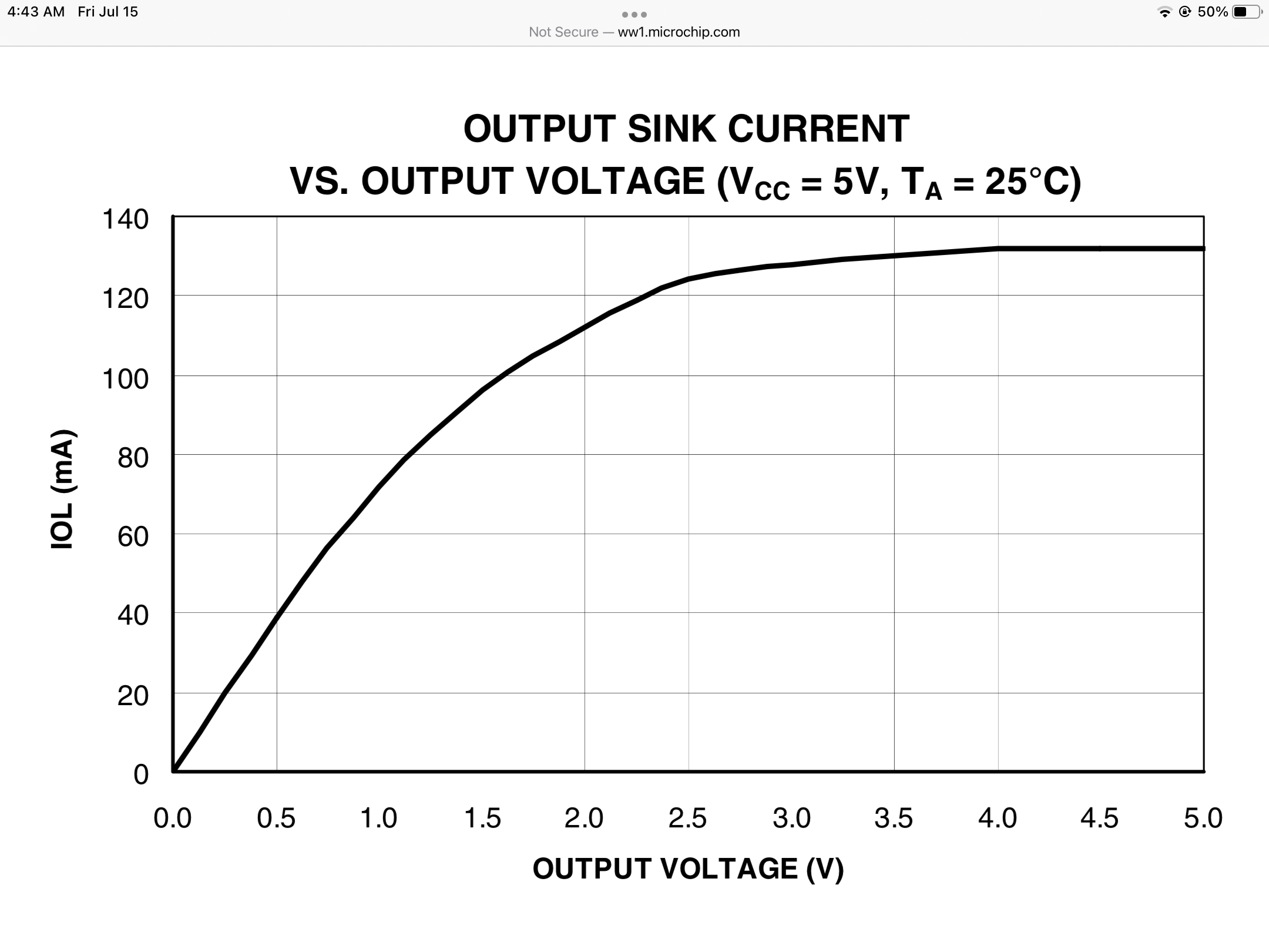

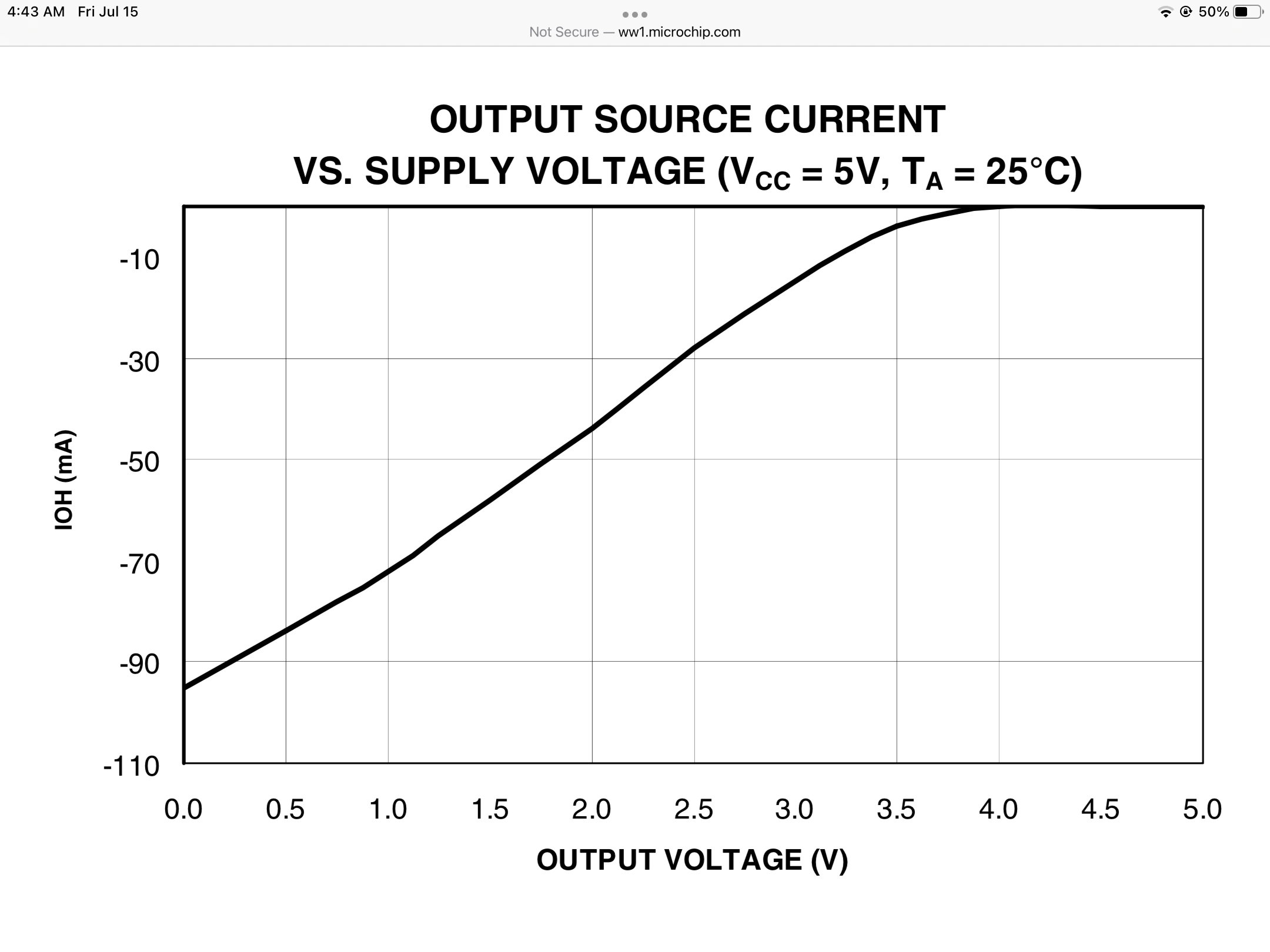

Here are a couple pictures from page 17 of ATF1508AS data sheet that are of interest to this topic.
File comment: Output source current vs voltage (Voh vs Ioh)
File comment: Output sink current vs voltage (Vol vs Iol)

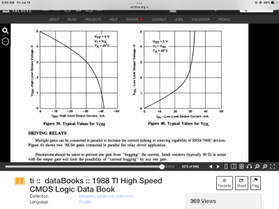

Voh and Vol characteristics of TI high speed CMOS (HC) logic family. Page 873 of 1988 TI’s high speed CMOS data book.
PostPosted: Fri Jul 15, 2022 7:20 pm
Posts: 166
The sink current graph for the ATF1508AS and the 74HC are quite similar in shape - pretty linear to 1V output, rolling over to 2V, then only a small increase in current to 5V. But the source current graph is completely different - apart from never sourcing >4V, the 1508 output is much more linear at high currents and low output voltages. It looks like the output pull-down element is a standard N channel mosfet for both the 1508 and 74HC, but whereas the pull-up element of the 74HC is a standard p-channel mosfet, the 1508 has something more complicated.
