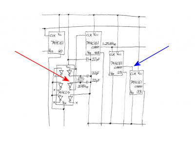

After three days of experimenting, I have a W65C02 running NOP opcodes. I have achieved this without using a multi-meter or oscilloscope. Indeed, I used a 15W soldering iron, two pairs of pliers, two breadboards, four prototyping boards of no more than 5cm*7cm, telco wire found in street, plumbing solder, about 100 LEDs (really) and a fake Arduino as an LED tester but primarily used as a USB power connector. It runs (crawls?) from a USD2 18650 lithium battery and 5V boost circuit. It uses a 16MHz ceramic resonator connected to one NAND gate and - for testing - uses chains of binary counters and indicator lights of my own devising. I call this Project Snail for many reasons:

After two days of breadboarding, I had an LED blinking at slightly less than 1Hz. (16MHz divided by 2^24.) I had also made about 22 idiot-proofed indicator lights, two boards of binary counters. At one point, I had 19 logic chips and 14 sets of indicator lights running with 22pF of decoupling. However, this strains the battery and the lights noticeably dip in unison. That was a good place to pause.
The following day, I removed most of the counter chips from the breadboard and allocated the space for a W65C02. People buying bootleg 6502s are missing the experience of unpacking the genu-wine article. It does not have the gaudy in-your-face branding of Intel but the packaging has an understated class which is rarely mentioned on the 6502 forum.
The following description is not a good example of the art. The following is a "don't touch it - it's doing something" example of the art. My first attempt at getting NOPs was to wire power and ground. I then wired various control signals directly to power. (I know this is definitely wrong but, sometimes, it helps to actually do it wrong and confirm it for yourself. The alternative is to live on superstition and rumor.) I set opcode $69 (ADC#) rather than the standard $EA (NOP) due to the dead cycle which causes NOPping to progress through address-space at half the expected speed. I placed indicator lights on high address lines and powered up. Unfortunately, nothing worked. In particular, my debug boards, constructed a mere day before, both appeared to stop working. There was working power. There was a working oscillator. The first eight bits of the chain of binary counters worked. However, nothing beyond that appeared to work. Well, that's unlikely and that part of the reason why I made multiple debug boards.
I quickly resolved the first problem. I had inadvertently made a chain of eight 4 bit counters. 16Mhz divided by 2^32 will tick very slowly and superficially appears not to work. Placing the 2^24 divider further upstream restored the slightly slower than 1Hz blink of an indicator light. However, I did not obtain a matching blink from the 2^8 division of two counter chips followed by the 2^16 division of a 6502 program counter. At this point, I thought that maybe all that stuff about pull-up resistors might be relevant. After searching through my meager spares I found a 10k resistor. Just one. This led to an idea which should definitely make the experts wince. I connected the control lines on the left side (NMI, IRQ, RDY) via one common pull-up resistor. As I was moving the reset wire on the live circuit, it started working! I initially thought that it was due to mains hum and it only worked when my fingers provided capacitance.
The current configuration (which should not be replicated) has RES, NMI, IRQ and RDY all tied high via one common resistor. BE and SO are tied directly to power. There is no reset circuit. The oscillator is intermittent. I know this is terrible but it is steadily improving. It is also apparent that a lack of components is the limiting factor. Regardless, the current configuration has been sufficient to confirm that $69 (ADC#) cycles through the address-space and double speed compared to $EA (NOP) because the immediate instruction doesn't have a dead cycle.
Obviously, the circuit requires an oscillator module and a reset module. For reset, I purchased a Maxim MCP101, as used in the Gigatron design. Perhaps I should have purchased a Dallas Semiconductors DS1813, although given the heritage of Dallas and Maxim, they are possibly the same thing.
I also require a simple mechanism to get more than 8 bits of program into the system. Therefore, I am concurrently pursuing a computer with no ROM and a computer with no RAM. I intend to keep a NOP opcode behind a 74HC245 or similar. In addition to providing debug, it is also a hook for NOP slide video generation. This can be used concurrently with a hook in the binary counter debug board which can be used for clock stretching.
I enclose a draft circuit diagram which differs significantly from implementation and neither are good examples. I usually publish more formal diagrams but I've been too busy implementing. I hope that a doodle in the style of Forrest Mims, Garth Wilson and Donald Alcock is sufficient.
I end with a message to the lurkers and newbies. So far, my efforts with 6502 hardware are approximately the slowest and least reliable ever mentioned on the 6502 forum. Your oscillator might be a little slower. Your soldering might be a little worse. You might take an extra day or two to get this far. Maybe you get stuck somewhere. However, one thing is quite certain. If you have six pull-up resistors around the value of 2.7-3.3k, a reset thing, an oscillator module and a 6502 from a reputable source then you'll be ahead of me on your first attempt.

Here is a suggestion - you're using a 7404, a crystal and 2 capacitors to make the oscillator... It's good, "classic" and seems to work for you. I decided that I'd opt for a can oscillator from day 1. One DIP-8 sized chip. Might be more expensive (marginally), but it's one less thing to worry about.
You get bonus points for the fuse too.
In your oscillator there's one inverter whose input is floating in terms of DC. This could easily explain the intermittent operation. The crystal does not provide a DC path. There needs to be a high-value resistor to supply input bias for a case like this.
You could try putting a large ( >= 1 MOhm) resistor from the inverter output to its input. This will cause the DC voltage to settle around 50% of Vcc, which is the linear region of the input stage. Ordinarily you'd *avoid* letting an input hover around 50%, but it's an unusual situation because the inverter is being used as a linear amplifier -- not the 'HC04's usual function!
Or, reconfigure the oscillator according to the second attachment (below). Also attached: a 74HCU04 datasheet; this chip is particularly relevant to linear operation, including oscillators. A web search with the terms 74HCU04 and oscillator will surely reveal more detailed info.
BTW, the manner in which you've cascaded the counters isn't entirely appropriate. That's because when the counter increments its Carry output may glitch briefly before assuming a valid state. Check the datasheet to see the proper technique. Carry ought to feed the next stage's Enable input (not Clock). Cheers,

Firstly, don't trust anything you read on the Intertubes. I have moderate difficulty with physical constants and arithmetic (most often in more familiar decimal). Adjust your expectations accordingly.
Secondly, thank you for help, especially to GARTHWILSON, Dr Jefyll and, less obviously, BigEd who makes a convincing argument to pursue hardware bug fixing as a distinct practice to software bug fixing. I remain astounded that I was one resistor short of a reliable circuit. I might have solved this eventually by following circuit diagrams more closely. Thank you for saving me from moderate frustration.
I have subsequently devised an unconventional oscillator arrangement, surveyed seven of the dodgiest NMOS 6502 suppliers which I could find on aliexpress (my favorite being the IC chip quality+++ Store selling the obviously legitimate and trustworthy 1pcs Mos 6502 MOS6502 6502AD R65C02AP MOS-6502 DIP-40 Can be purchased directly) and wrote assembly while waiting for components to arrive.

Sheep 64 on Tue 22 Feb 2022 wrote:
From Wed 2 Jun 2021 onwards, my doodles in OpenOffice were hilariously optimistic due to an one-by-one error. I wrongly assumed that I could fit 0.6 inch DIP chips at 0.6 inch spacing. I therefore thought that I could fit I2C EEPROMs, processor, bank switching latches, four parallel EPROMs and an LCD interface into 3.7 inches.
I thought that it would be informative to draw a realistic doodle. This explains some of the finer detail, such as the pull-up resistors for the processor, data bus and four serial buses and the connectors for RTC battery, parallel port, I2C bus, PS/2 keyboard, PS/2 mouse, 7SER IDC and WS2812B/UART/servo outputs from EMU and M/X.
I will explain the oscillator section in more detail. The board area for the oscillator is intended to work with 0.1 inch quartz crystal, 0.2 inch quartz crystal, 2 pin ceramic resonator, 3 pin ceramic resonator or a directly supplied clock signal. Three of these five cases involve blobbing solder across joints. With minor modification, it is possible to include 0.3*0.3 inch canned oscillator or 0.3*0.6 inch canned oscillator. However, that would require more board and it makes half of the 74HC139 redundant. (Yes, 1/2 74HC139 is used to invert crystal. In favorable conditions, this works at 64MHz.) If you include canned oscillator option, I highly recommend connecting the spare pin to power so that a universal oscillator design works with the enable input found on some canned oscillators.
While experimenting with oscillators, I found that connecting the ground pin of a 3 pin ceramic resonator to the input pin causes it clock at double frequency. I do not expect this to be stable and I recommend against this configuration. After success with ceramic resonator, I wrongly assumed that quartz crystal would be a drop-in replacement and at least 10 times more accurate. In particular, I wrongly assumed that the inverting gate's input would start low, high or oscillating and that any state would be sufficient to start oscillation. Apparently, connecting a quartz crystal may place the inverting gate into a corner case where it sits in a midway state with no current flowing. It may spontaneously switch to a ticking state after a reset signal ceases and this will clock an uninitialized processor. Presumably, a ceramic resonator avoids this case because it is leaky and acts as its own kickstart resistor. This makes me wonder if a ceramic resonator should be avoided if they are less accurate and waste energy.

Sheep64 wrote:
While experimenting with oscillators, I found that connecting the ground pin of a 3 pin ceramic resonator to the input pin causes it clock at double frequency. I do not expect this to be stable and I recommend against this configuration. After success with ceramic resonator, I wrongly assumed that quartz crystal would be a drop-in replacement and at least 10 times more accurate. In particular, I wrongly assumed that the inverting gate's input would start low, high, or oscillating and that any state would be sufficient to start oscillation. Apparently, connecting a quartz crystal may place the inverting gate into a corner case where it sits in a midway state with no current flowing. It may spontaneously switch to a ticking state after a reset signal ceases and this will clock an uninitialized processor. Presumably, a ceramic resonator avoids this case because it is leaky and acts as its own kickstart resistor. This makes me wonder if a ceramic resonator should be avoided if they are less accurate and waste energy.
The only ceramic resonators I've used were with PIC microcontrollers. You tell the intended type of oscillator in the configuration word. Since the XT (Crystal/Resonator) and HS (High-Speed Crystal/Resonator) modes are both good for either a crystal or a resonator, it took a little digging to figure out the difference. It turns out it's in the threshold for the input high voltage. I've used the three-pin resonators, grounding the third pin, and got the expected frequency, not double.
The other problem is that JMP (abs) works within any 65816 program bank but JMP (abs,X) inexplicably references bank zero.
I think you have that backwards (although I don't have any multi-bank '816 hardware to try it on so far). The Eyes & Lichty manual says,
    On the '816, a jump-indirect operand is in bank zero, but a jump-indexed-indirect operand is in the program bank. There is a different assumption for each mode. Jump indirect assumes that the indirect address to be jumped to was stored by the program in a variable memory cell; such variables are generally in bank zero. Jump indexed indirect, on the other hand, assumes that a table of locations of routines would be part of the program itself and would be loaded, right along with the routines, into the bank holding the program.
There's probably a way you could get what you want with self-modifying code though. :)
