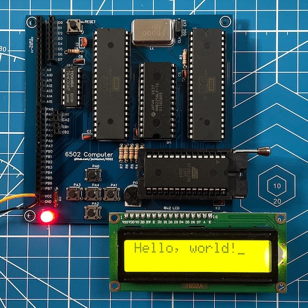

I wanted to learn a little about the fabrication side, since it seemed achievable at a low price point. I poured over tutorials and read PCB design reviews. I transcribed Eater's computer schematic to Easy EDA and designed a dual layer PCB for it. I was a little intimidated with manual routing, so my approach was to manually route VCC and then move the components around until it was "easier" for the auto-router to work (judging mostly by via count). I figured at 1MHz and 100x100mm, a poorly designed board would probably still work. I had the board fabricated at JLCPCB, for less than $7 USD shipped! My poorly designed board actually worked, as I just powered it up tonight to see it run a hello world program. I’ve just been continually amazed the whole time throughout this process.
I'm at the point now, where I'd like to proceed further, so here I am. Breadboards are more my speed, but I'm ready to dive in deeper. Not really sure where I'm going next, but I'm excited.
File comment: my poorly designed pcb. intention was to make a "permanent" version of Eater's computer I could build on.

Looks very good!
and, well, if you want a challenge - get a keyboard hooked up and make EhBASIC work on it ;-)

We have an old saying around here: You can get away with murder at 1 MHz. After a while, manual routing won't be all that difficult for you and you'll likely prefer it over auto. We've got builders around here with manually-routed PCBs whose contraptions are running at or beyond 20 MHz.
There is a sticky topic devoted to high-speed construction techniques you may find of interest. It should give you some food for thought on building a unit that can run at double-digit speeds.
