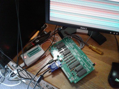

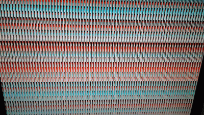

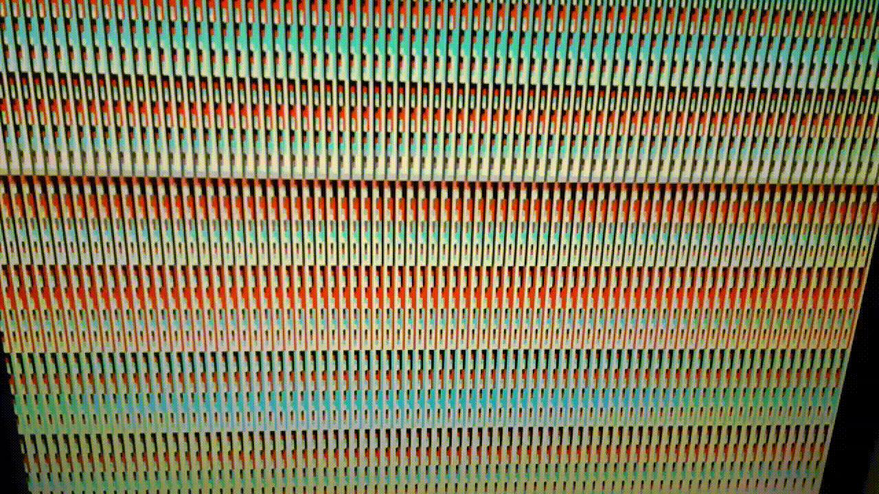

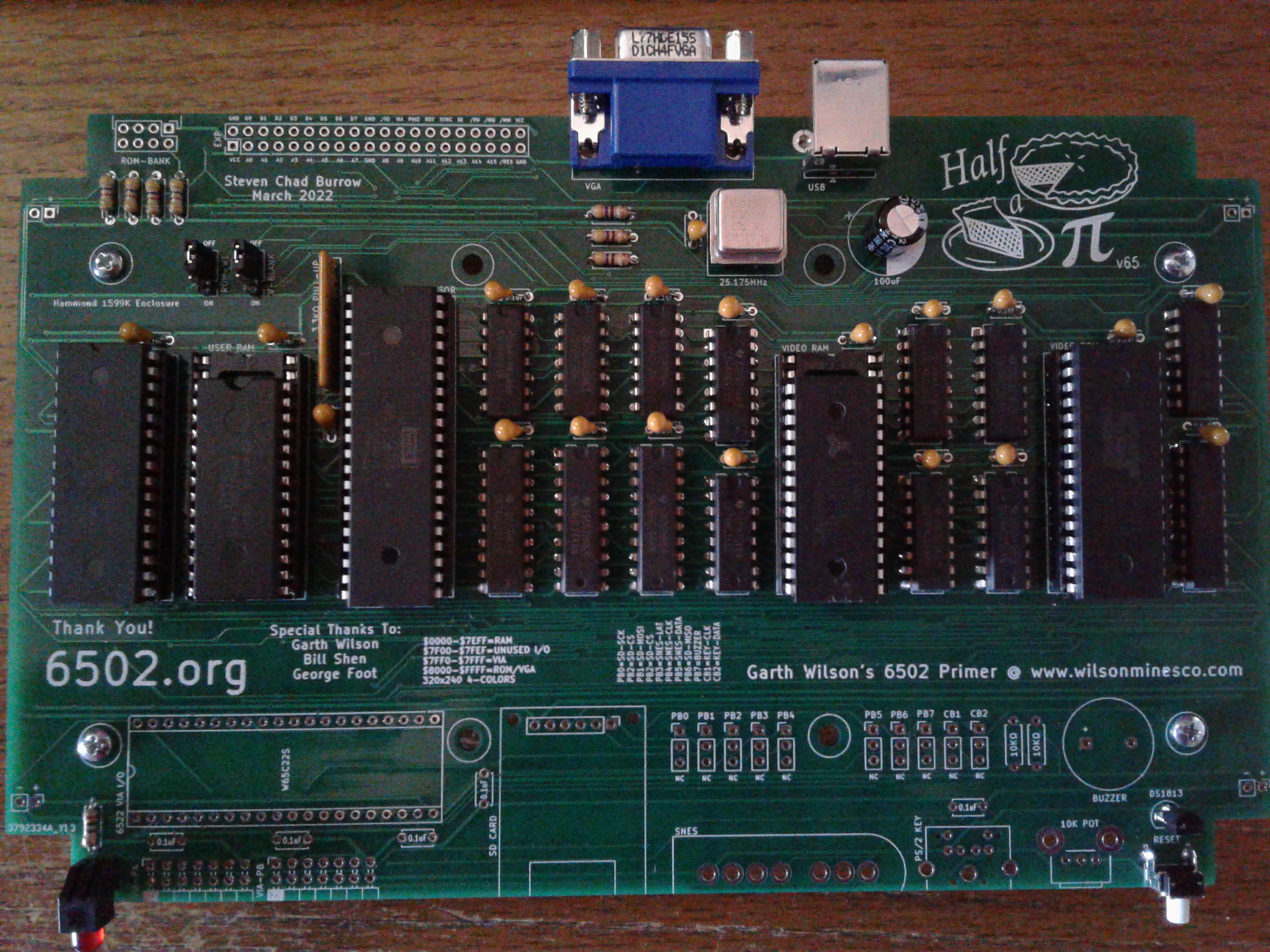

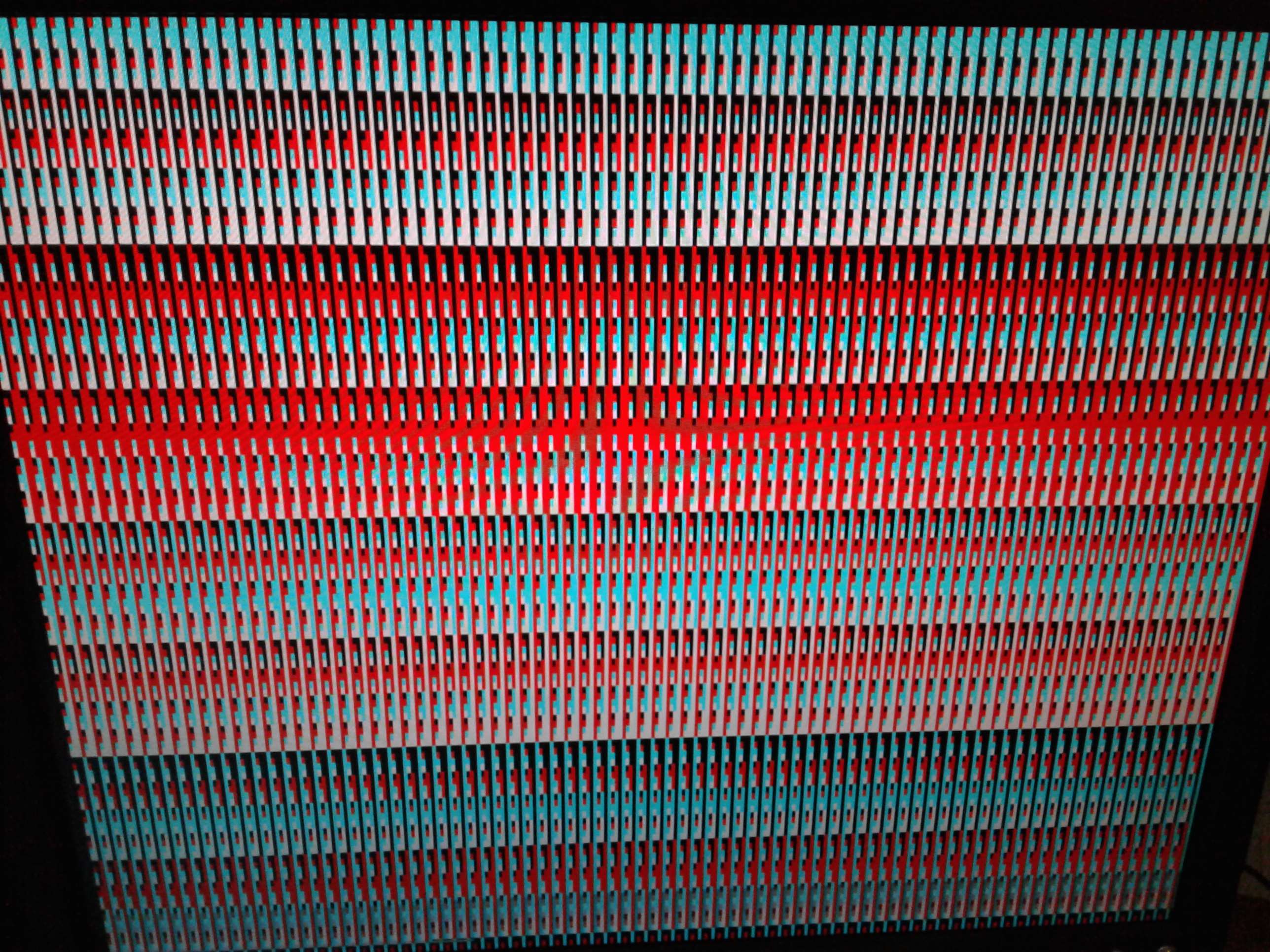

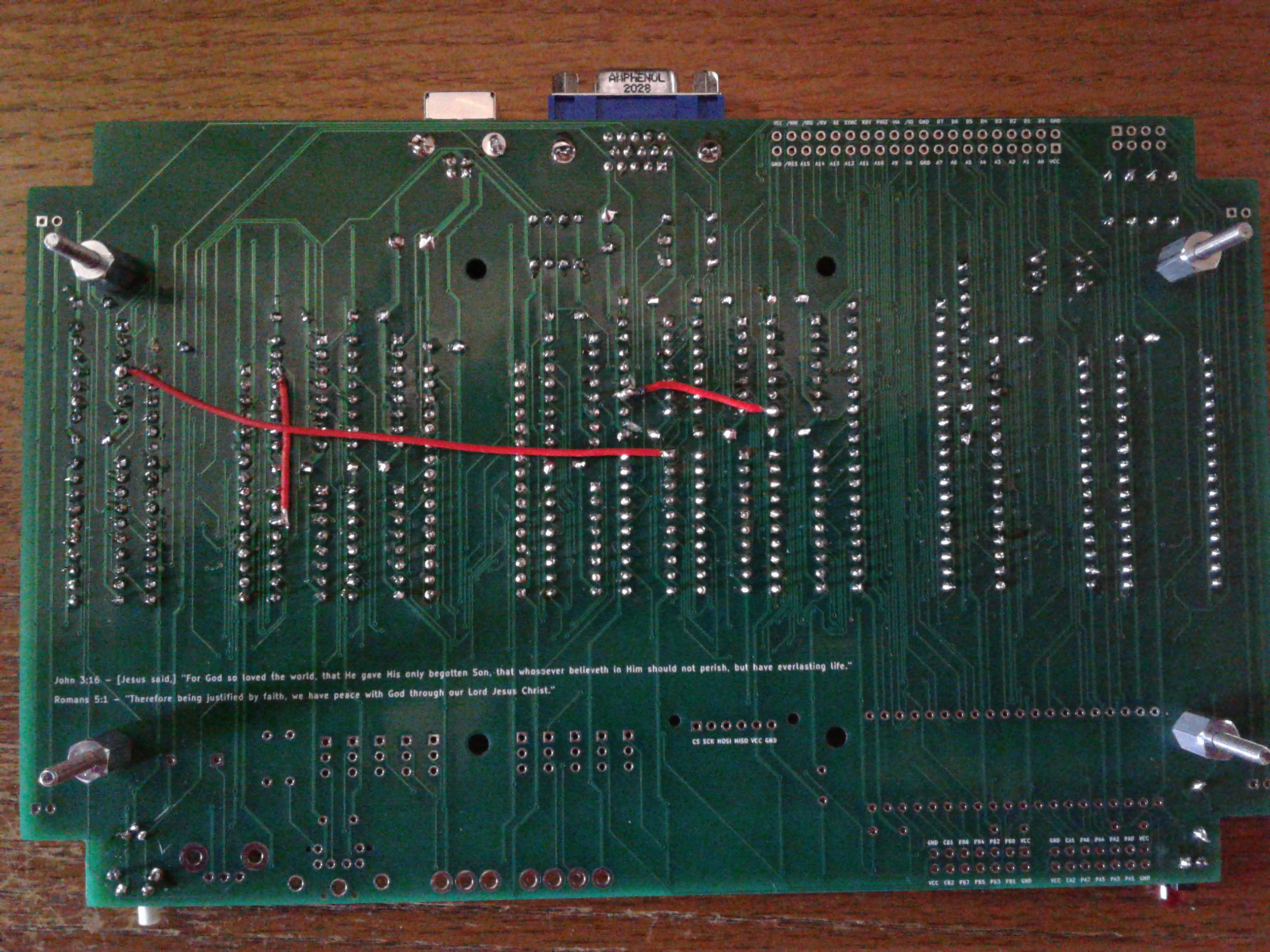

Hello everyone!
It works!!!
Attached is just about every file I can think of. Schematics, assembly, pictures, and video.
320 x 240 x 4 colors (black, white, red, and cyan). 6502 is running at 3.14 MHz. 32K RAM, 32K ROM (banking possible), and 32K Video RAM shadowing the ROM.
As you can see, I had to do 'surgery' to it. In one place I was missing a connection entirely, and another was inverting something that should not have been inverted.
The oscilloscope was VITAL to this operation. Without it I would have been completely in the dark. And the EEPROM programmer made things efficient and fast. Oh, and these non-circular sockets are *crucial* to popping them in and out so often!
When I get cooler demos I'll show them, but for now, this is good enough.
So much learning in this project. Thank you, everyone, for your help, support, time, and patience with me.
