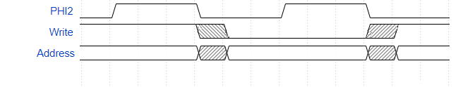

I think you might miss part of hoglet's point there...
The trailing edge of Write, which is caused by Phi2's falling edge, and lags it by an indeterminate amount, is a grey area. As it coincides with the grey area of the address bus, there's a double unknown: you don't know if you're writing, and you don't know where to.
On paper and whiteboards, I like sometimes to put a wibbly arrow from the edge which causes something to the event which it causes. It's more difficult to do this in a graphic. But I find it really helps to show why things happen in the order that they do happen. Failing the wibbly arrow, it can help to shift things slightly: things caused by something can be shown as happening very slightly later.
So, that's a couple of suggestions for an improvement to a diagram which is already a useful diagram: thanks for drawing and sharing!
Posts: 3525
Re: 'Qualifying' write operations
Indeed -- like this:

BillO wrote:
Jeff, what do you use to create your timing diagrams?
I don't know how J64C created the diagram. Could've been WaveDrom, as hoglet suggested. I merely edited the bitmap that was already there, using Paint Shop Pro (which is equivalent to PhotoShop).
