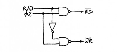

Hi Guys,
I keep seeing posts about making sure that write operations are 'qualified' against PHI2. With examples of how to do so, like below.
Is this a 'do in all circumstances' thing or are there just certain situations where this should be done. Because when I monitor the write operation on the scope, it seems that the write terminates at the same time PHI2 goes low, which seems valid (to my uninitiated mind) to me.

PostPosted: Tue Jul 13, 2021 5:54 am
Posts: 8428
This is from about 70% of the way down the 6502 primer's address-decoding page:
    You must have a way to make sure RAM cannot be written when Φ2 is low! [...] Looking at the 6502's timing diagrams in the data sheet, you will see that the address lines are not guaranteed to be valid and stable before the R/W goes low; so it is possible to write to unintended addresses. With an extremely simple program that you might use to see if the computer is working at all, the other addresses it writes to might not be ones you're using yet; but soon they will be, and you'll start writing garbage over your variables, or your stack space, or even your program, when you still need those areas to remain intact. The result will likely be a crash.
To further clarify: The problem is not at the end of the write cycle, but at the beginning. The address seen by the RAM may not be correct yet and with enough setup time when the R/W line goes down. It may also be very hard to figure it out, because the data are not out yet, and even if they were, the glitch may only be long enough to corrupt something and not long enough to get a full write to the wrong address.

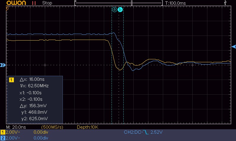

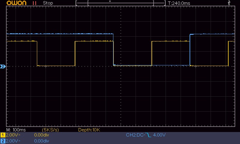

PostPosted: Tue Jul 13, 2021 6:21 am
Posts: 137
I see what you mean, the write pin gets enabled immediately on the clock going low. Which is not too healthy if addresses aren't stable yet.
PostPosted: Tue Jul 13, 2021 6:29 am
Posts: 8428
Thanks for the picture. It's even more extreme than I thought. [Edit: I should have looked at the sweep speed. I was forgetting you were at only a Hz or two.] Also, it will take a little time for the effective address to propagate through the initial row and column logic in a RAM. Whether or not that gets through before the R/W logic propagates through, becomes a race condition, I suppose. We are not told what goes on inside it.

Probably looks exaggerated in that pic as it’s only clocked at 1Hz there.
I’ve had to step out from home for a few hours, but before I left I did a test at 1.5MHz and the write signal trailed the down going PHI2 signal by 16nS.
A quick look at the data sheet says that the address setup time at that clock speed could take as long as 150nS. So that leaves a hell of a lot of room for data corruption on the RAM. I can see now why qualifying the write signal is so important.

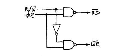

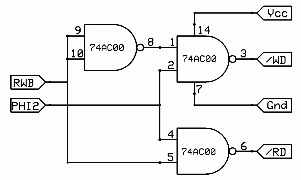

BTW, here is the read/write qualification circuit I have used in my POC V1 series, which are all discrete logic.
The entire circuit can be realized with a single 74xx00 NAND, with one gate left over for some other purpose. 74HC logic in that circuit is reliable to 12 MHz. Beyond that, 74AC or 74AHC produces more timing headroom. My POC V1.2 unit, which is all 74AC logic, easily managed 20 MHz with that read/write logic—access to I/O and ROM had to be wait-stated at that speed.
Although it doesn't look like it, there is only one gate delay in asserting /WD. RWB will be low well before the rise of Ø2, which means the output of the gate used as an inverter will go true right away. When Ø2 goes high its effect will be on the second gate, which means /WD will go true one gate delay after Ø2 goes high. With 74AC logic, that delay averages around 6ns.
The key takeaway is your decoding logic should generate an appropriate chip select as soon as possible after the fall of the clock, but access to the selected device (meaning read or write) should not occur until after the rise of the clock. The only caveat is that does not apply to 65xx peripherals, such as the 65C22. They are driven by Ø2 and "understand" the 65C02 bus cycle. All control inputs to 65xx peripherals must be valid before the rise of the clock.

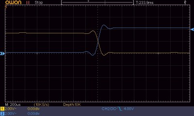

PostPosted: Tue Jul 13, 2021 9:04 am
Posts: 137
Back home now. Here's the relationship between PHI2 and the Write signal (at 1.5 MHz and 5V supply on the W65C02), for those that might be interested. :D
Ignore the bounciness as it was a quick test with a long wire feeding the clock. Not lab conditions by any stretch. :lol:

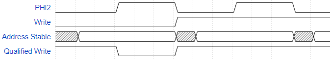

Added a quick visual representation, for anyone's benefit (probably more so my own :lol: ) as to what the qualified write looks like compared to the normal write.
PostPosted: Wed Jul 14, 2021 2:06 pm
Posts: 337
To be completely accurate, I think the unqualified write signal should also have the same gray transition period as the address bus.
