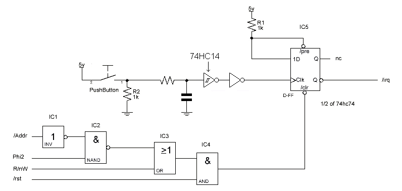

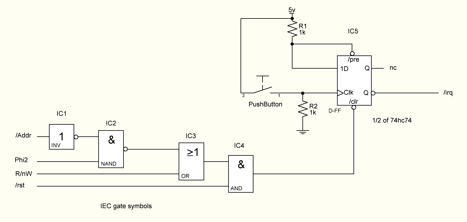

Hi all
I've designed a circuit to allow an interrupt to be generated (via a latch) by pressing a push button
and then the /IRQ signal is cleared by writing to a particular address. (the 'clear interrupt pin address' if you like)
I'd welcome any comments as I would like to add it to a 6502 single board computer which I made.
Attached is a schematic and a description follows:
I've put active low signals prefixed with a slash e.g. /IRQ for the active low interrupt request.
Starting with IC5, this is a D-latch which latches the /IRQ after the push button is pressed. (R1 is just to have a pull-up rather than
directly tying signals to 5v)
The D input is permanently high as is the /preset input. The /preset input is permanently inactive (unused).
The AND gate IC4 ensures that IC5's Q output is LOW and therefore /Q is HIGH (i.e the latch is reset when the 6502 is reset.)
Therefore the /IRQ output will be high (inactive) after 6502 is reset.
If the pushbutton is pressed, IC5 is clocked (maybe a few times due to bounce), and the latch is then set - the Q output goes HIGH.
Therefore the /Q output goes low and the /IRQ output connected to this output now goes low.
Assuming the 6502 is correctly programmed to handle the interrupt, the ISR fires and in this ISR the code will then
be programmed to write to the address which is decoded in the schematic (the 'clear interrupt pin address' indicated by /Addr)
This asserts /Addr in the schematic, thus causing the input to inverter IC1 to go LOW.
When Phi2 goes HIGH, IC2 output will go LOW.
With the R/W signal LOW (i.e. write cycle) IC3 output will now go low, resetting the latch IC5, the the (IRQ) is not HIGH (deasserted).
when Phi2 goes LOW and the end of the cycle, IC3 output goes HIGH and IC4 output goes HIGH, so a pulse was generated to clear the latch (IC5)
and deasserting the /IRQ
Data for this write operation is ignored.
Some debounce may be needed - perhaps with a delay
Comments welcome
Regards
Russell
Debouncing is always necessary for pushbuttons. If you want the interrupt, how about using a 6522 VIA's CA1, CA2, CB1, or CB2 as an interrupt-on-change input? You could run it to another I/O pin also so you can read the level (not just the edge) and see when it's ok to re-enable the interrupt. Assuming you have one or more VIAs available anyway, this would let you accomplish the purpose with no additional hardware, and you can do the debouncing in software.

Posts: 11464
Re: Interrupt generation circuit - Comments invited
(On the topic of debouncing, I'm fairly sure there's no need to introduce a delay. The crucial observation is that the first closing of the switch (after some period of being open) is definitive, and can be acted on. But by the same token, the first opening of the switch can't be registered until it has been closed for some short while.)
Posts: 3526

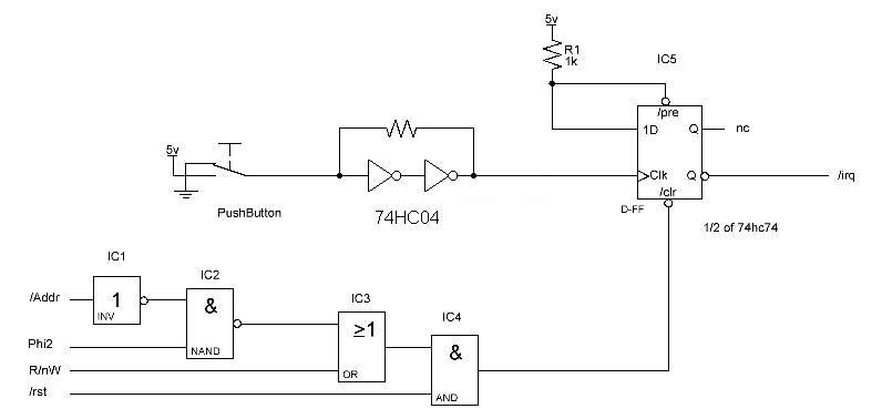

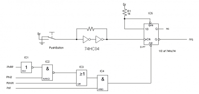

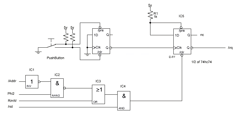

Russell, I think your approach is sound except for the lack of debouncing. I've edited your diagram to show some remedies. Version (a) relies on a RC delay followed by a Schmitt trigger (to produce a distinct transition) then another inverter. The second inverter could be omitted if the pushbutton pulled to ground and R2 pulled to +5 instead of the other way around.
Versions (b) and (c) take another approach. No Schmitt is required and no delay is introduced, but the first "bounce" of the button is the only one that matters; those that follow have no effect. These versions requires a SPDT pushbutton (not SPST).
R1 is just to have a pull-up rather than directly tying signals to 5v
Not sure why you've included this. I guess maybe a resistor used to be recommended for older TTL logic families but tying directly to +5 is perfectly alright with modern HC and other CMOS families. The only other reason to have a resistor there is to make it easy to pull /PRE low for test/debug purposes.
